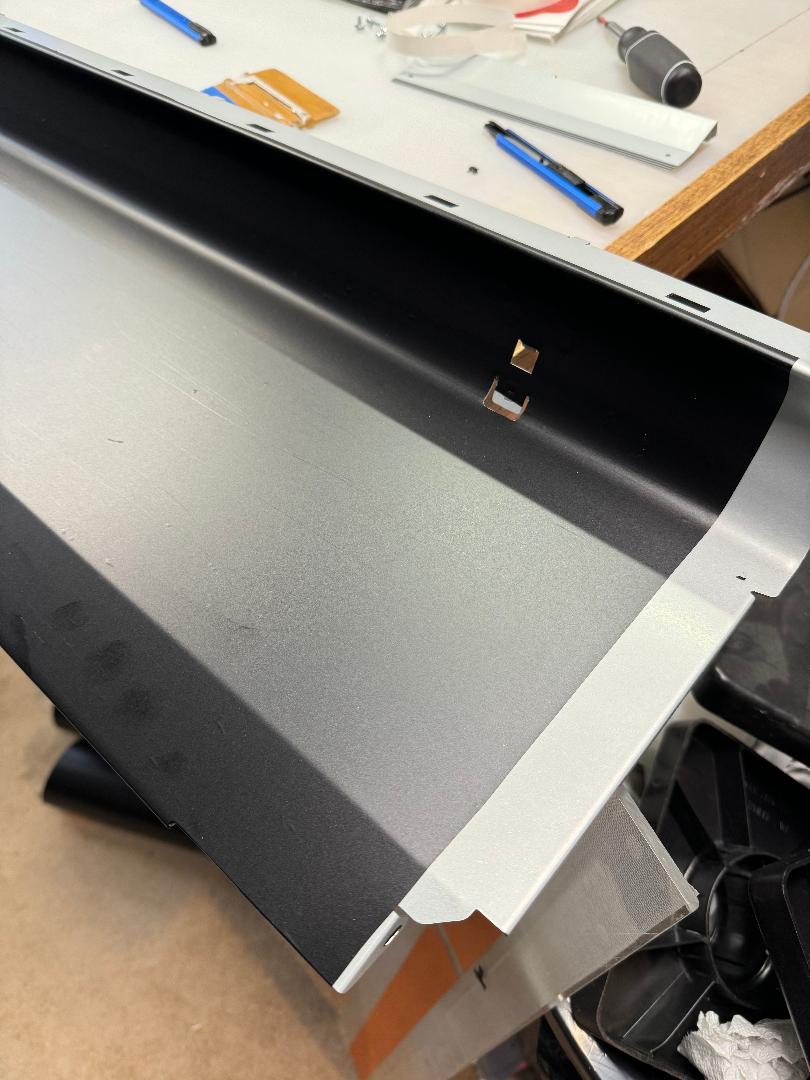

Hey guys, my 630w is still driving me nuts with the inconsistency while printing on the substance chrome. I know the backing paper is a bit slick, I did get a profile that was made by the HP guru in spain for 700 users device (at the cost of a roll of vinyl and shipping to spain). but it is still getting stuck on that back plenum. I have rigged up a grounding for the rear plenum and the roll and have adjusted humidity in the shop to 40-50% ( I noticed more issues below 30 and above 70). I have heard of people using an anti static tape or painters tape on that back plenum but I was waiting for a long term update and to see how hard that plenum is to pull. I have had that issue with a few other non metallic films as well but I had a great experience on my 315 with the substance material and have more customers but just can't get a consistent result right now.
Joel golden
ok, so I took some advice from Substance and took the plenum out and went to cover it in painters tape to prevent the static. But, my roll of painters tape only had about 14" on it so I grabbed some matte black oracal 651 and wrapped 36" of it (I only use 30" chrome), then ceramic coated it. just ran 6 jobs at almost 30 ft, no issues. Hopefully this is good long term, that chrome and their holographic is amazing stuff.
