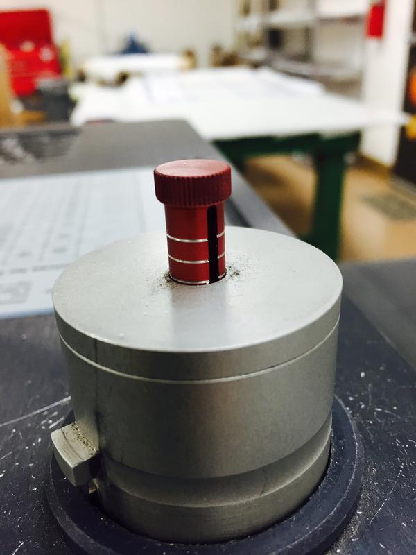

The problem is the area around the conveyor seem has a glue buildup. This is normal. The way around it is to you adjust the kiss cutting tool. What spring insert are you using and what depth is it set to on the tool itself?
We have found on both our cutters that if you are using the red spring insert (works best for self adhesive vinyl IMHO) you want three lines showing on the adjustment knob. See pic.

I meant to say what pressure setting do you have it set to, not depth. The adjustment knob on the KCT adjust for pressure not depth. Sorry.
