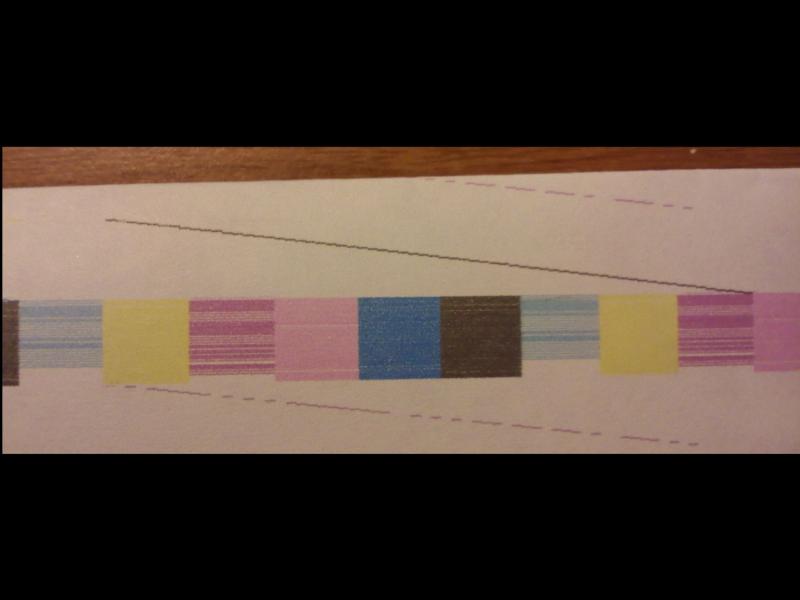

I have a falcon outdoor 46.
The greys started becoming more pink all of the sudden, now this is what i am getting from a nozzle test. I have cleaned it many of times, do i need new print heads or is there something else that can be done?
thanks for the help it is greatly appreciated...
Not sure about your machine, but have you tried some heavy strength or power clean modes ??
R08
Head soak.
I've actually modified my machine so I can actually open the sucker up in about 1 second and stick a thinner soaked clean cloth under the head, I do that at least once a day and it keeps the heads in great shape.
