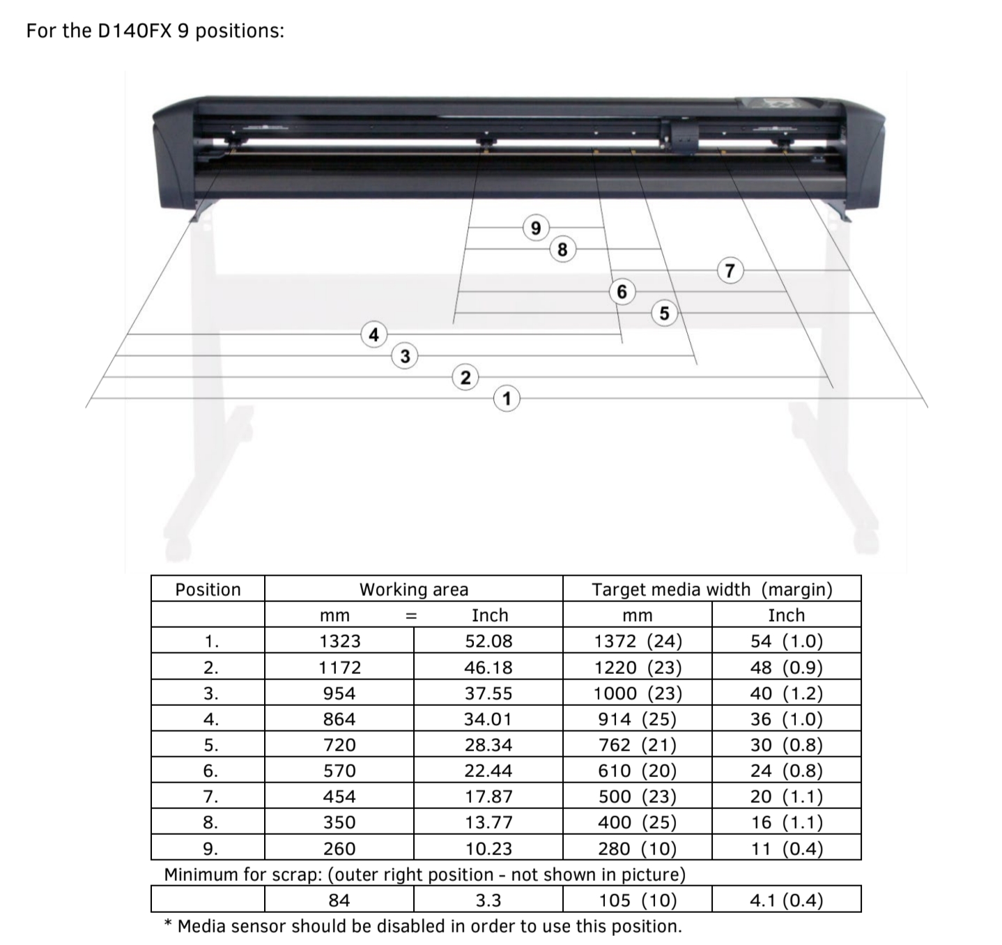

Rollers has fixed points and none of them fits 1040mm or 1240mm or 1370mm rolls, i always have to set "load extend"... i mean... width of materials is the same for ages. why are those fix points so stupid aranged?

Usually you set the margins in your cutting software. Origin is where you set it after loading and everything else comes from the software.
What to say about the rollers... you knew what you bought.

I would agree with Frank that an S1D140 would have served you much better than the S1D140FX. The S1D140 can cut a wider range of media(the pinch rollers aren't set in fixed positions like the FX) and will allow you to manually assign your origin. Simply put, you bought the wrong cutter model if you were looking for an "upgrade" from the Kona. If you have the option to swap it out for the non-FX version(S1D140), I think you will be much happier with your experience with Summa. If you want a significant upgrade from what you're used to, the S3 models have all the bells and whistles like tangential cutting(motor-controlled blade), dual servo motor drive system, additional force and speed, etc.
Directly from the brochure for the S1D140FX - "The S1 D140SX model has fixed pinch roller positions, meaning any media size can be loaded but margins cannot be minimized. It is the ideal model for customers with a low workload where the direct cut method is not a focus"

Anyway i will get used to it. we have been together for over a month now and i have learn that i just had press more buttons to get some functions, like extended width of material or manually assign origin.
