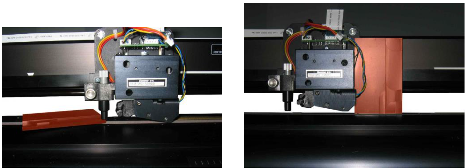

When the cutting depth does vary, then check the following:
• Knife holder incorrect in tool clamp: the knife holder has to be put as low as possible in the tool clamp.
• The floor may not be level. Because of this there may be torsion on the machine causing cutting depth to change over the width of the machine.
• Resharpened or non Summa branded knife is used: try a new Summa branded knife.
• Worn knife: replace the knife.
• Coil windings in the cutter head may have come loose. Replace the cutter head.
• Cutter head mounted too high or not perpendicular: check height and perpendicularity with adjustment tool.
• Uneven height of the cutting strip. Due to this, the knife may jump over the bump when the knife has to cut over the width of the media. Remove cutting strip, clean gap for cutting strip, stick new cutting strip.
• The bearings in the cutter head may be worn: replace the cutter head.
• FlexCut has been activated: Deactivate this option.
