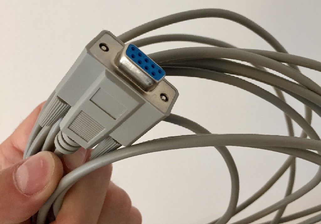

This is my cable (attached), as I said it's an ordinary grey serial cable but I'm starting to think the adapter is the problem.
The guys from Summa Support responded today as well, did all that, no joy.

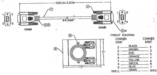

"Hi,
In case the computer does not have a serial port you can try with a serial/USB adaptor. However, Some adaptors don't work because their signal level is too low and not compatible with an older machine as a D750. Do not forget to install the driver of the adaptor and keep in mind the cutter is still connected serial
(software settings).
Make sure you are using the correct (original) serial cable. Below you find a draw how the wires should be connected in the cable.
The strange thing is the cutter cut the small OPOS test with Summa cutter control.
I recommend you to compare the RS232 serial settings of Summa cutter control with the values of Winplot. Use in Winplot the same parameters.
If this does not solve the problem change the baudrate to the lowest value (in Winplot, Summa cutter control and the cutter menu)
Do not use Summa cutter control and Winplot at the same time.
Close Summa cutter control when you use Winplot)
As cutter model, you can select“ Summa Legacy”

Do you possibly still have the drawing of "how the wires should be connected in the cable" that you could provide me with. If so I would be eternally grateful... at the least...
