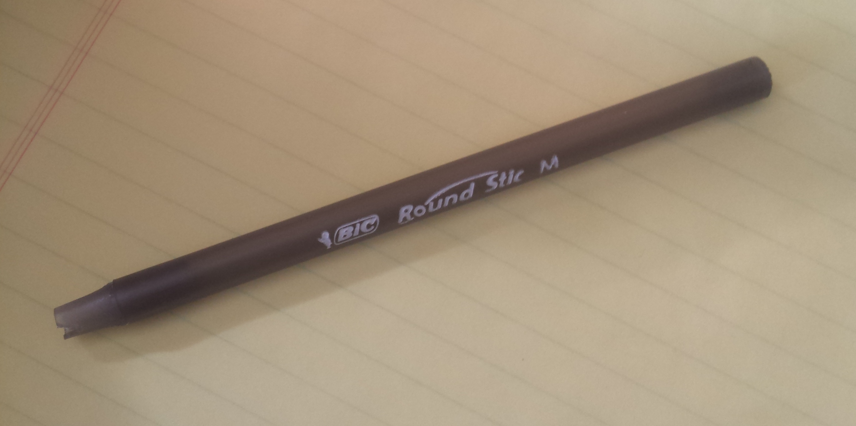

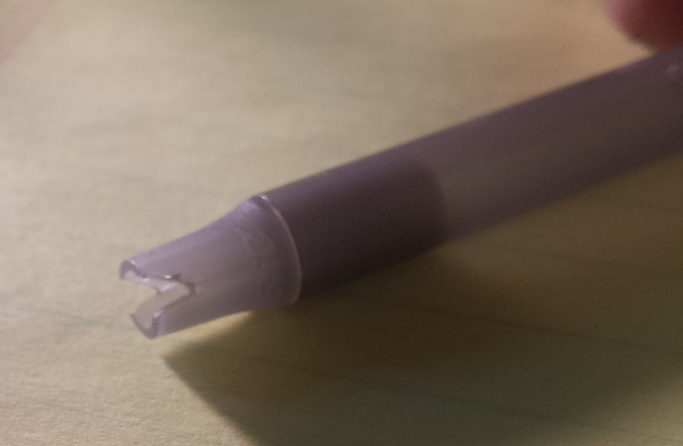

Not sure how large your sprocket pins are, but I have a Gerber GS with similar problems.
I use a Bic Round Stic stick pen with the ink cartridge removed. Use a razor blade to create a small notch in the end. Place the pen over each sprocket pin, gently rotate the pen. The gunk will get caught in the notch.
If the inside diameter of the pen is too large, find another that is suitable.
JB
