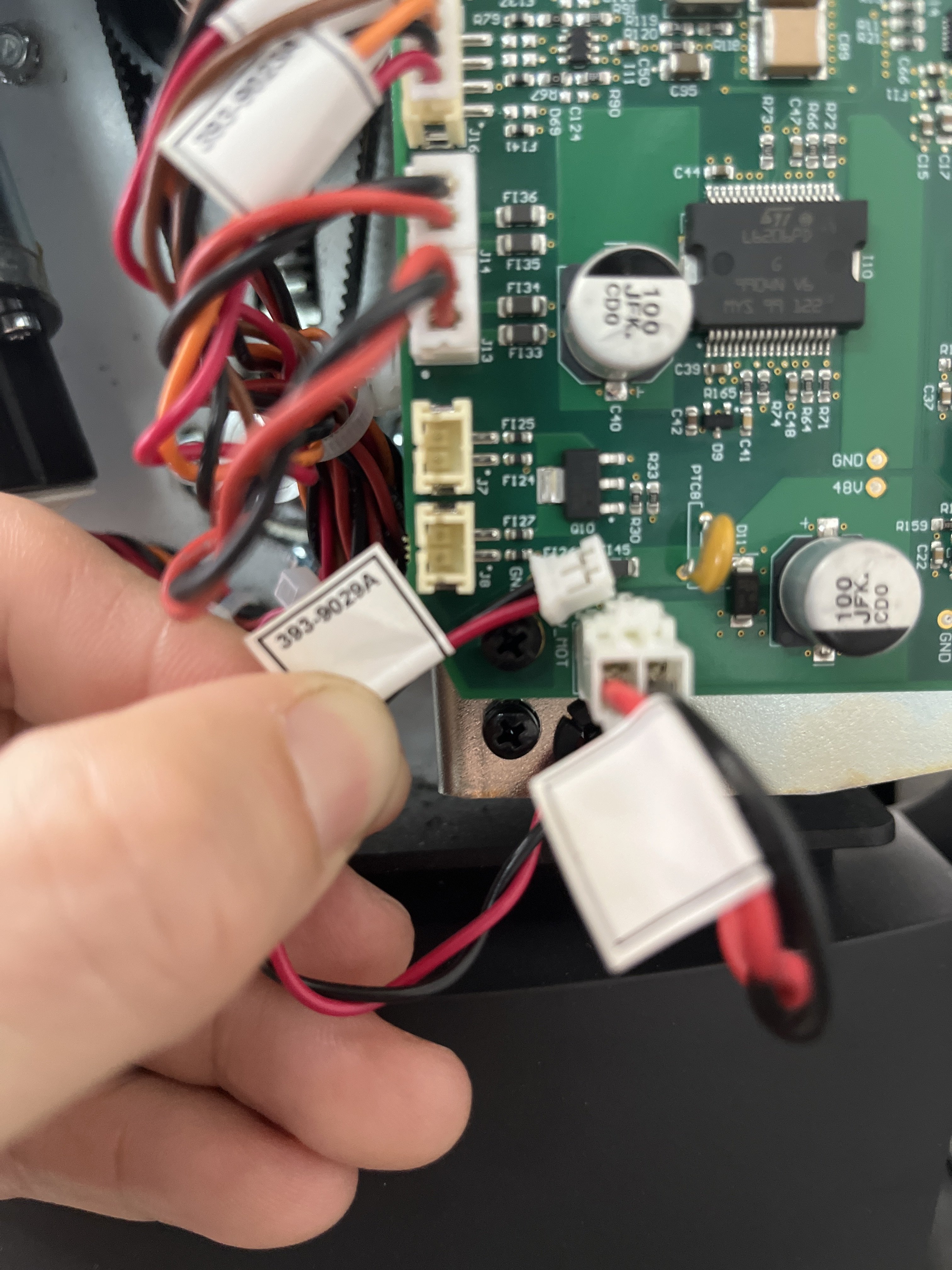

I am replacing a board one my Summa S One (rebranded HP Latex 64 Plus) and have one connection question.
Do I connect the lower left hand wording harness (393-9029A) to the F124-125 or F126-127 terminal?

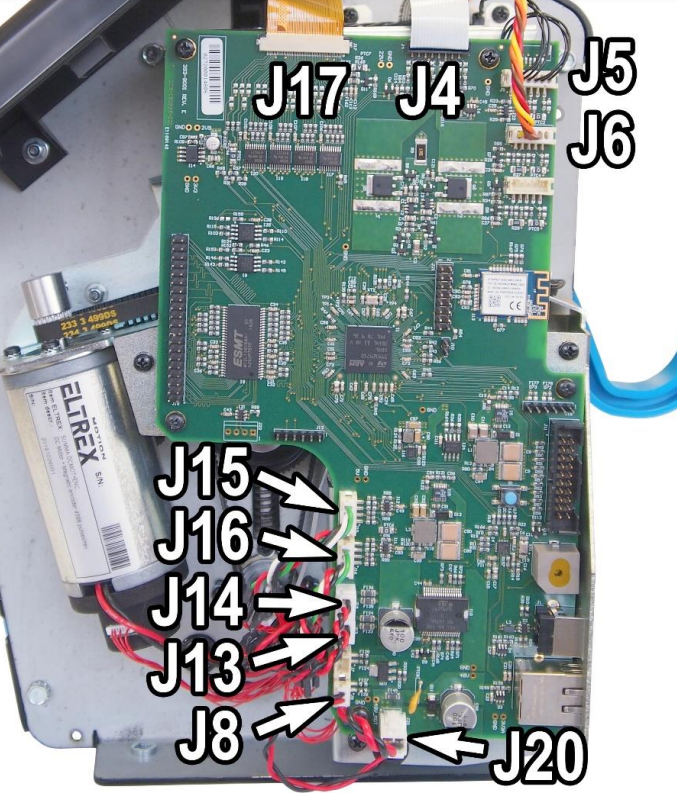

It looks like you need to plug it into the one labled J8 in the below image. That plug is for the Vacuum fan.
TWXReid
Thank you very much. That was all I needed.
