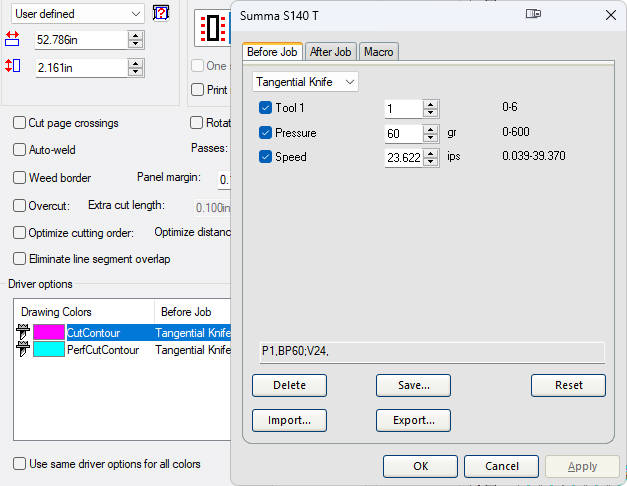

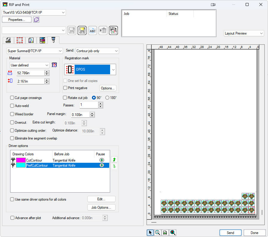

My workflow has me using Flexi regrettably and I am trying to figure out how to send perfcuts with longer lengths. It seems that it is taking forever to get through an inch of material. We have a small kiss cut and a perf cut - the perf cut is where its going wrong. Any ideas???

With Summa, it's Flexcut. You probably need to select a different tool number.

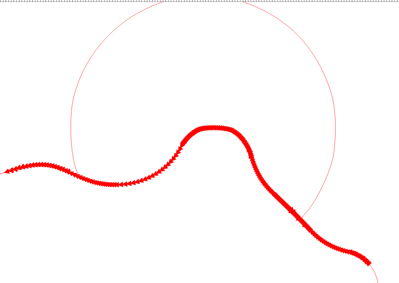

It weird - If I cut this file on my roland - it cuts just fine. But upon further inspection its the file that is being sent. It has a million tiny cuts on the pull tab of the sticker.
