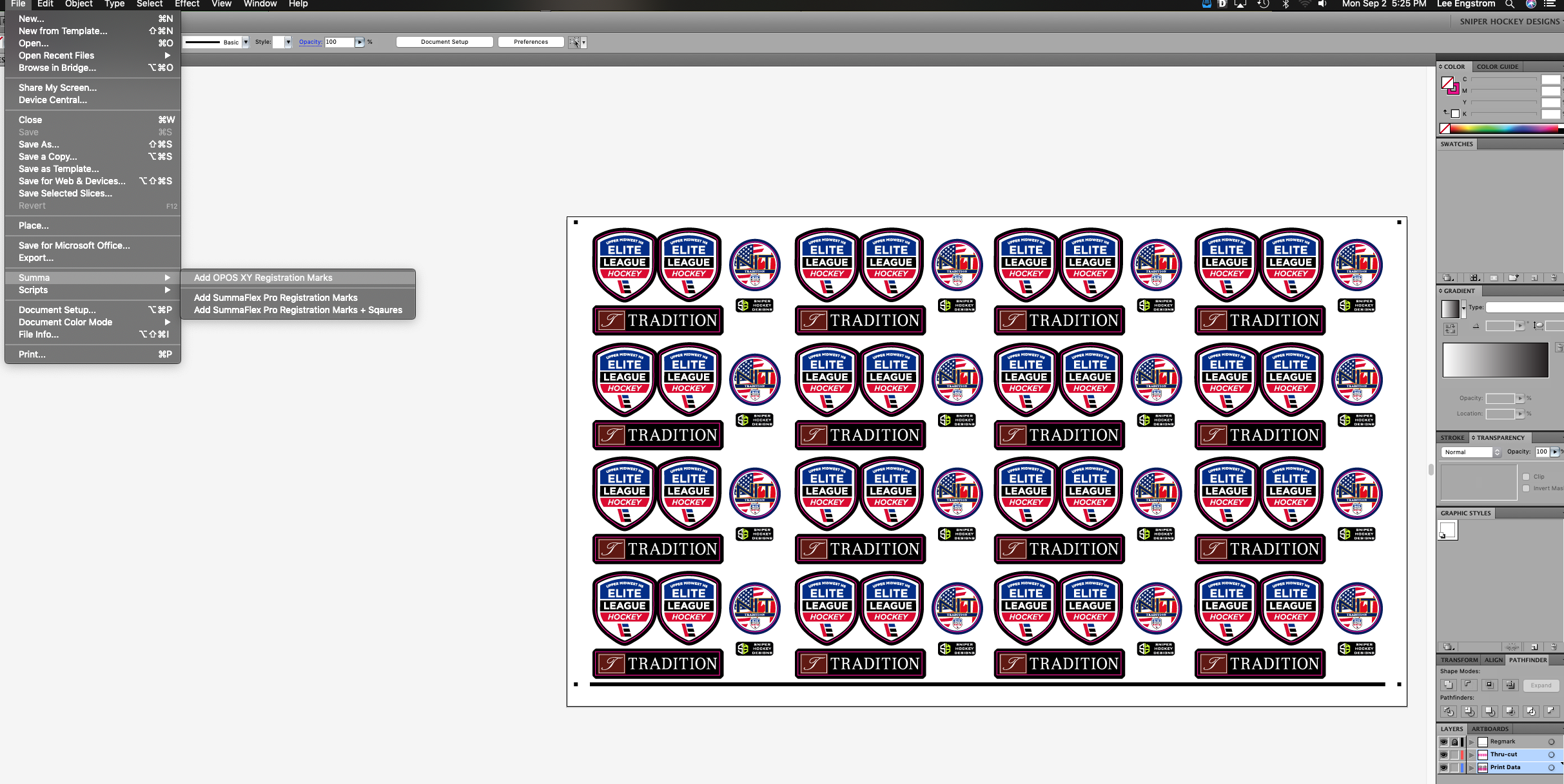

Thank you! Does the attached look correct? I clicked on the OPOS, it added the 4 Reg Marks and the bottom rectangle black bar. Layers - I have Print Data on the bottom, Thru-cut above that, then it added the Reg layers. I don't need a kiss-cut.
Save this file as a PDF? Print in VW on my roland, lam, then load to my new Summa S3, open GoSign on my Windows computer running the printer/cutter - and it should read those reg marks?

Got it - I did save it as a PDF - wanted to make sure my layers were correct because I know in VW the CutContour had to be above the design layer.
Looks like I have to use MacSign on my extra iMac to run the cutter - as my dedicated CPU for my Roland runs XP and Summa said they don’t have a GoSign for that OS.
