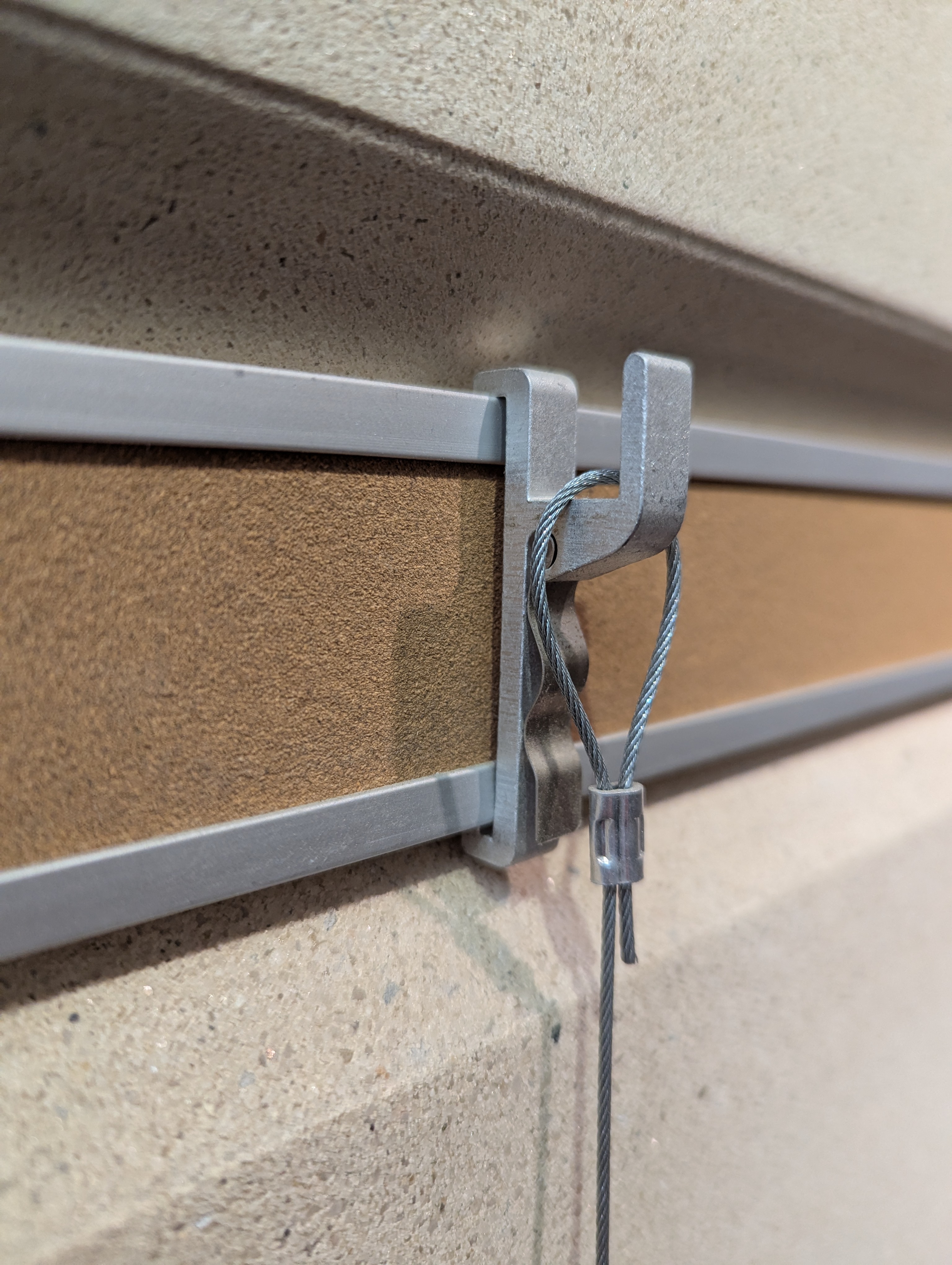

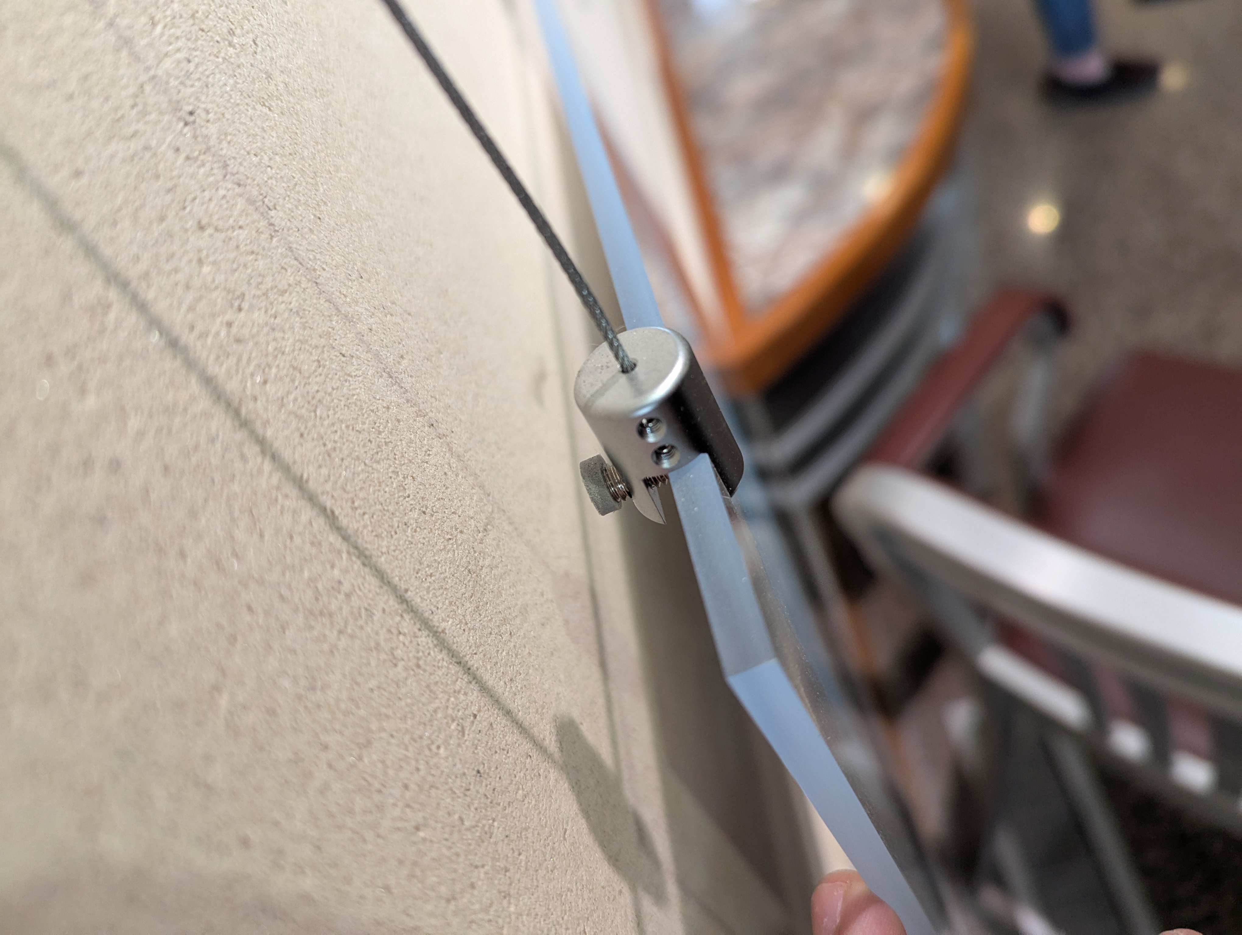

Does anyone recognize the components below? I'm looking for the hook being used and the gripper mount that has a little rubber foot on the back. A customer has a whole setup with these and they would like to add to it but don't know who made this originally or where the parts came from. I'm not finding either of these at MBS or Gyford standoffs.

Ah, this looks like it was installed backwards, the little rubber pad is meant to hold onto glass tight, not protect the wall.

try looking up "Map Rail Hooks" these are on the blackboards al over our school district - they come withe the blackboards/whiteboards and span over the small cork strip at the top....
for some reason it is not taking the screen capture, but the google search gave this exact one plus a few options.
