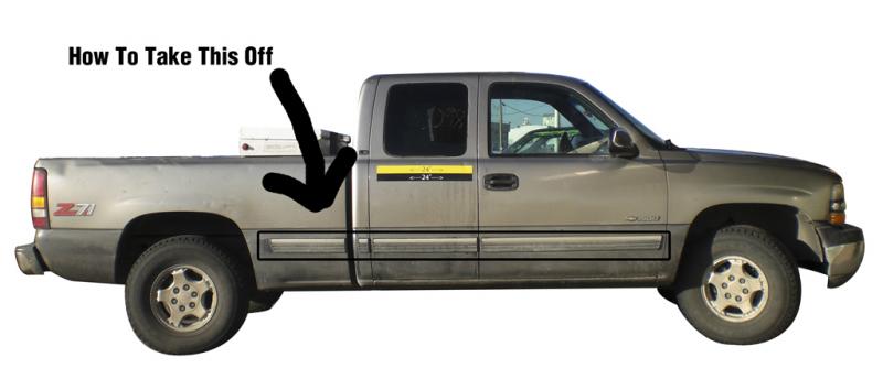

take off molding or leave it on?
Spencer McMurtry
i am doing a wrap on this pickup and am curious as to if i can take the molding off and put the graphics where the molding was. or if there will be some sort of obstacles beneath the molding if i try it take it off? also how do you take off the molding? please advise, should i just design around the molding?
Thank you!
vinylbarry
Most molding is 1 of 2 ways attached by the plastic push style snaps or by heavy duty double sided tape.
If you and the client wants it off, heavy duty fishing line used in a saw type motion does good if its the double sided tape if its the push in snap style there is body tools that help with them.

tanneji
We leave em on. Thats body shop work. You dont want to have any kind of leakage or something pop up and then client be able to blame you. (Even if totally unrelated it comes down to "They pulled parts off of my truck and now its leaking")

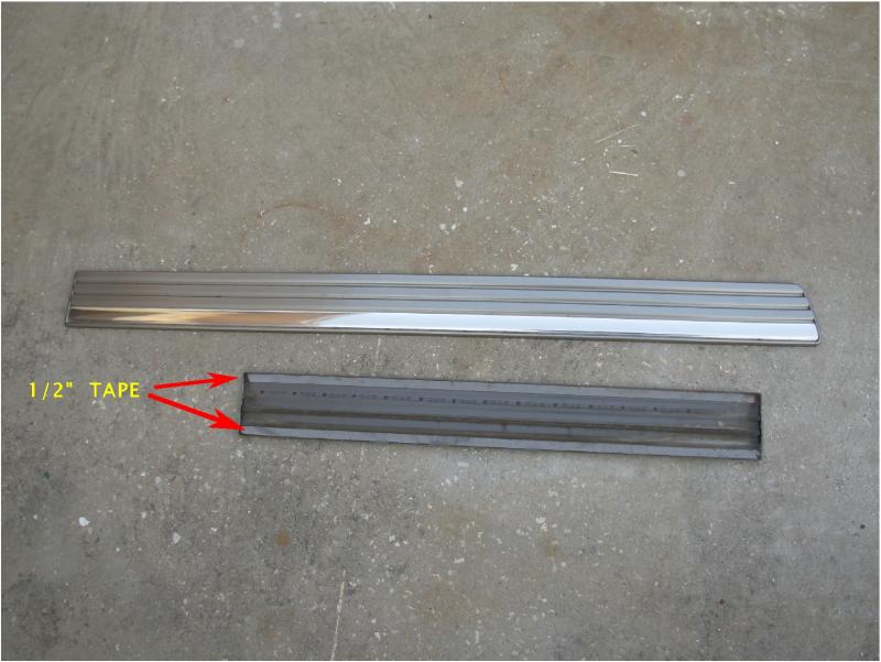

Bradster941
Just did this today on a Chevy truck.
They are held on with double sided tape.
Fishing line works, but takes a long time. It also can cut into the plastic molding.
I used a expandable razor. Pulled out on the molding as I cut the tape.
You will still have a layer of tape to remove.
I used a heat gun, got it (REAL) hot, and used a Little Chisel to remove the tape.
Followed up with a little Rapid Remover with long soak time and a cloth and water wipe down and it was a Done Deal.

grafixemporium
We leave it up to the customer and let them know how it will impact the design if we leave them on. The finished product will look much cleaner without it, so we usually try to talk them into removing them. On this particular truck those moldings are held on with adhesive. Fishing line is the way to go... but on older trucks it's a nightmare to get all the adhesive off no matter how you go about it. Try some citris based adhesive remover and a pressure washer to get the residue off... or you can wear your thumbs raw trying to get it off by hand.

kustomguy
I think it is best to get rid of the molding. It is an eye sore and a place for future vinyl failures to occur. I have removed hundreds of feet of body side molding and it is easy on these chevy trucks. Just warm it up either in the sun (if it is summer) or with a heat gun. Start it on an end and pull it off. No need for fishing lines or wire. That works great on emblems and such, but is not necessary on molding. As far as dealing with the left over tape gum if any is left behind, invest in a tool often referred to as a Crud Thug or eraser wheel. You will have that mess off of there in minutes. Most signs shops should have one in there tool chest anyway. Once you have one, you will wonder how you ever worked without it. You got to lose the molding though, in my opinion. Don't make a bigger deal out it than it is. Most vehicles today don't have locator pins or snap pins behind the molding, just 3M's famous double sided tape.
