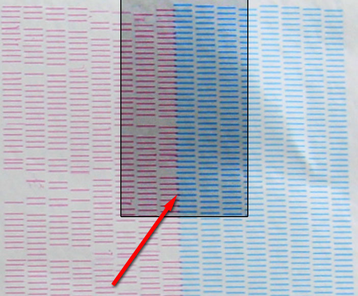

Back from a weekend trip and installed a fresh LC head this morning.
LM is next in order.
Tis my 3rd time doing head RnR, though need advice per the attached image.
The obvious, is the overlap of the freshly installed LC over the LM.
Haven't had this issue before and not sure what needs tweaking.
Took four Bi-Directional runs to get it pretty much where I needed it.
Though with regards to the overlap, is it a matter of loosening the head and repositioning it?
What am I missing here?
That said, ran a long boat print and it was flawless. Sharp and no banding.
This is common after installing a new head, before doing the head alignments in service mode. It is fixed when doing the 3rd step - horizontal. Also insure you positioned the print head as shown. Once all 4 alignment steps are done in service mode, your overlap should be gone.

So many missing nozzles in M or LM will definitely cause color deviations...
Since the overlap seems to be the same over the whole whith of the head, horizontal adjustment is needed. (Bias, or Slant would be needed if you have overlap or gap on top or bottom of the head only)
