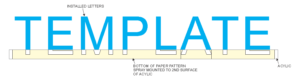

If you have a scrap piece of clear plastic, around 3/16" or thicker,
this is how I would do it, having the top edge of the plastic at the level of the install.

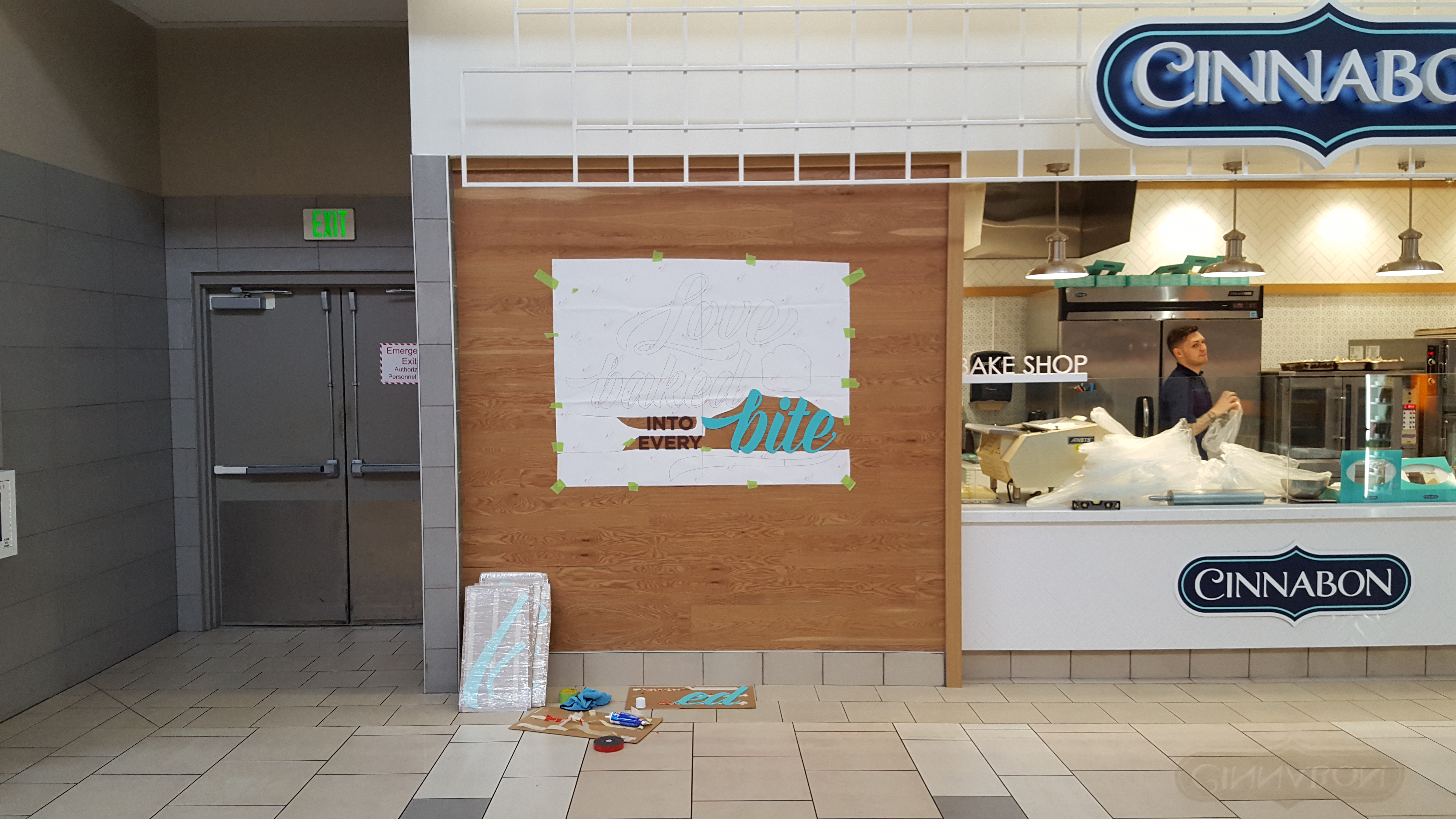

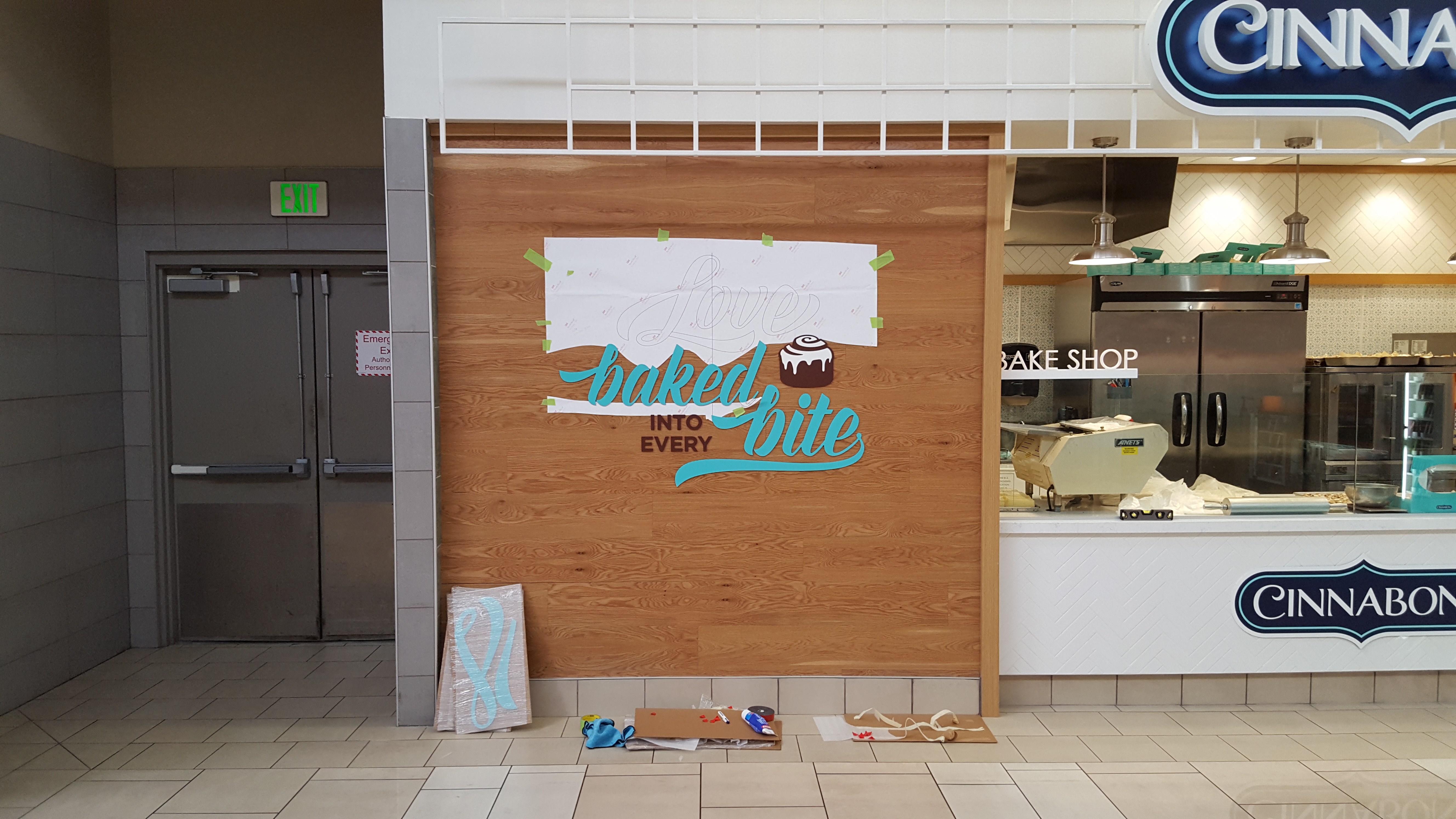

I deal with this all the time. We order stud mounted lettering and the condition on-site won't allow stud mounting. In that case, we tape up the templet and then cut away everything but the top and bottom edge of the letters. similar to what Andy showed. make sure the tape is far enough back so the tape won't make contact with the templet, add some Lexal and stick them down. Multiple lines, cut one line at a time to keep as much of the integrity of the template.
Below was before Lexal.
You don't have a templet so if you sent the art to Gemini, just pen plot one. If you used stock letters, you can download the fonts from Gemini and make a file and pen plot that. You can do the same thing with vinyl, but it's more work. I've never been a fan of sticking letters to a full vinyl template because the weight of the letter can pull the vinyl off a painted wall over time.
