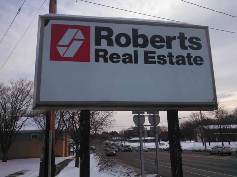

Looking for the best method of installing a 10'x5' coro sheet to a backlit sign. This is a temporary sign advertising office space, the backlit sign doesn't actually work as of now so no worries about the coro not being backlit. The existing sign panel is 3/16" polycarbonate. Was planning on grometting the coro around the perimeter and a few throughout the middle. I'm in upstate NY and it is cold, was planning on using self tappers and washers to hold the coro on, but am concerned that the polycarbonate might crack without a relief hole? Any thoughts or suggestions are greatly appreciated. Thanks,

I forgot to mention that this sign is pretty old and not working. Whoever made the sign originally bolted aluminum angle iron to the back of the poly faces. They did this because the extrusions didn't have a slot where the sign face should slide through, so the angle irons are keeping the sign face from slopping around in the trim/extrusions. But because of this the faces are cracked and broken in all 4 corners. So the faces will be replaced eventually, when they have tenants to put up on the sign. Also this sign was hit by something, probably a truck, and the extrusions holding in the sign face has a nice bend in it, and also bent the angle iron on the back of the sign. So we had the side extrusion off and couldn't get the face out, going to have to remove bottom extrusion... told customer that we would have to charge hourly gave an estimate and alos an estimate on screwing a banner or coro to the face... So hope this makes more sense now.
Without a picture, sounds like it might be easier and less expensive to replace it completely when someone wants to use it next.
Pic doesn't really show the damage well. On the bottom near the middle you can see the extrusion is bent. I held a straight edge to it and the bend is 2.25" deep.

Looks like your area to cover is about 30" x 120". Why not just take white vinyl up there and stick it over the copy there.... or just use a scrapper and pull the old sh!t off ?? You could reach that standing on the roof of your truck or a 10' step ladder.
Signed Out
The new sign is red background yellow text, full size 10'x5'. We originally were going to vinyl over the whole thing, but the back side of the sign is pretty uneven ground, shrubs, telephone pole, etc., not to mention the wind and cold this week, not really able to get ladders back there to do a full vinyl overlay. But we could manage to through in some screws and what not to do the coro, or the banner bag.
