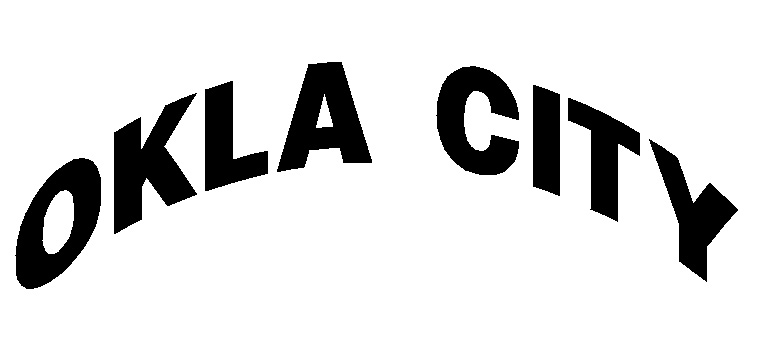

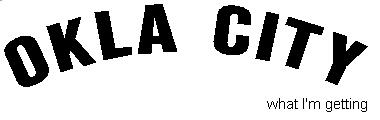

Hello! Apparently, I only post on here when I have issues with some kind of Arc. Anyway... I am trying to put text on an arc so that all the verticals of the text itself stay... well, vertical. (As in, not perpendicular to the arc). I know it looks a little funny, and the letters are going to get stretched out, but that's what I'm looking at doing. Here's a picture of what I'm trying to replicate, and what I'm getting. Can anyone help me? THANKS!!

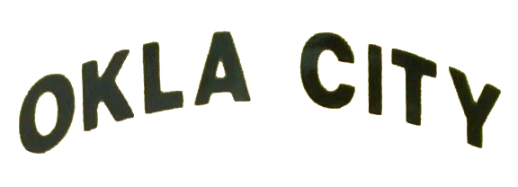

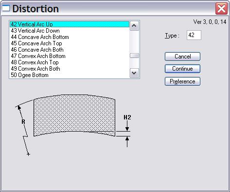

What you want is Distortion #42. Press Alt +2 to enter the distortion module.
