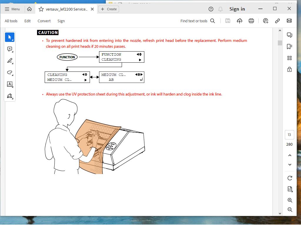

Just curious. I am reading / learning a lot about Printer Maintenance from this site and manuals in general, but little to nothing about using the infamous Roland sheet!
Who uses it? Is it a necessity or not? I understand about lighting and UV, but without this sheet, how can you see what you're doing without adequate (naked) lighting?
And, can one buy some sort of over-the-counter material to use instead of the Roland variety chunk-o-plastic?
$283.41! :eek:
Novadon
LEF2-200
Yikes! I'm retired Navy but not Seal Team 6 affiliated. :oops:
What are we looking at here? Where available? And what if one wears glasses to see?
