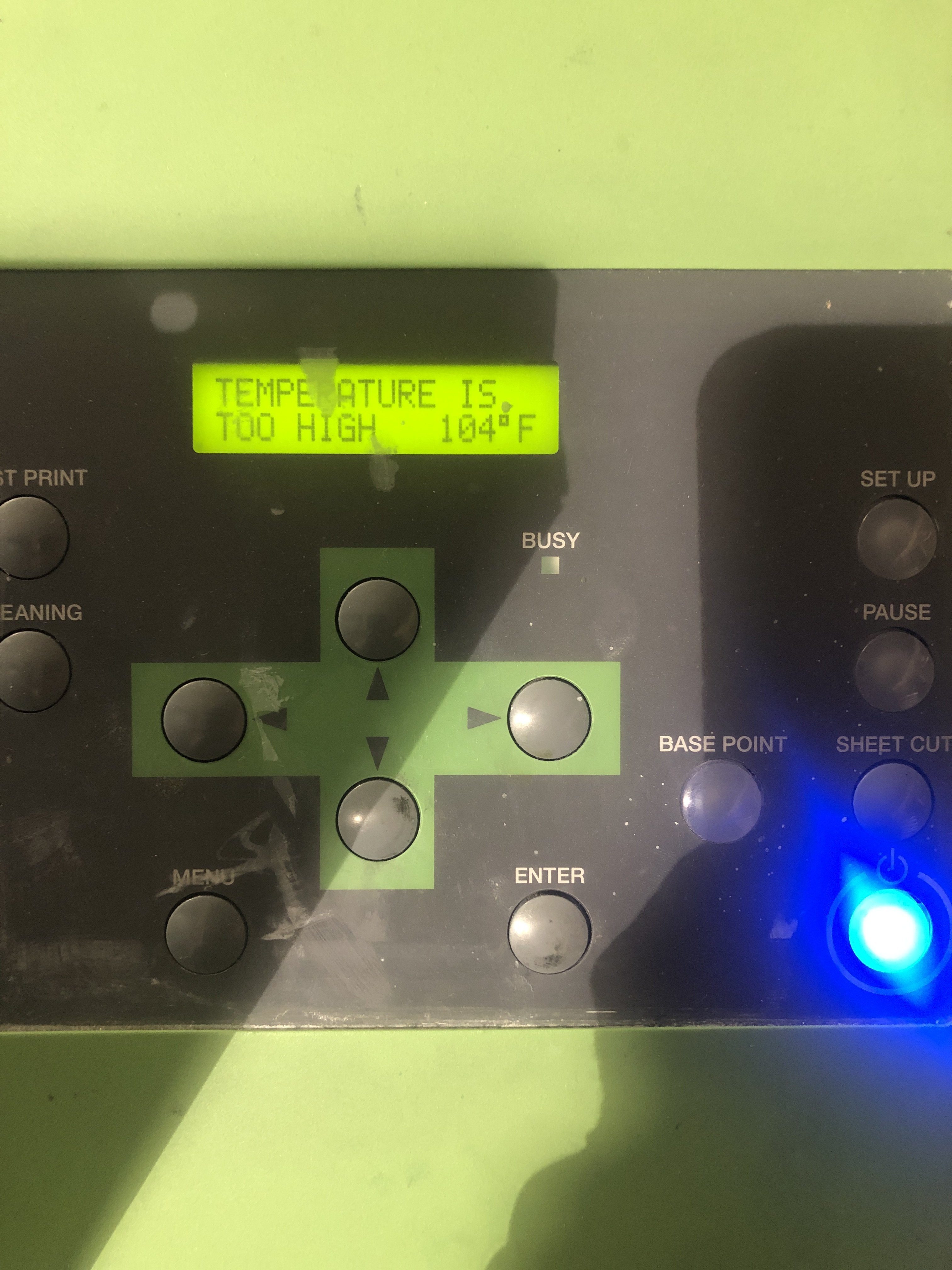

This is the first error I've got that isn't a service call, so it seems like this one should be easy to fix. The ambient temperature is room temp, so that's not the problem. Seems like a faulty thermistor or something so I'll try to locate that and check the connections. Got any ideas what the problem might be?
Lucid
I founds the ambient thermistor which is the one reporting the high temperature. It's located underneath the display panel and plugs into the "Motsens Junction Board". Currently the temperature says 104F, so I disconnected the thermistor from the motsens board and restarted the machine. The temperature was still 104F, so there is definitely a problem here. If the same value is being read with or without the sensor plugged in, then it's not working right. Now I'm not sure if it's the "Motsens Board" or the thermistor . I used a multimeter to check the resistance value of the thermistor and found it to be 12.46 kiloOhms. I'm not sure what it's supposed to be because I can't find a data sheet for this thermistor. However, other values for other thermistors I found on the internet were in this range, so it's possible the thermistor is good.

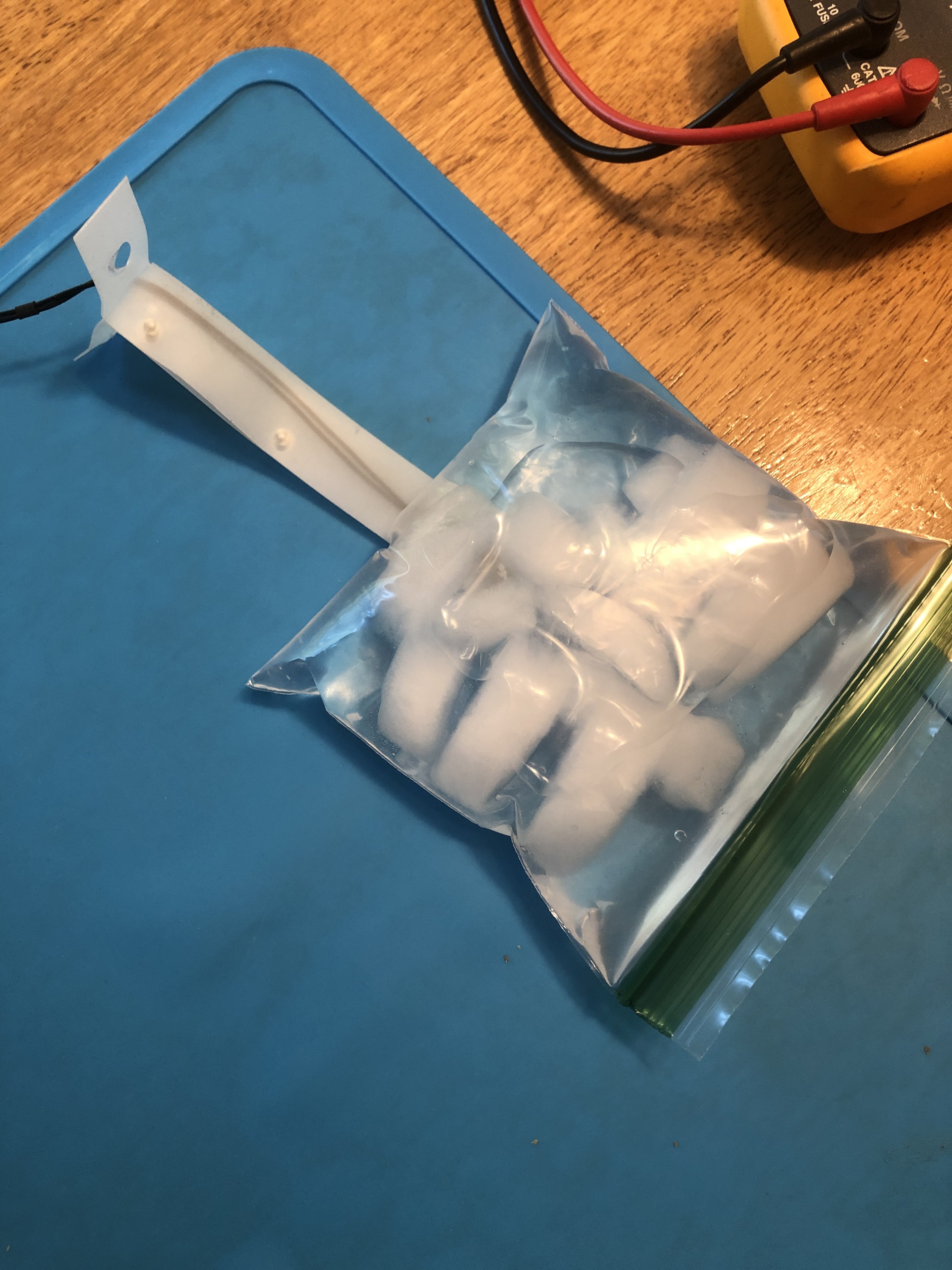

I ended up taking the ambient thermistor out and measuring the resistance at 3 temps. One with a bag of ice water on it, one at ambient, then one with a bag of warm water. The values I got were 20.8 kiloOhms, 12.43 kiloOhms, 6.5 kiloOhms respectively, which all seem reasonable and move in the direction you would expect. So I'm assuming the thermistor is good. At this point, I'm thinking its probably the Motsens Junction Board it plugs into. I ordered a new one, so I'll let you know if that works.
Here is my thermistor with an ice water bag on it.

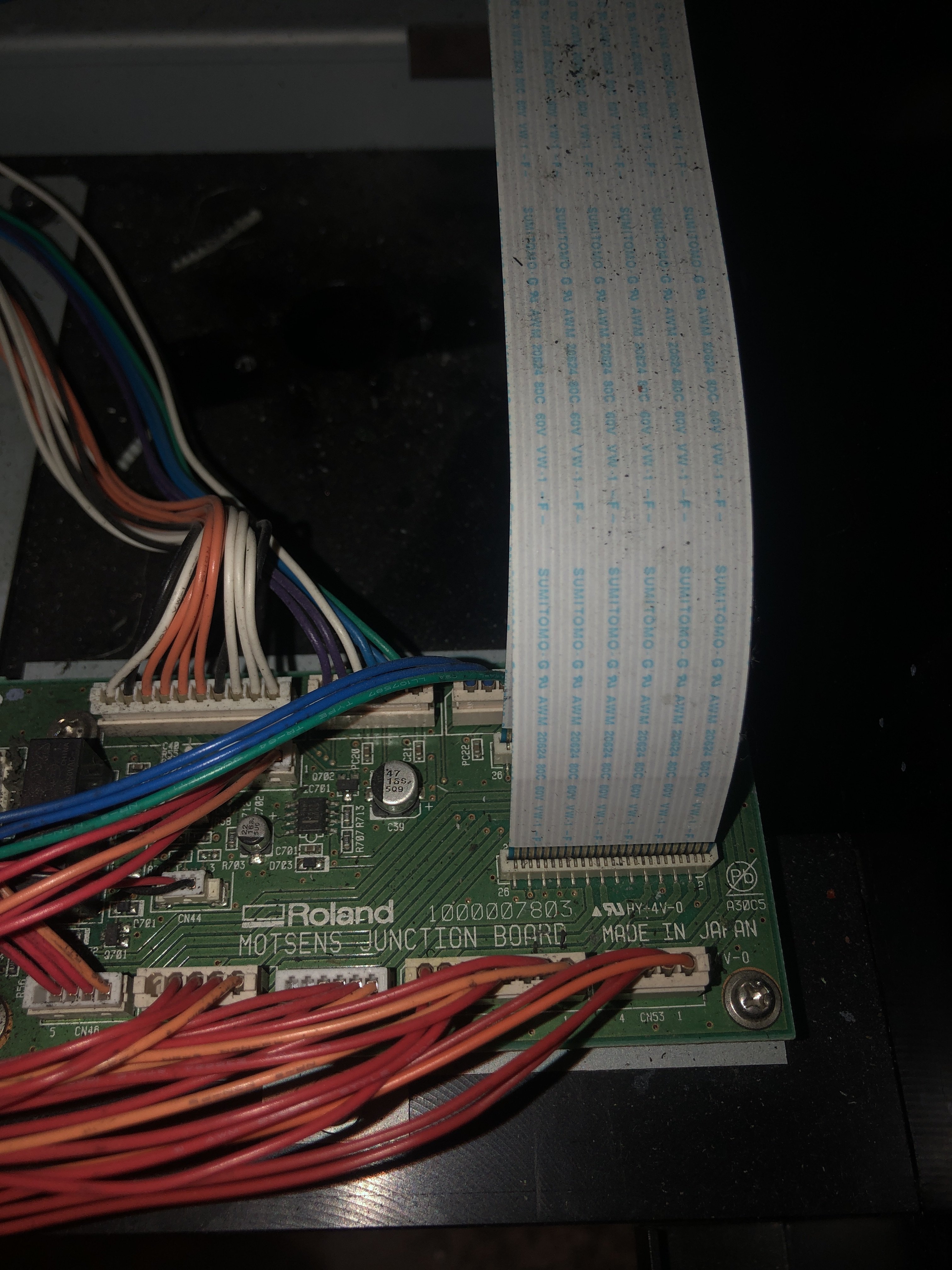

Here is the board the thermistor plugs into.

I finally got the new Motsens Junction Board in. I got it installed and got the same "temperature is too high" warning. Again, according to the thermistor check I did from the service menu, this is from the ambient temp thermistor. The head thermistors and board thermistors both checked out okay. I guess the next logical step is to replace the thermistor. I would have done that first, but based on my test with the multimeter, it seemed fine. Maybe there is just a bad connection somewhere. I'm going to order a new one and will post back here.
