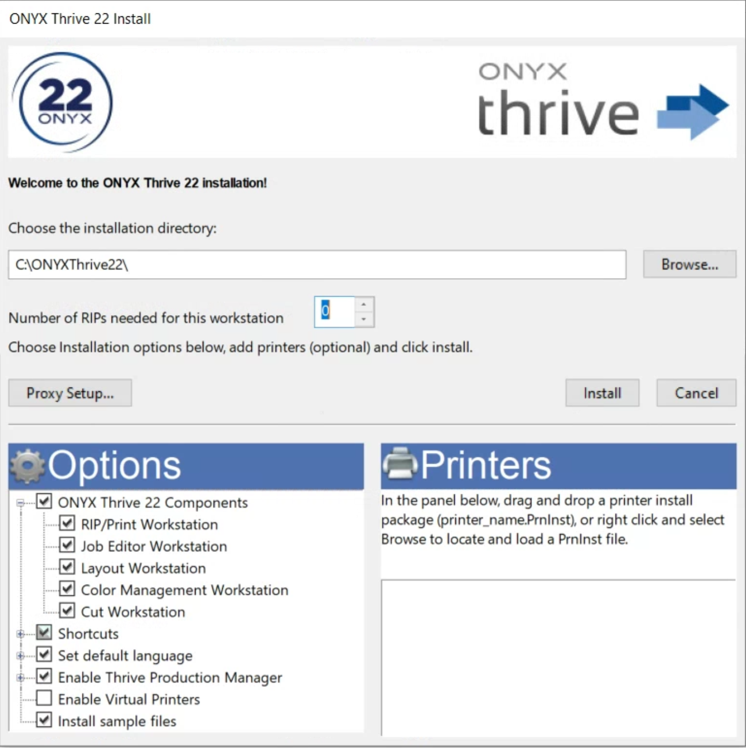

Either I'm doing something wrong, or my license is messed up then.
If I have onyx open on my PC, and go to install it on another PC... They zero it out to 0 rips during install and wont let me change it.
If I close onyx on my main PC, re-open it on my laptop, it goes back to 2 rips. I install it... it opens fine, but when I go and open it on my main PC... I get an error saying all rip licenses are in use.... even though I havent ripped a single thing on my laptop. If I close onyx on my laptop... I can then open it on my main PC.... Then when I try to open it on my laptop, all rips are in use, again if I'm not ripping anything.
If it worked your way, it wouldn't be bad. 2 Active rips makes sense - But at least on my system, the moment onyx is open... it assigns 2 rips to the open onyx, whether its using them or not... So you cant have onyx open on 2 PC's at the same time, even if you're not ripping something.
I've tried with 3 different computers incase one of them was messing it up, and it worked the same way on all 3...so unless my onyx key is somehow messed up, Not sure what I could be doing wrong.

Strange. I thought it works more dynamicly, need to test it. But I‘m shure you can limit the number of RIPs reserved for one computer in the settings. I will check that.

this is how mine works too. we have 2 printers / 4 RIP engines.
If onyx is installed on 2 pcs with 1 printer/2 RIPS and running. The other PC with onyx can only run with the rescores not in use.
So say i changed 1 PC to use 2 printers/4 RIPS. then the other PC will say 0 and wont allow you to do anything.
But with thrive, you also have the web console where you can enter jobs though. That can run on as many web browsers as you want.

Let me know if you figure something out, because the only way I could get it to work is limiting it to 1 rip per PC... then both can be open. But then it limits it to 1 rip per PC, even if only 1 is open...It doesn't "Reserve it" per say, it takes up a rip forever, whether the program is open or not... So you just halved how many rips and how fast your PC can rip files. So unless both of your PC's have a 100% uptime, you just lost productivity.... by a pretty significant amount.
I still think onyx is the best rip out there, but their implementation of the network license is pretty crappy and misleading.... Hence why if someone is on the fence and thrive costs more, I'd say sticking with production house isn't a big deal.
