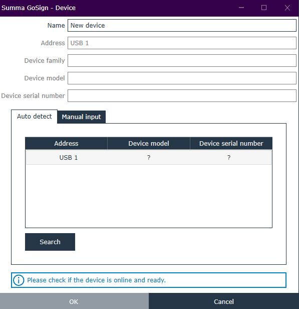

Restarted everything following installs. Currently on versions:
- S Class Firmware, MD9980: The latest internal programming for S Class plotters; version 039; Date 17-11-2014;
- GoSign 2.1.1
- Windows 10
- Winplot working well aside from the original issue
When trying to add the device to GoSign, it shows a USB device, except it never grabs the details and the 'OK' button remains greyed out.
Any ideas on what else to try, or perhaps I'm missing something. Thanks!

I'm pretty sure gosign doesn't support (old) S-class... Only S2.
Yep, your cutter is too old.
SummaCut R(L) (firmware rev039 or higher), S Class 2 (firmware rev024 or higher) and S One (firmware rev005 or higher).

Thanks again everyone for your assistance on this. I eventually contacted support for this, and they confirmed that my model S75T (S Class, but NOT the S One), is not compatible with the newer GoSign software. They suggested trying out the 'CoCut' software, which is a paid product but with a trial available. I have not gotten around to trying this yet. Ultimately, I worked around the issue by manually splitting the graphic in my design software (Illustrator).
