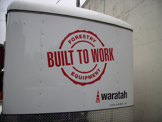

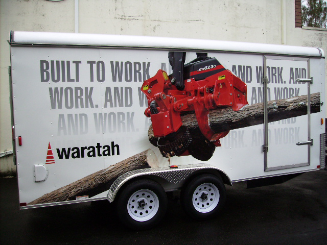

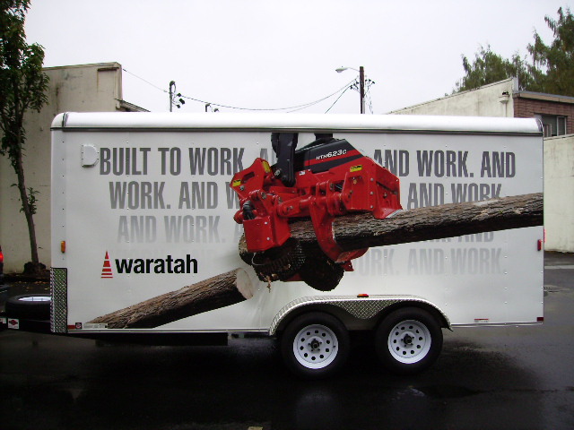

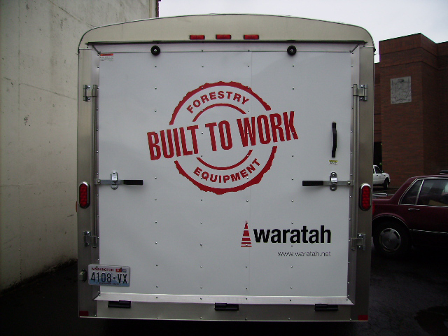

Trailer wrap we rolled out Friday
threeputt
Client supplied the artwork files.
16 foot enclosed cargo trailer. White in color.
Sides: Wrap.
Nose and rear: Vector cut files.
Media: 3M 180J witht the V-3
Laminate: GamutSkin
Torched down.
RollePro over rivets.
Primer 94 certain areas.
Fairly routine job, went out the door pretty well.

Nice Wrap. Great design that company made.
Question - Why the GamutSkin over the 180........? I'm not so sure that was a good move

I don't know. We've been using the two in tandem for a few years now with no problems (knock on wood) yet.
Which lam do you use over the 180?

Nice work!
To the question about GamutSkin - It's a good product, and more importantly, if you use it, GAMUTSKIN/Fellers warranties not only the laminate, but the vinyl you use it on, for 5 years (providing it is a cast vinyl).

...looks great. Would've been cool to see some flying sawdust with the saw bar retracting tho......it would be more eyecatching....... and give it a sense like it really just made that cut. Otherwise...looks awesome
