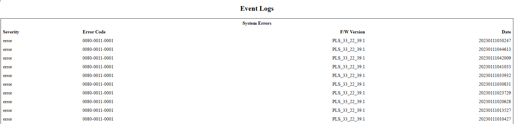

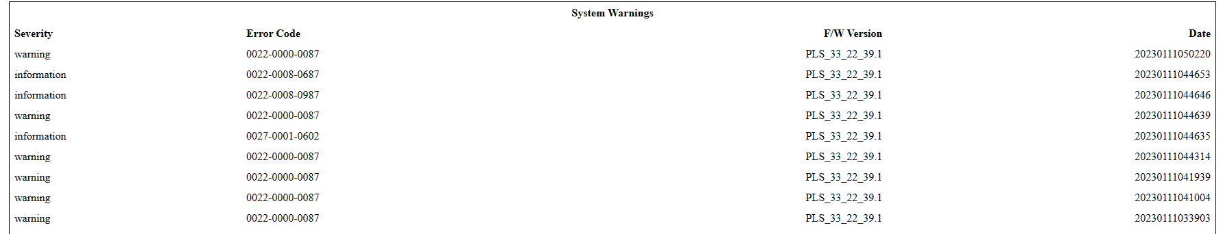

Hello all first time poster here and long time lurker! I have been having a issue with our HP 700w making it usable at the moment.
Our machine is out of warranty and I'm wondering if anyone has experienced this issue. It will start up normally and the screen will light up but when it fully boots the screen will turn off not allowing us to use the UI. The power button is flashing and we have already updated to the latest firmware. I was able to download the Service Information also which shows some error codes and system warnings

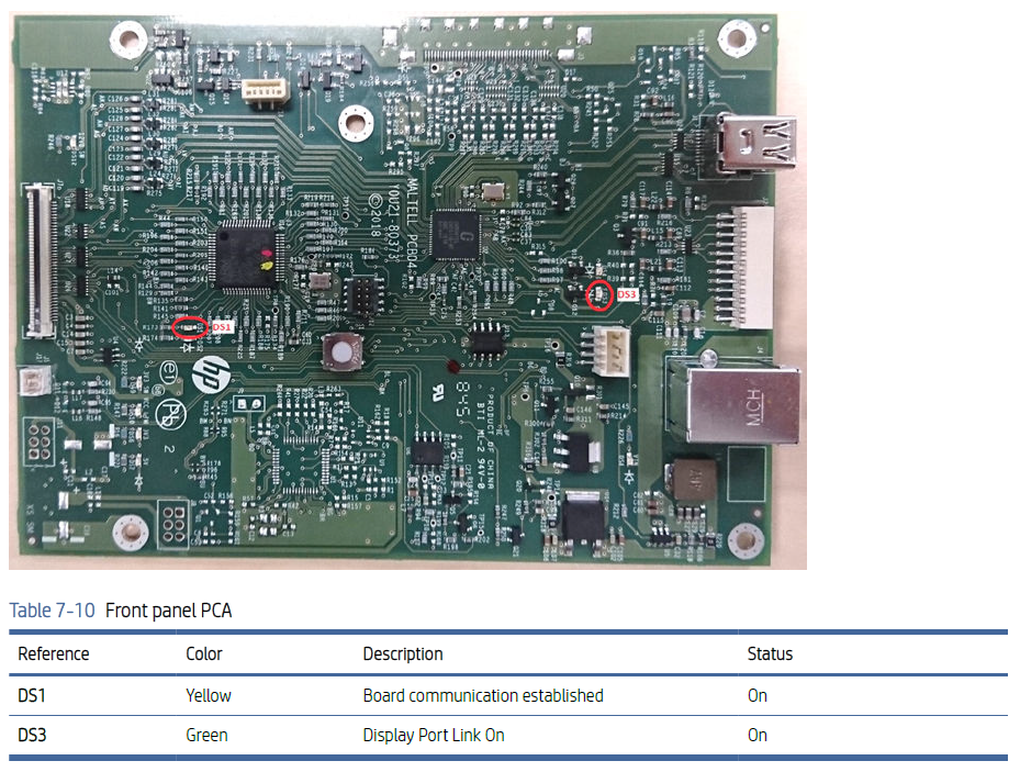

There's not much to it. You can check the LEDs but I'm not sure if they really give you anything in this case.

View attachment 163362 View attachment 163363

From the OP's error log, they either have a damaged cable, unlikely, or they have a display that went dead and it will need to be replaced. HP has the screen in stock and it cost $222.36.

Just wanted to let everyone know what the fix was. We ended up replacing the board since it seems like a component had failed. Now we are back up and running with it.
