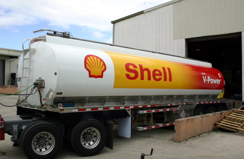

I did 3 or 4 of these.
They came in brand new, unpainted, uncoated raw aluminum.
The slag was still on most of the welds up on top.
We used 180c
Worked fine, done late 2008 - still look good.
wayne k
guam usa
