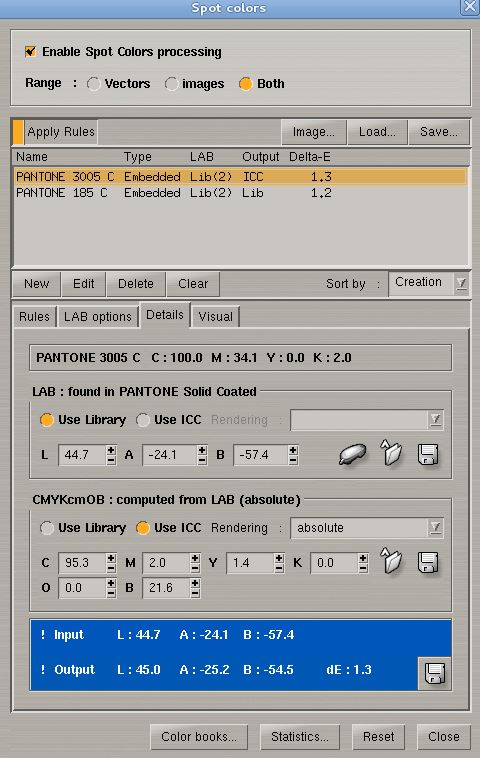

Since the already processed file prints as you expect it, the problem must exist when you are trying to RIP the file. It's a good idea to take screen shots of your settings so that you can duplicate them for future jobs. I don't have Onyx but in Caldera, we set our rendering for spot colors to absolute. Here's a screen shot of how our spot colors are treated in Caldera. Not sure if it helps you though.

I don't see anything in onyx where you can see spot color replacements for individual jobs, it has a list of pantone colors but I don't even see the lab colors that correlate with those colors.
