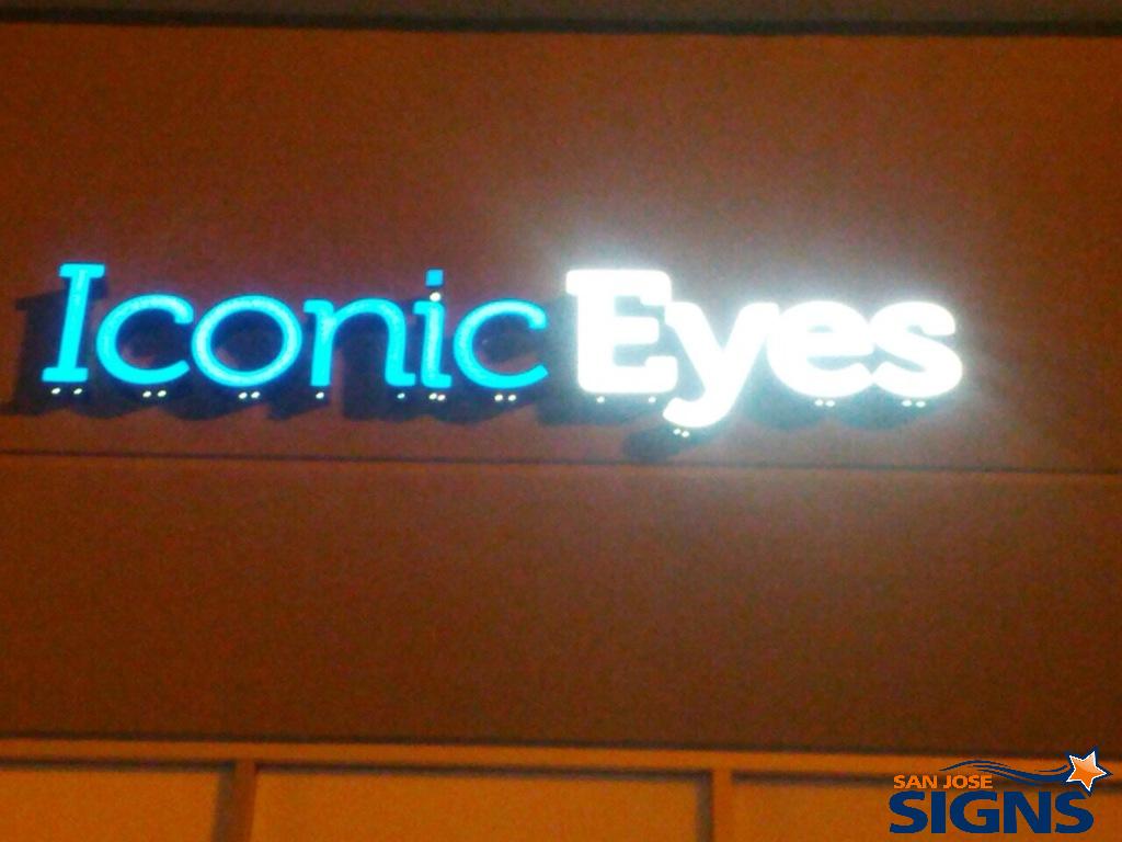

It appears it's an average of 18 months before neon starts to fail around here. I have a hotel customer who says they get repairs every 3 months for a letter going out. A new jewelry store opened here and in only a month, one of the neon signs is now sparking like static and is dim.
Every single sign I've done with LED has been brighter than neon, front-lit and back-lit. It's always like this:

neon burning-out? laughable. take a walk down Freemont St. in Las Vegas, and I'd bet over half of the neon there is 30+yrs old.
neon mainly has issues with cold weather. the "service" most people incur, aside from the obvious broken tube, involves removing the tube & rolling it around until the bead of mercury that has solidified/settled finds its way back into the electrode. plug it back in, and it fires-up beautifully.
We still do neon here in Wisconsin, mainly as service, but we lean people towards LED as a more cost-effictive option on new signage.
