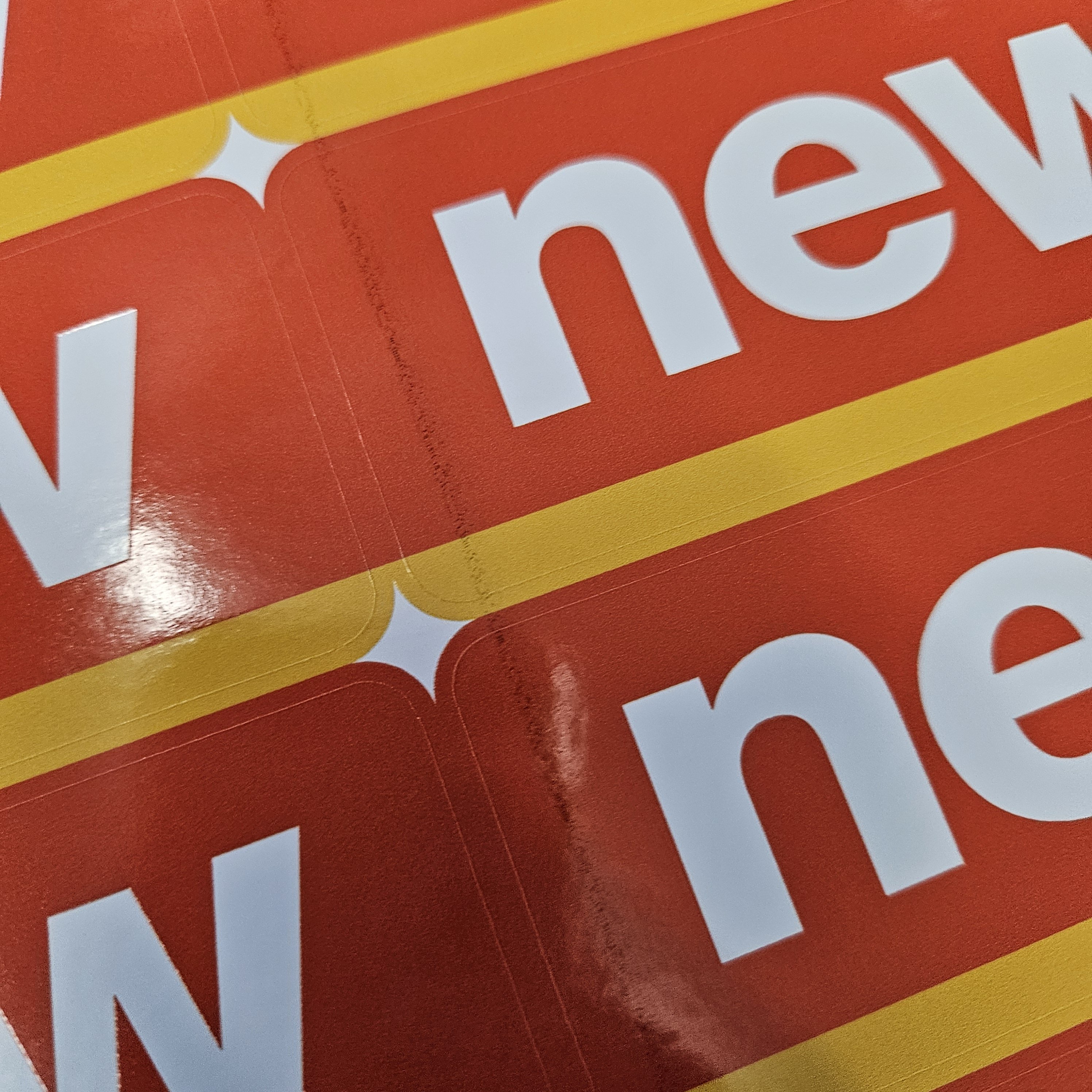

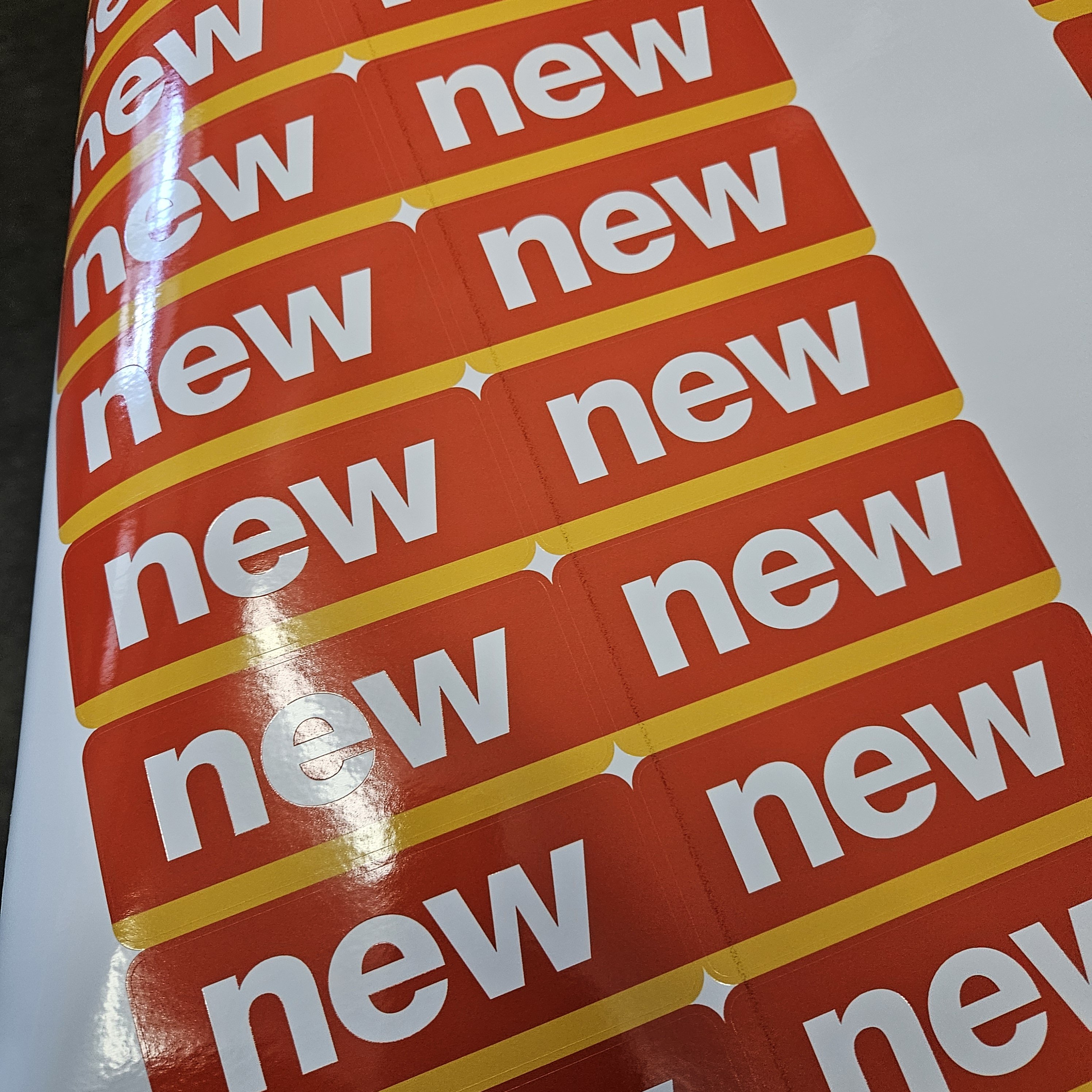

Anyone else have this issue when printing clear gloss?
I get random black steaks across the width of the page when printing Clear UV Gloss, 600x1200 Uni-Direction, single pass, no roll back, 44/44% UV, head height 2.
It can happen with several prints in a row or just popup after 5 good prints, there is no consistency as to when it happens.
Anyone have or solve this issue?

This still happens after a manual clean.
The 1st print may have a black streak, and then next print won't, even without a clean in between.

If media is lifting, might want to turn vacuum strength to high if not there already. Also, make sure rollers are aligned.
