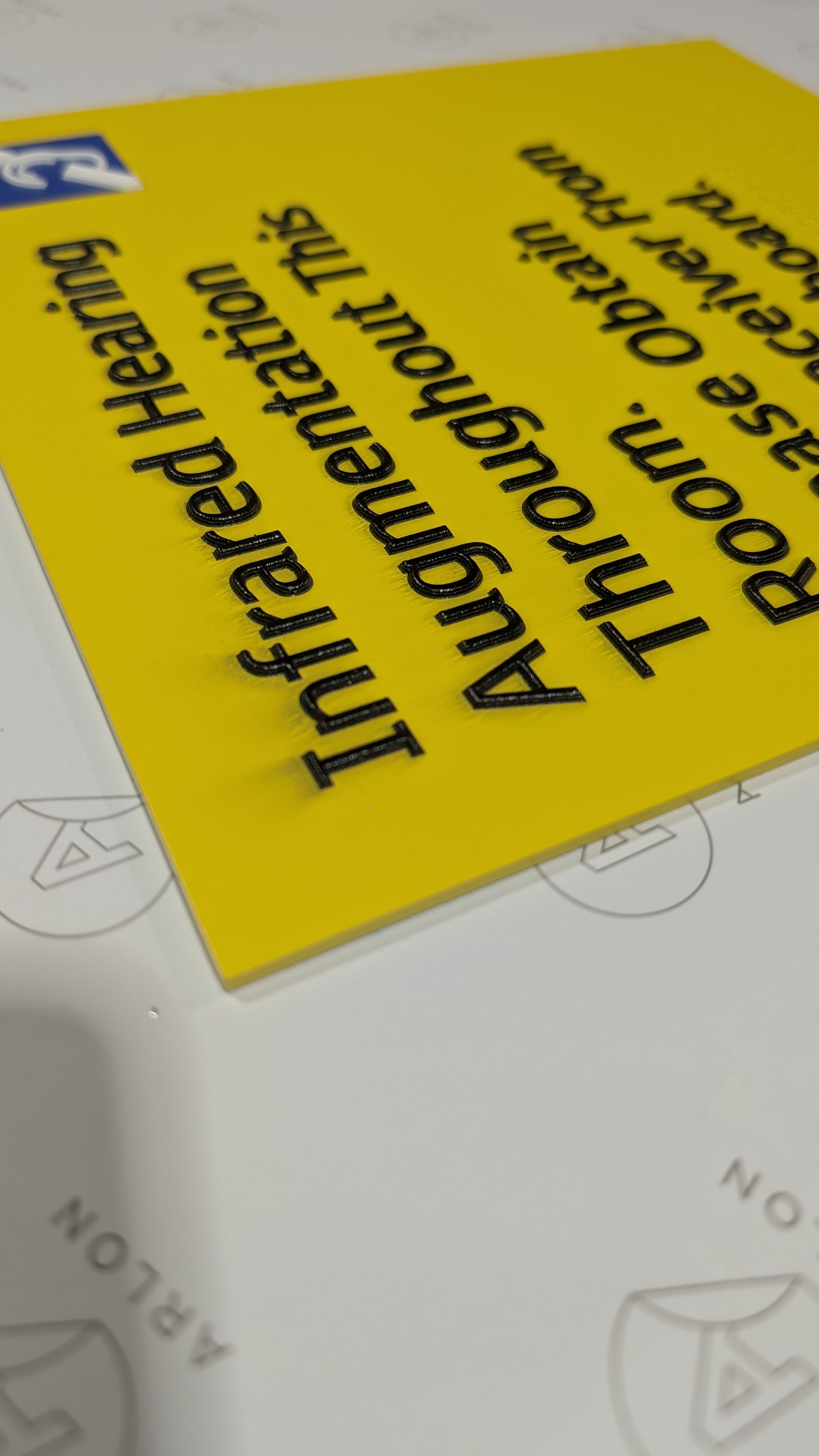

My 7151 is producing quite a heavy black overspray when printing tactile components
Can anyone give me a little insight?
Worst of it produces on the far left back potion of the bed. But it's not limited to that location.
The spray is in the direction of the head as it travels.
Running the 1200x1200 uv-pet profile

So as it turns out, a little TLC and bed leveling helped fix this.
