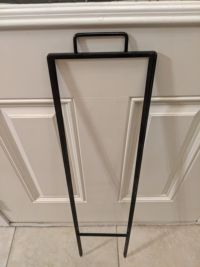

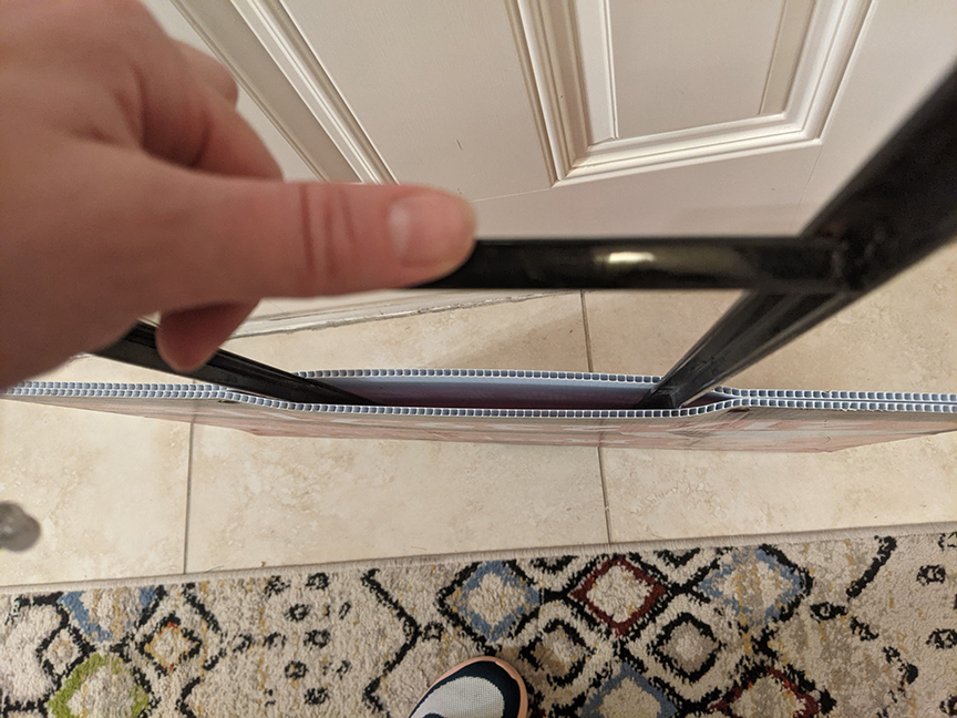

The metal stake goes in the folded face through the opening at the bottom (much like the stake for a folded political sign does) but then the handle of the metal stake comes out of the top of the finished face. The folded face has a cut-out at the top, in the spine, to allow for the handle to come through. (See attached photos).

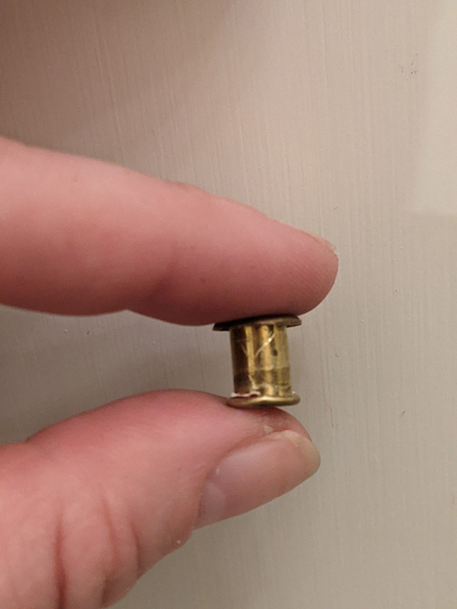

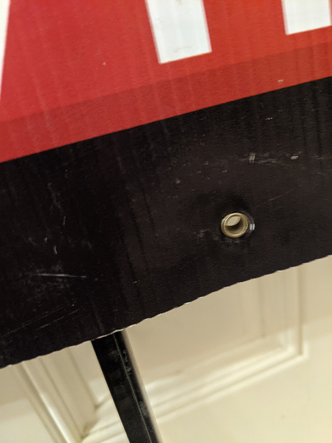

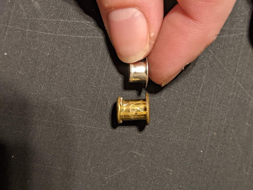

The folded sign is held together with four fasteners that look like grommets but seem much more heavy duty that the grommets I have experience with. I was unable to open the sample and it's much longer than my standard stock of grommets. (Again, please refer to photos.) What are these?

The grommet looks like a long neck (or long barrel) grommet. Grimco has them.

It looks like a long neck grommet is used to make a sandwich. Then wedged onto the frame
Measure the spacing / placement and "print" the registration marks, which will make placing the grommets much faster
