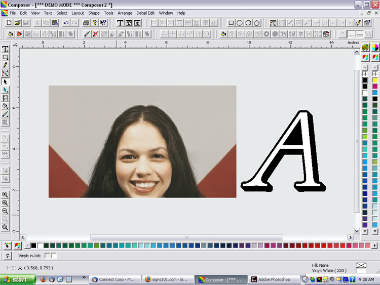

I need to fill text with an image...then an outline....then a shadow.
In my Inspire you just position text (or curves) over image and create mask..........voila!

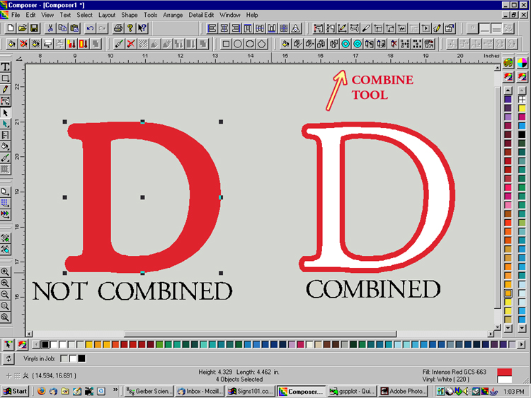

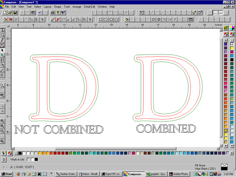

You use a combination of combining same colors so the center is a hole and then select or create cutpaths to finish the piece. You must use the same vinyl throughout with foil fills. All fills would be set to overprint.
Now place the vectors on top of your image, size and position it and it should preview and print/cut correctly.

Pictures demonstrate better.

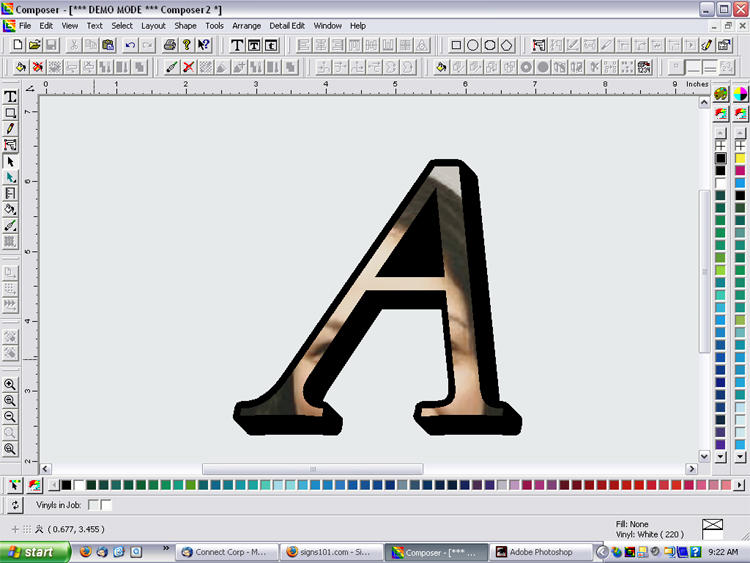

To run it with the entire image behind it showing, you set the text to overprint and turn all cuts off. then set a rectangle or whatever shape you want to use to cut out the image.

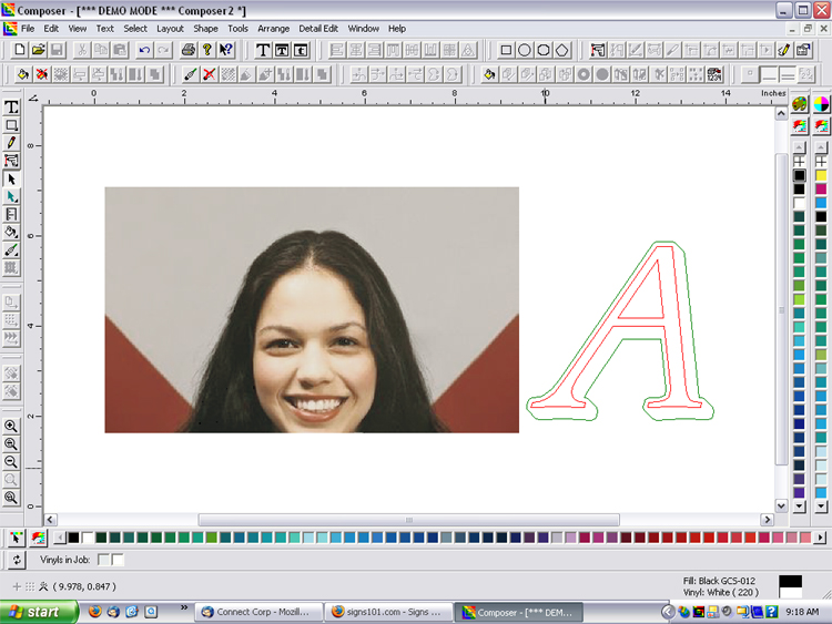

I have a "D" in atomic red....then outlined with atomic red...applied cut line to outline
now i just got two atomic red pieces.....its not "knocking out" the inner piece
Jamie Christy
i can see through it now but my image is still a big square behind my shape.....i have the outline set for cuts is that correct?

Pictures
