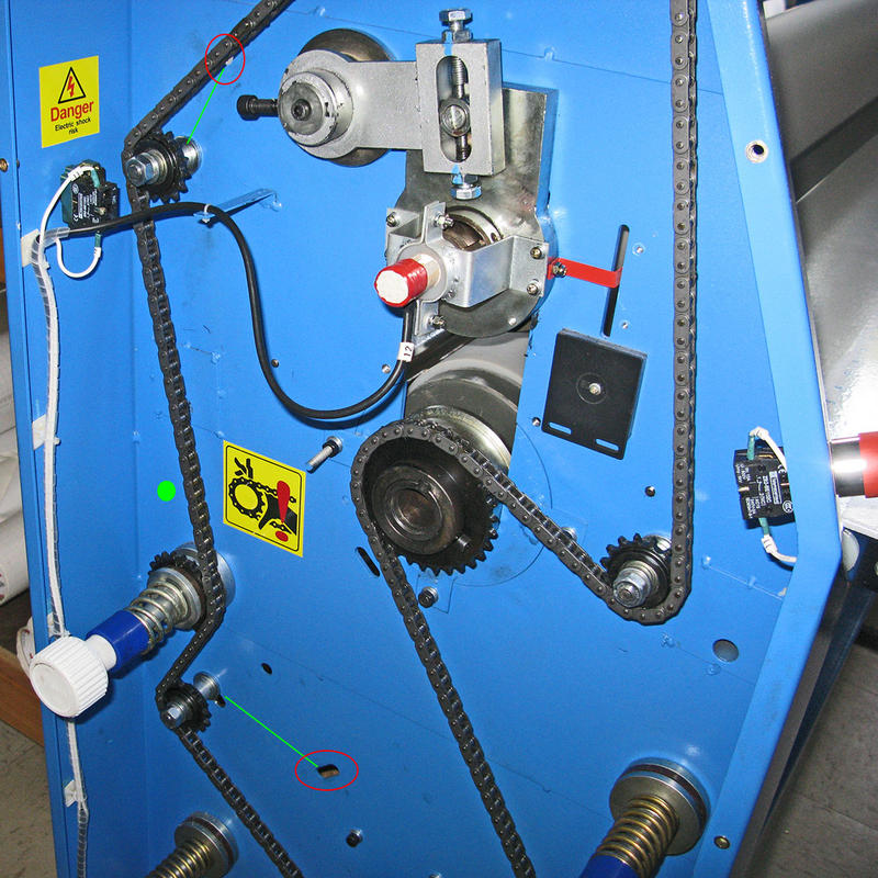

This quick update is regarding the front takeup on this model laminator. Aside from that, now that we have really had time to get used to the machine and have been running it daily for a couple of months I have to say that we are overall very pleased with the machine.
On the front takeup on the machine, one of my complaints on is that it winds the material face in. It is almost never a good idea to wind materials face in (might not be as much of an issue with reverse-wound rolls of material). It can cause numerous issues when the material has always been wound face out though. On close inspection of the way the machine works and figured I could maybe re-engineer things a bit to make the takeup run the other direction so that it would wind the material face out. Well I did it.... yes, I drilled 2 new holes in our brand new laminator and relocated 2 gears. In its original configuration the chain went around the outside of the front takeup gear. I needed it to wrap around the inside of that gear which means I needed the chain to be relocated some to make this happen. Now - ideally an additional static gear and an additional bit of chain would be used as adding an additional static gear in the spot marked with a green dot would allow the chain to have more contact (wrap further around) with the takeup gear. As I have it though it does work just fine and the modifications are actually very simple.
The attached photo shows what I have done to achieve this. The upper left gear is a static gear, its original location is circled in red. I moved it approximately 2.75 inches down and 1.25" to the left. The lower left gear is not a static gear, this one is in a slotted hole and is your chain tensioning gear. This ones original location is also circled in red. This one I moved about 5 inches to the left and maybe a half an inch up from its original location. This one I also drilled two holes for and then opened the metal up between them to make a slotted hole since you still need to be able to adjust the tension on the chain.
So - with the gears in their new location the chain can now go on the other side of the takeup gear which makes it now turn the right way. :smile:
I did try to see if there was some way I could move the upper gear lower down and closer to the takeup gear which would wrap it further around the takeups gear (giving it more contact on the gear). Moving the upper gear much further down though has 2 problems - one is the chain would then come into contact with the upper roller, and two it would also end up behind the emergency shutoff switch which would be an inconvenient spot. As I saw it what I did was about the best way to go about it.
Edit to add - one thing I should point out. Since I have publicly documented this I have likely voided the warranty on our brand new laminator and that anyone attempting to modify their machines does so at their own risk. I'm hoping my warranty is not voided due to this though. The modification is an improvement to the design and my hope is that US Tech will implement this in their future machines. There is zero cost to the change and structurally affects the machine in no way. In fact the only non-reversible part of this modification is the 2 holes that get drilled. The only change in the operation of the machine is the direction in which the front takeup runs.
