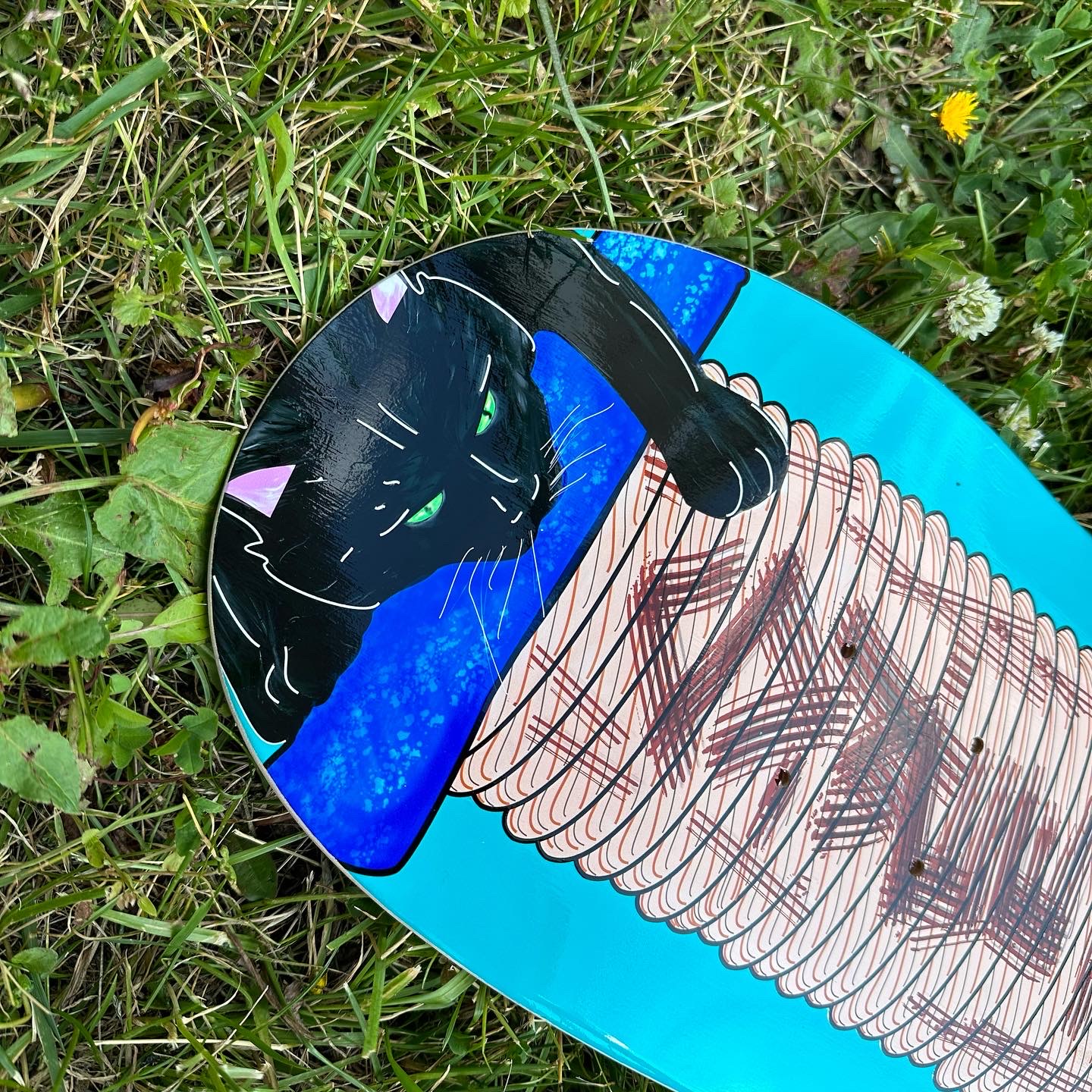

Being the resident skateboard printer of the forum, and someone who owns a UCJV300, you’re not going to get the high gloss you seek from the LUS inks. The Mimaki ink sets are just too matte.
I have a high gloss film that does nothing for the Mimaki inks, but makes my special rigid inks out of my Roland look like laminated solvent ink.
It’s one of those is what it is scenarios.

I run LUS170 (STS) from my UCJV.
if you’re out of warranty, I’ve heard through the grapevine Marabu’s third party LUS-170 is glossier. By how much? Who knows.
If you’re out of warranty I’d talk to a company like CMYK engineering to see if they have a Gen 5 compatible semi-rigid/rigid ink that cures glossy.
The old Roland UV ink formula is solvent based, so it itself is glossier than the new higher stretch options like Mimaki’ LUS170/200. I run a specific epson DX rigid ink to get my high gloss, as even the OEM solvent style from Roland isnt glossy enough.
There might be conversation to have on if the other LUS models for the flatbeds / GEN 5 makeup could be slid into the UCJV to achieve better gloss. I haven’t seen those ink types in person, so I don’t know if gloss goes up as the stretch level goes down. In my head, you’d buy third party 170 chips (they’re fairly cheap), and load that ink of choice (flush prior).
It’s just an interesting road to travel.
