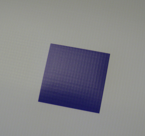

I use Corel X3 & Onyx.
Drew a square, filled with Pantone 072 Blue.
Export to EPS
Open EPS in RIP, Then send to printer.
You want pole pockets or a regulat hem on this 2"x2" banner I made you??
Picture isn't great, but it's Blue.... not Black.
I agree... don't use spot colors. Buy a pantone CMYK bridge chart ($99) and use CMYK formulas. Inkjet CMYK printers don't print spot colors. The print colors that look like spot colors.

jiarby how close to the pantone color is it?
Is it spot on?

jiarby
It's close enough to the pantone color for the softball little league banner.
Even if the color was off, that would be a function of the profile & the RIP...not the printer.
The 1604 is a fine printer... did you take your meds this morning??
