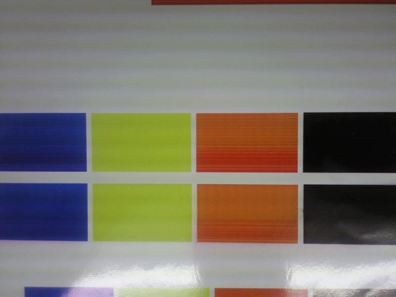

Anyone ever have this problem? I am getting very bad banding problem with only 2 colors when printing... weirdly enough it just happens to be the 2 cartridges (cyan,magenta) that have been in the printer the longest.
The 2 cartridges that I recently replaced (black,yellow) are working perfectly.
I have tried taking cartridges out and gently shaking but does not help. And there is still plenty of ink in these cartridges.
Would anyone have any insight as to what else may be causing this?
thanks alot for any advice

before blaming the ink (could be a coincidence), i'd do an ink line/damper swap with other head positions to see if the issue follows the ink supply or stays at the head position.

i would bet it is the maint. station. Do a nozzle check and post it. You will need a light with a blue cover, to see the yellow better. When you say, no ink is draining during the cleaning cycle, it could be alot of things. Pump not working, cap not sealing, lines clogged from cap, or bottom of head very dirty.

If the picture is a CYMK print you are getting cross contamination of the inks.
Are you sure the tubes are pulling ink through if not you have a cap seal problem or blocked tubes.
Check the double connector between the maintenance and the pump as I have just cleaned mine and found it to be completeley blocked it took 2 days to clear all the pipes and get it flushing ink through the waste pipes again.
What does the test print look like? It looks like you have a lot of nozzles blocked.
It maybe needs a head soak and then once you have a good test print I would print a solid CMYK pattern until you get all your colours back.

+1 on the cross contamination and blocked nozzles.
(Also, you didn't say what model ValueJet you have.)
This could be the result of numerous things, but if you have a 1204/1304 I would first take off your side cover and do a thorough cleaning inside. I recently did this to mine and was surprised how much crap builds up near the wiper and drain channels/tubes going down to the waste tray/bottle.
Some things to keep in mind if you're fairly new at this;
1. Eco solvent printers need to print, if you're not using yours often make sure the machine is on and it is doing a routine cleaning cycle every 6-12 hours. Machines sitting idle or turned off for long periods is a recipe for trouble. Also, make sure your head height is always set to low when the machine is idle for long periods.
2. The condition of your pump and capping station is critical. If you have a poor seal between the head and capping station this allows air into the head which will result in plugged nozzles as the ink dries in them. *I have left my machine turned off up to 3-4 days with no problems, but my head is also sealed tightly with the capping station.
3. Make sure you are doing a thorough manual cleaning 1-2X per week using cleaning solution/denatured alcohol and swabs around the head, wiper blade and capping station.
Also, do a test pattern, are any of your nozzles plugged?
