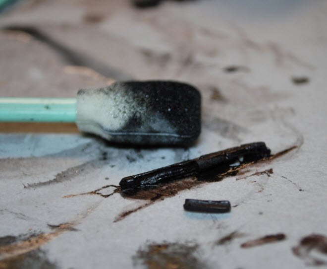

I just did mine... same thing, a clogged tube. I unblocked mine by squirting cleaning solution in the cap and then trying to pull it from the tube. Then I squirted cleaning solvent up from the tube into teh cap. Eventually the ink softened enough that I could swish solvent back & forth.
Finally I pinched the tube with my fingers and squeezed the ink booger all the way down the tube. It was about an inch long, and there were a couple smaller chunks.
I suppose you can open up the pump and just replace the tube faster, if you had the spare tube.
