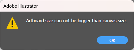

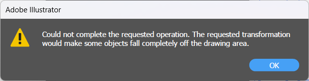

I use Impact Vehicle Outlines. I have recently downloaded the 03/04 Vauxhall Vivaro. I am trying to do panel infills. Ideally I would like to use the EPS as it is 1:1 scale. However, I am unable to do this as when I open it in Illustrator, it says it is bigger than the canvas (not artboard) allows. I've tried going into Object > Transform > Scale, but it won't let me reduce the scale. I keep getting a message about things falling off the page.

If you zoom out as far as possible and turn on guides, you'll probably see some guides close to the edge. The message is appearing because guides are being treated as artwork.
