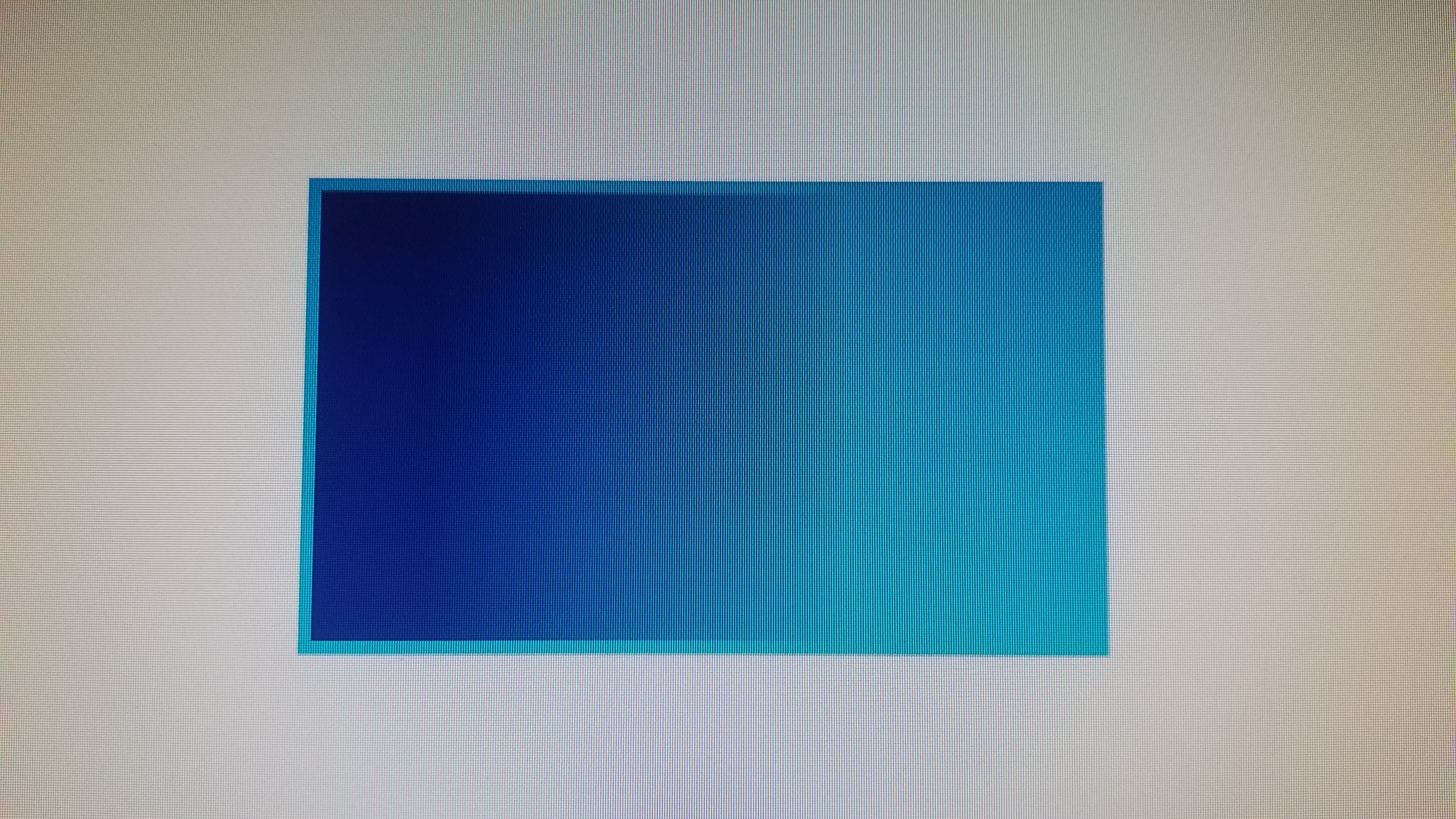

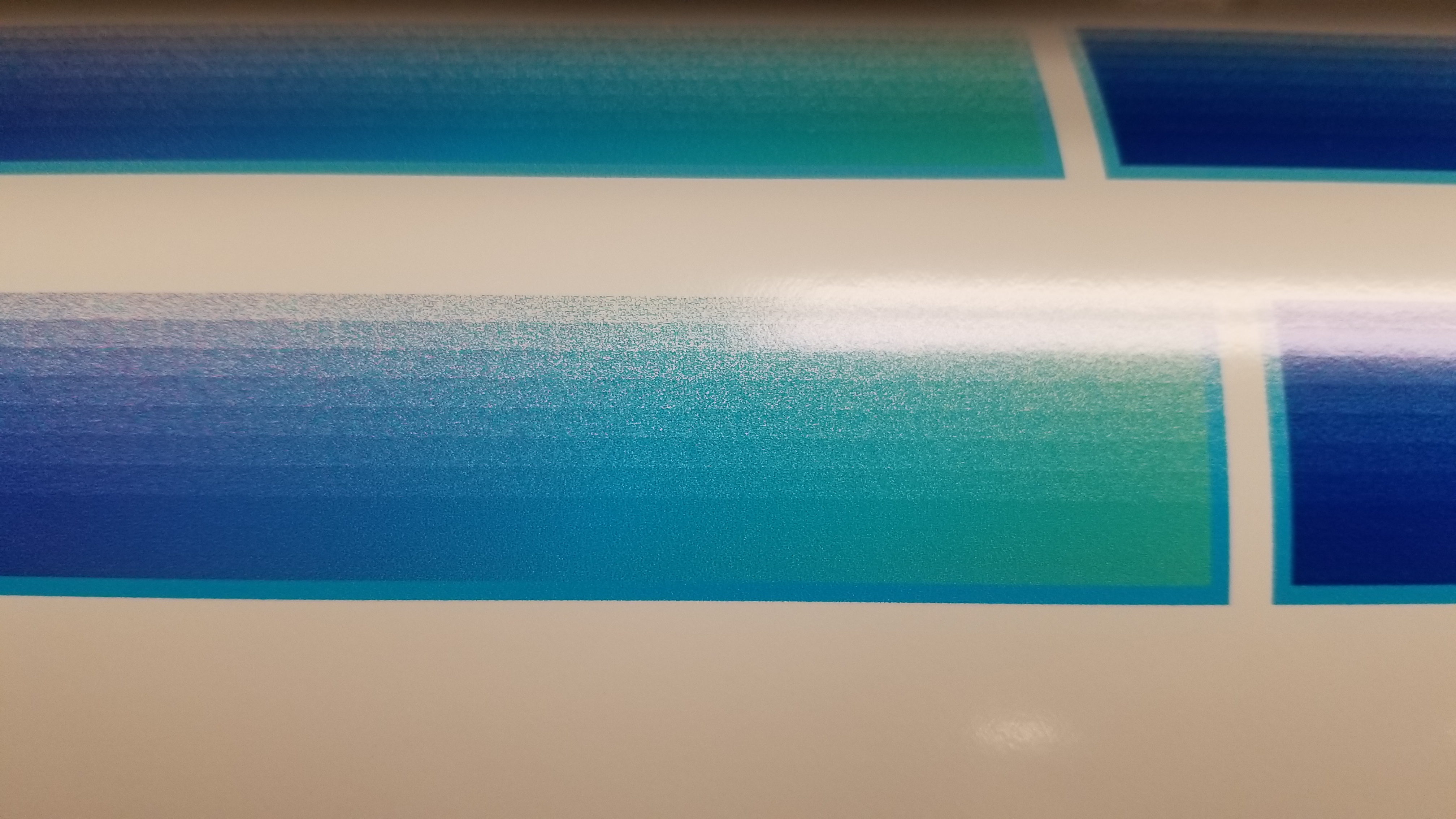

I'm using VersaWorks version 5.5.1 with a Roland SP-540V.
I'm having problems printing a gradient using the Roland Color System Library.
The light blue (RVW-PR19H) is printing fine as the spot color around the rectangle, but it is being changed to a greenish color in the gradient.
I've sent this to VersaWorks as both RGB and CMYK, EPS and PDF.
I've tried rasterizing it before export, exporting it as a .tiff, etc.
I've printed gradients successfully in the past so I know it isn't the profile.
However, whenever I change "Pre-Press U.S." to something like "MAX IMPACT" in the Color Management tab, it fixes the gradient issue but it mutes out all of the other colors (the red spot color looks muddy brown, etc.).
Does anyone have any suggestions?? I'm about twelve hours and a half mile of material invested in test prints.
See attached...

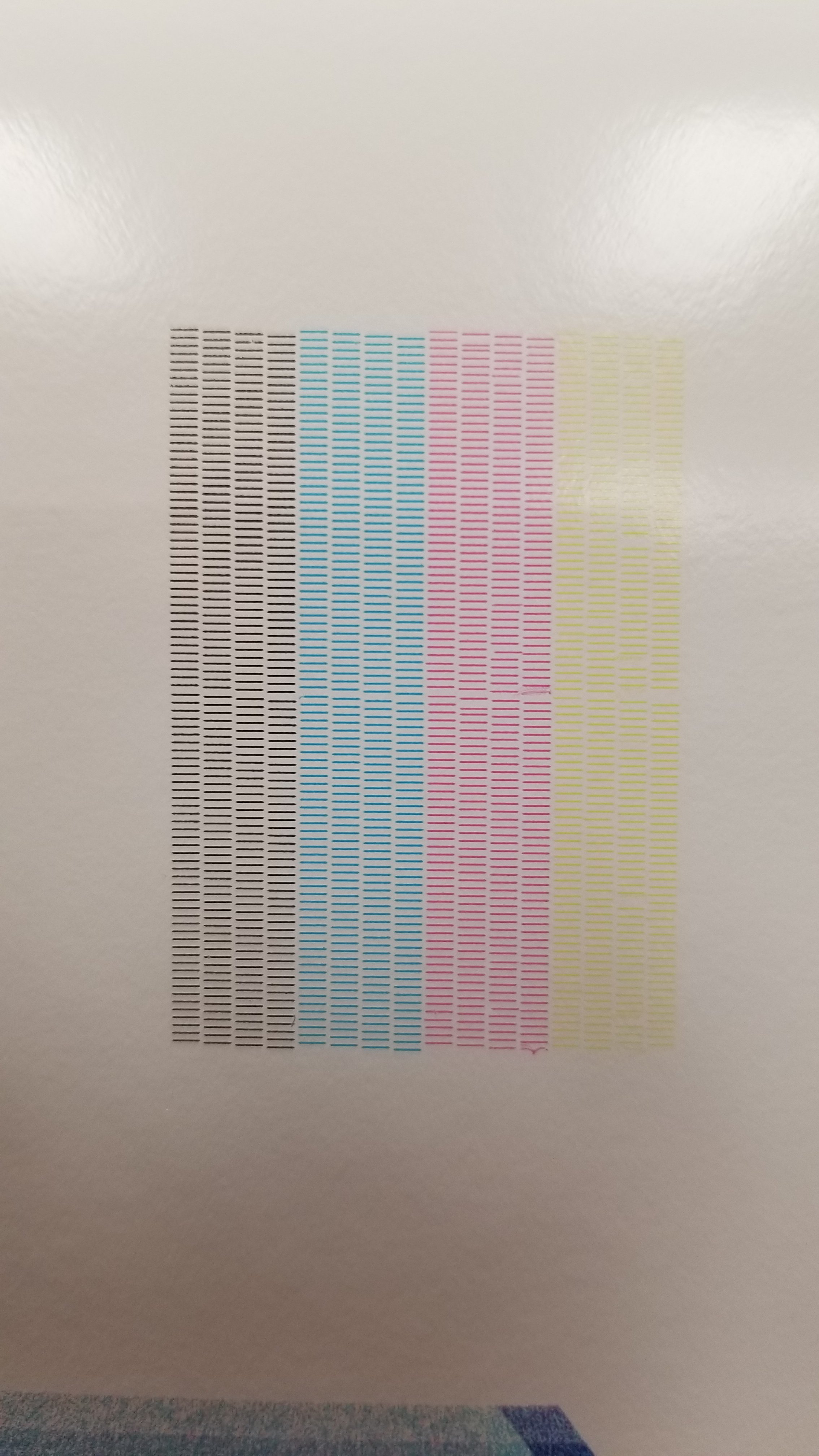

Being you have been able to do good gradients in past with the same printer and VW, and the same inks?
What does your nozzle test print look like? Any defected nozzles?
On this model printer, all colors need to be firing perfectly to get the desired results.

Here is my test print...
The printer prints the spot color perfectly if it is not part of a gradient.
The light blue in the gradient and the light blue outline around the rectangle in the first post are both RVW-PR19h. The RVW-PR19H outline prints accurately, the RVW-PR19H in the gradient prints teal.
If I mess with the Color Management settings I can get it to print ALL of the RVW-PR19h as "teal," but I can't make it print correctly.
That leads me to believe the problem is the color "interpretation" in the software somewhere.
The printer prints fine.

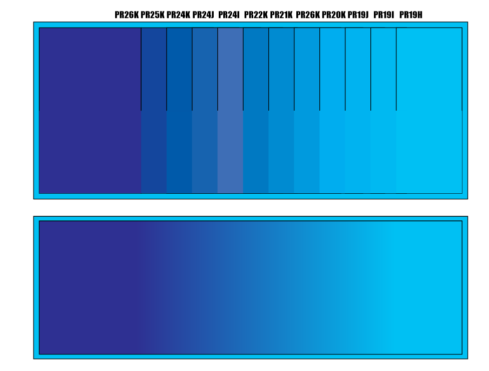

I even tried creating two new colors using the CMYK values of the Roland Spot Colors I'm trying to use and used them in my gradient and had the same issue.
I tried creating them as both BRG and CMYK and it makes no difference.
I'm baffled.
VersaWorks will not print a gradient containing light blue. It turns it teal green.
Any other suggestions?
I've wasted days on this.
It's maddening.

So, I then changed the CMYK values of those colors (the default colors are LAB colors) to match the CMYK values of the colors I'm trying to print off of my Roland Color System Library chart (RVW-PR21F = C:50 M:14) and tried to replicate the results. The color inside the gradient printed just like the color of the border, so the gradient issue is fixed, but the colors are off. C:50 M:14 does not look anything like RVW-PR21F.
I don't get it.
You may need to print a new RVW Color library chart. Just make sure that you put all the settings that your final job is going to be into Queue A quality’s settings Before you print the chart.
The chart is only as good as the way the machine is printing at any given time and the material you’re using. So, you may need to print new charts from time to time. Also, if your final job is going to be laminated, you need to laminate the chart. You need to treat the chart exactly the way you’re going to be treating your final print the job
