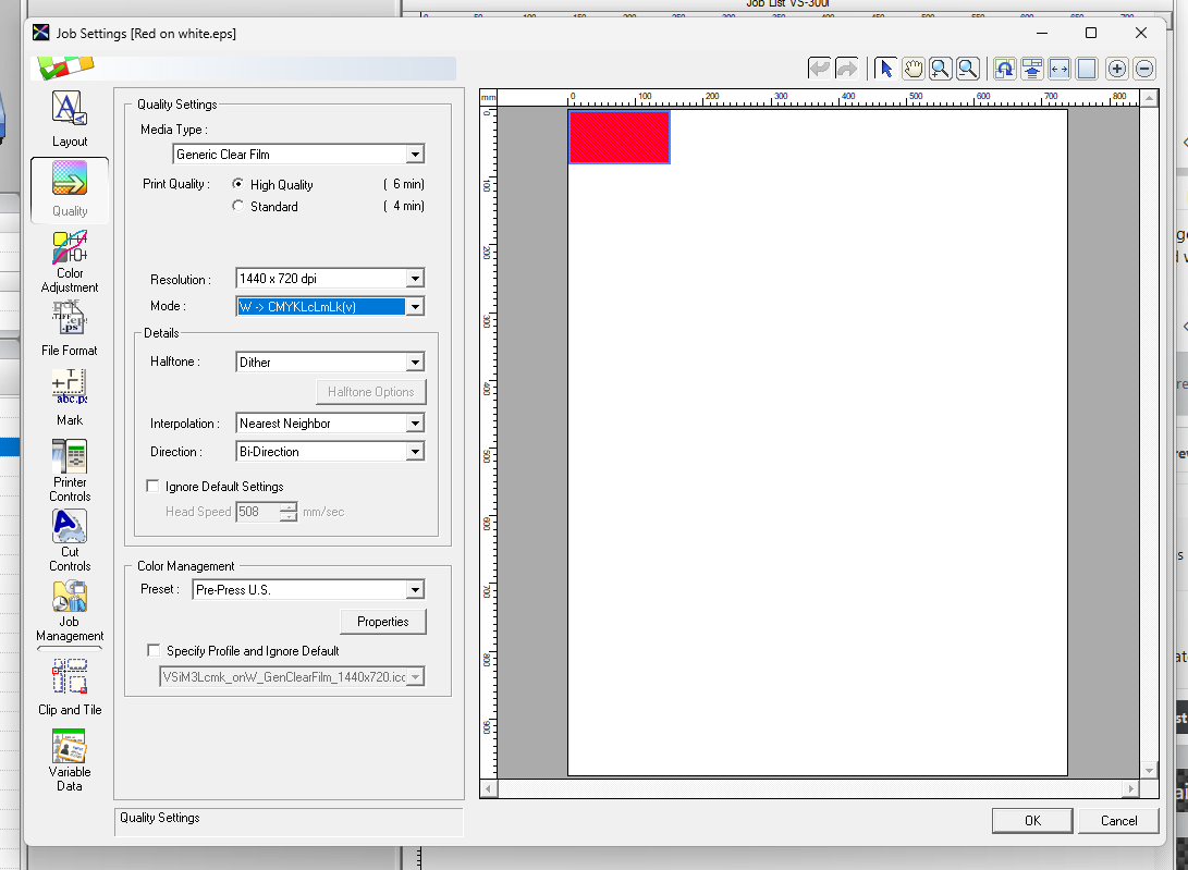

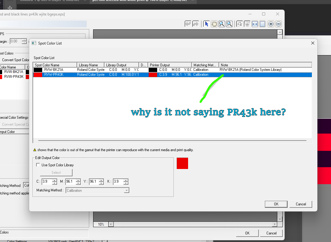

Ok so suddenly my print my red on white is orangey, this is driving me mad, i dont know why it started all of a sudden.
So in versaworks ,the version was 5.5.1 but i reinstalled it and now its 5.0.0 i cant find the 5.5.1 version. but the problem is the same,reinstalling didnt help.
Settings in VW
Quality: Roland DG Generic clear PET film
Mode: W->CMYKlclmlk(v)

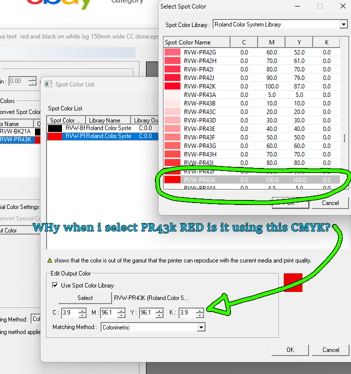

now this is the part doing my head in. in the file format under spot colours im using red and black

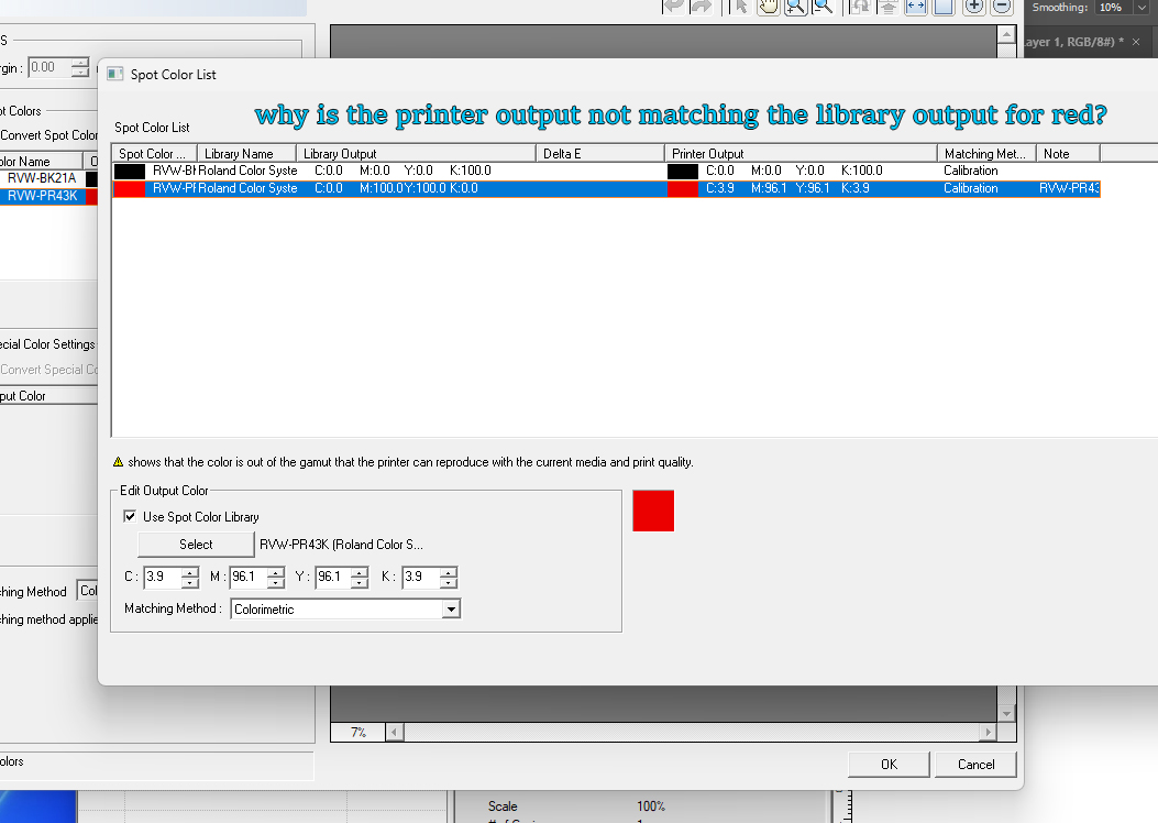

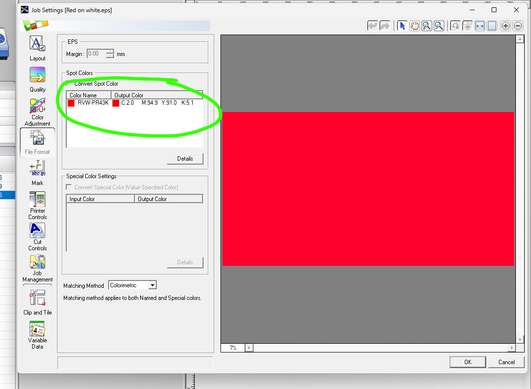

red is the problem here and when set as above the red says : RVW-roland colour system,library output : C3.9 M96.1 Y96.1 K3.9
Why is is setting these parameters for red using pet clear?

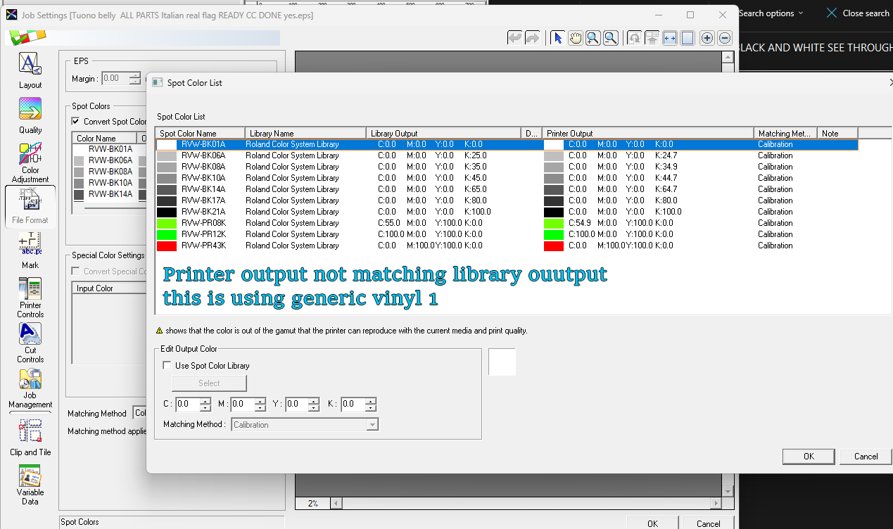

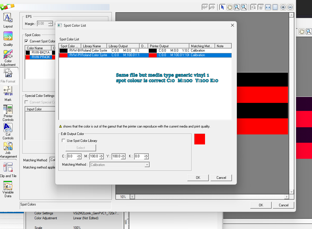

If i change the setting to generic vinyl 1 the red is as it should be: C:0 M:100 Y:100 K:00
and this prints a nice vibrant red as it always has.
WHY can i not get this red setting when using Clear film setting?
i need to print a white background with a red top on clear vinyl.
Even if i tick the box (use spot colour library) and manually change the CMYK it still prints orangey
