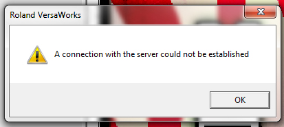

I just updated Roland VersaWorks to the latest version (5.2.2 I think), and after the update when I launch the application I get an error message saying: "A connection with the server could not be established".
I have tried several times, however I get the same error message.

The message "A connection with the server could not be established" refers to the Roland Update Server, not the printer...
Reboot and check all network connections.

Another thing to try is to simply disconnect the network connection, reboot, re-connect and check for updates again. Sometimes DNS be the problem.

Bobby, your a genius---------Turned off the main power to the printer, disconnected the network connection, turned on main power, re-connected the network cable, and NOW VW is working again........Yea!

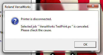

As mentioned, after the VW upgrade I kept getting error as shown below:
  • Error message (Printer disconnected) 8-30-14 after updating VersaWorks.jpg
