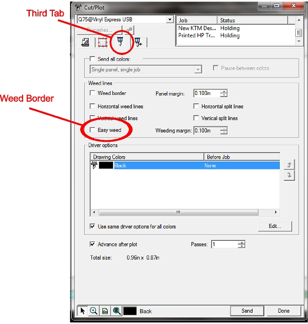

These are all settings and they are there. You just need to look for them. I have had all versions since 7.5. They all have a weed box option. If you go to workspace under file you can set it to Flexi 7 and everything will look like 7 did.
Here is the easy weed box. Is this possably a FlexiPro only option?
Must be.....I'm not crazy because that check box isn't there on the software he has. I have been using the software since 2001 so I knew what to look for. It is Pro but maybe they left that option out on earlier versions and brought it back later?

What I do is send both jobs at the same time using the send as separate jobs box in the lower left of the pic I posted. When I send I usually have it hold rather than send now. Then it will add 2 jobs to the product manager the first is the print and has a .fjb the second is the cut and has .job
Interesting as it doesn't have this option. It has Send: Hybrid Job, Print Job Only, or Contour Job Only. Hopefully now you guys can see why I am so confused on everything. If things were as described in the examples above then I probably could have figured these things out on my own. I can only imagine that Flexi got a lot of complaints from previous users about missing options that they were used to so they were incorporated later on.

Where is Easy Weed
Easy Weed was removed for the release of Flexi 8.0v1. The reason was because weed lines were introduced and deemed to be more useful for weeding text. There was an extended (several month) beta period with close to 100 users and not a single one noticed it missing. After the release there were some complaints and it was added back with the 8.5v1 release. Unfortunately, there is a nominal charge to go from 8.0 to 8.5 to get your Easy Weed back.
Occasionally, functions that seem minor are removed with new versions as a way to clean up the code. Most of these changes no one ever notices, but this was one exception that was added back based on your feedback.
