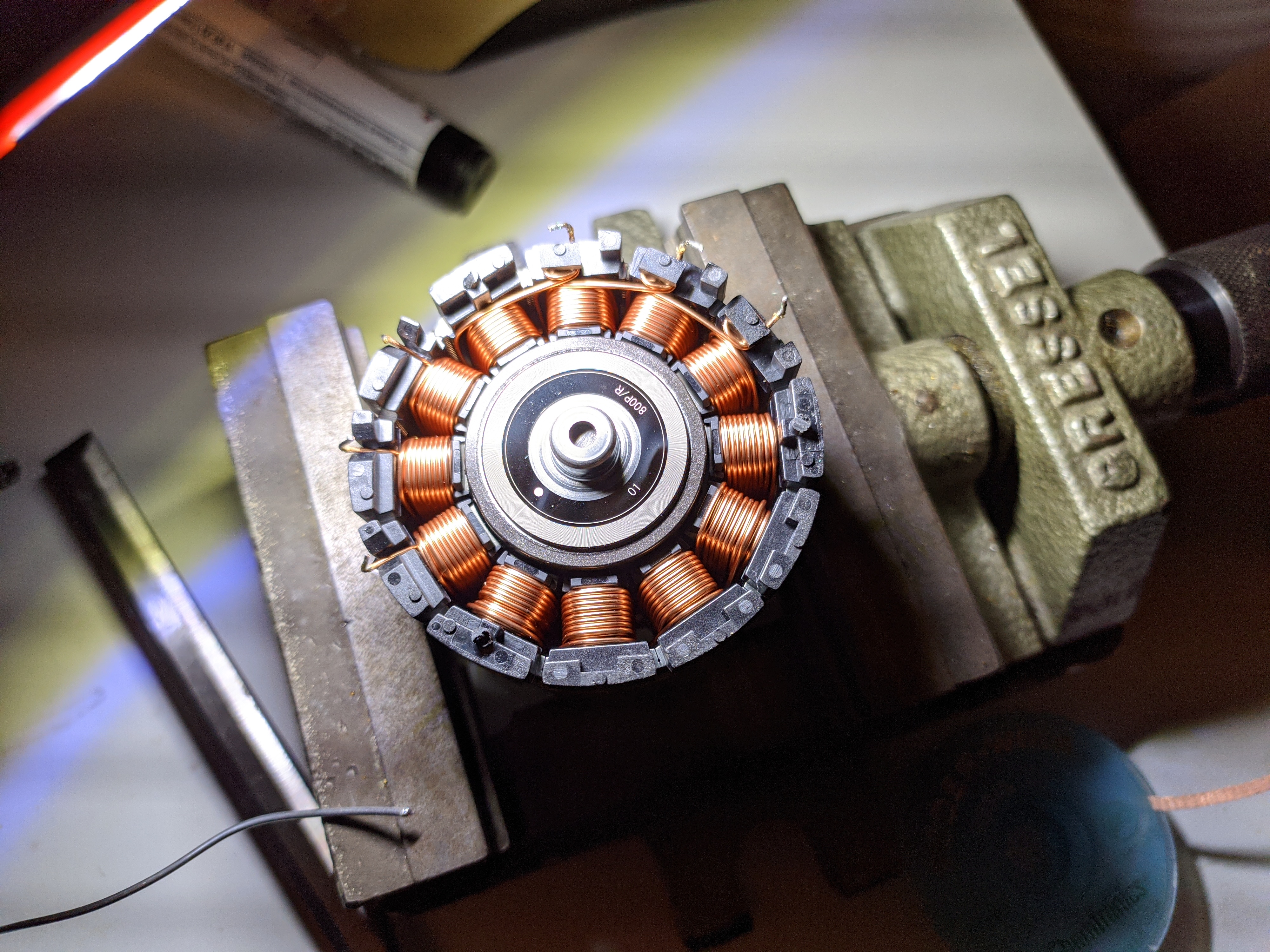

cornholio
Most of these motors fail much too early. I had some failing after 170 h. (They should last 3000h)
I opened one, to see what is causing these issues an found out, it was dirt on the internal encoder disk. I cleaned it and they run ever since.
To open, you need to unsolder the stator coils and remove the PCB
