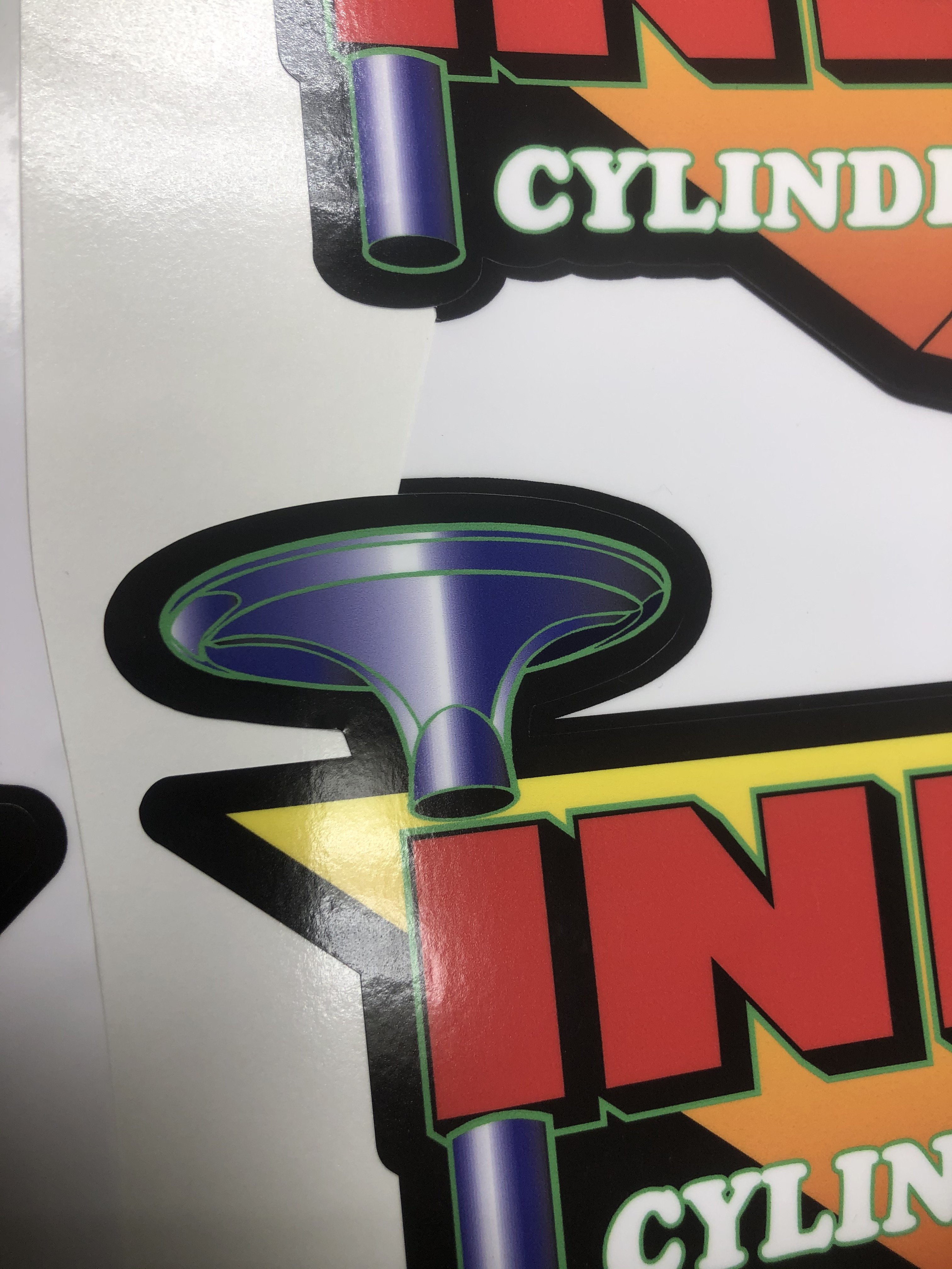

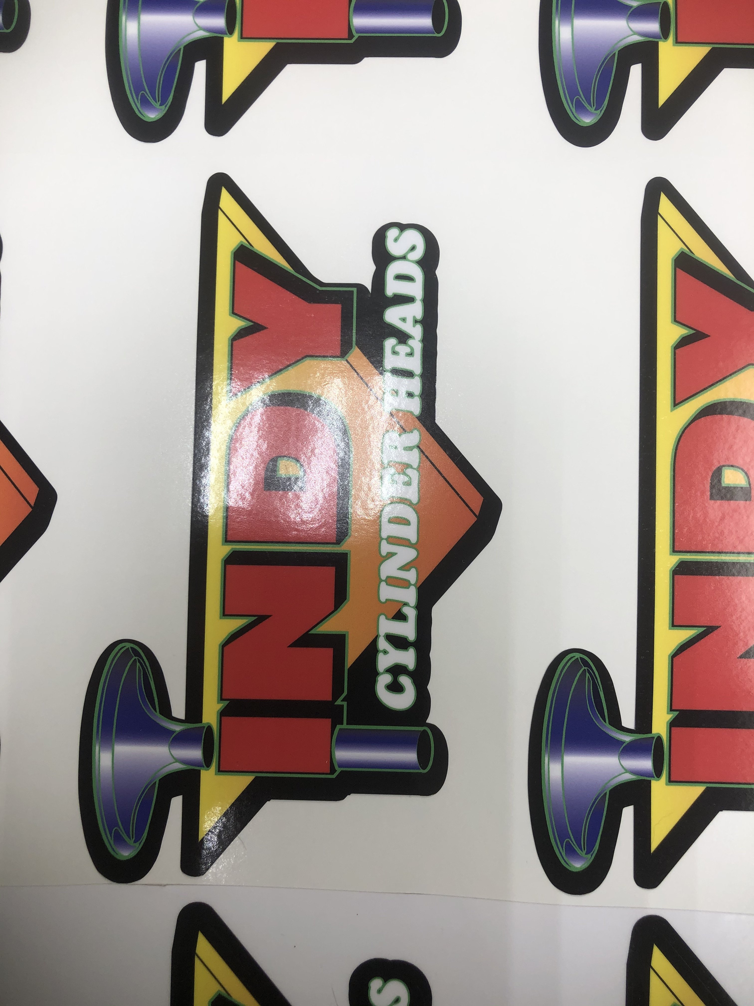

I am having a problem with Roland. I bought a new machine 2 years ago, sg-540, i had so many problems they replaced my original purchase with the same machine (2 new machines at this point) same things started again on the second machine and they upgraded my machine to vg-540i; and now it doesnt work and Roland will not even contact me to give me help. They waited until my warranty ran out and now want me to pay for technical support. What the machine is doing is i am printing and cutting labels 77 at a time in 54x60" of material the print is fine when it goes back to cut after i laminate it wont work correctly. i attached pictures. basically out of 77 i get 10 that i can give my customer.
Question 1 does anyone else have this much trouble with roland?
question 2 can anyone guide me on how to fix this problem?

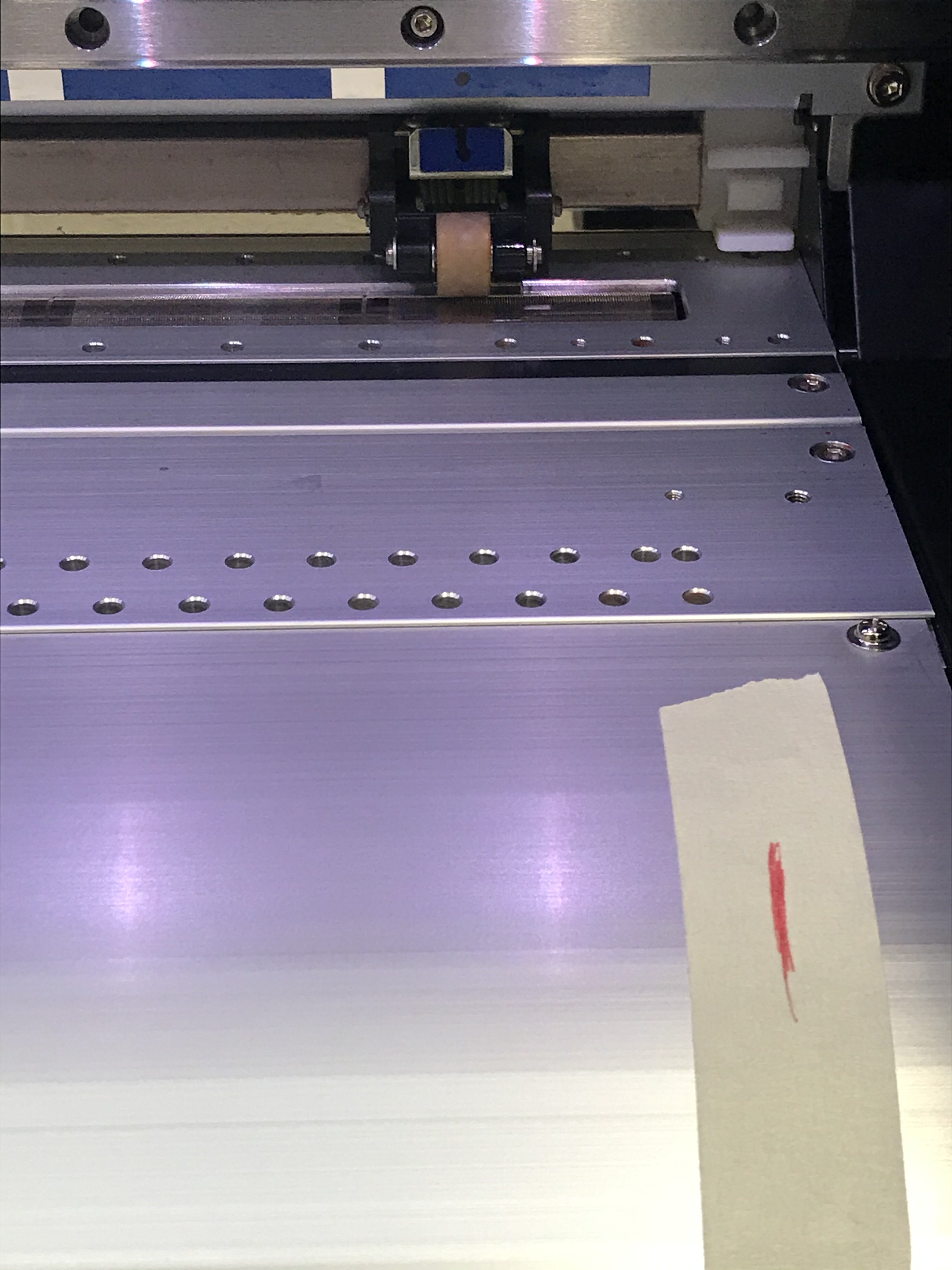

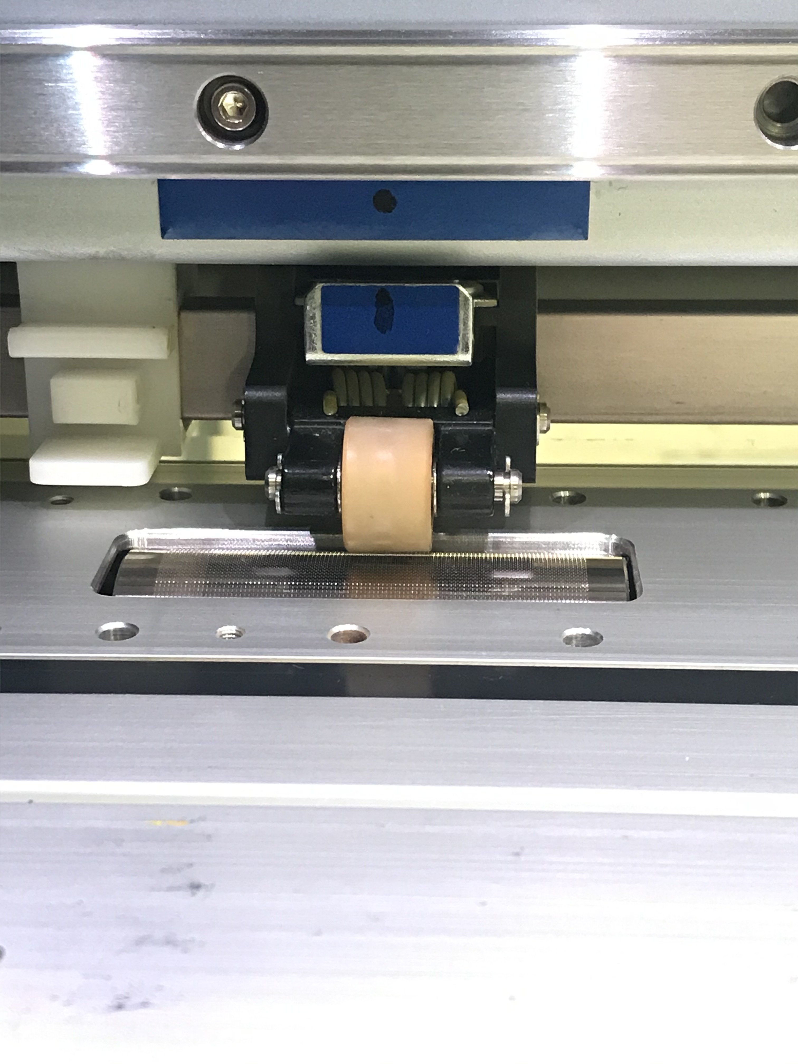

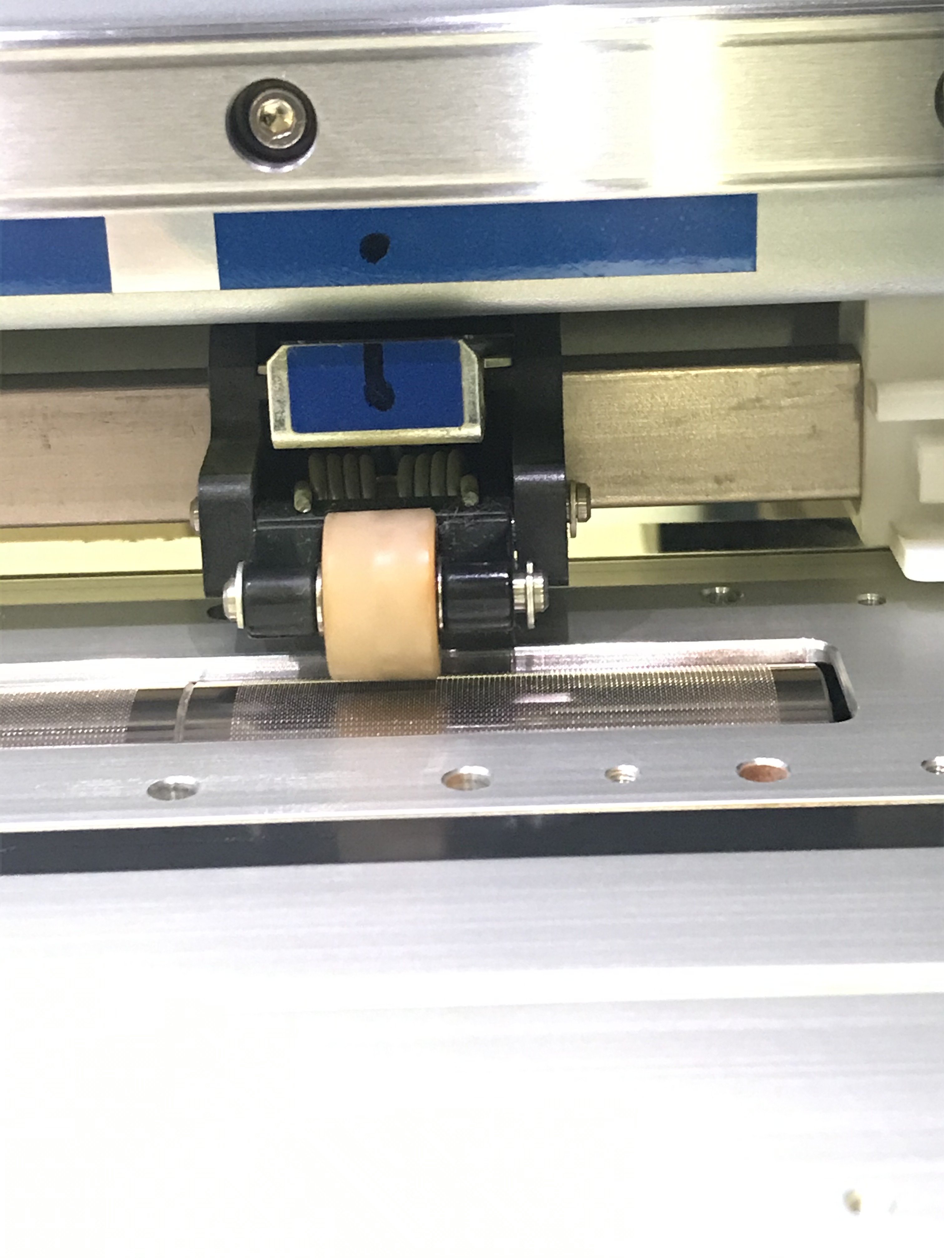

Hi Kristie,
If you haven't tried already....deselect centre on the media, in versaworks, so the print is not centered on the media. I have found that this helps with the print & cut accuracy on my VG540. Also for the print, laminate, cut jobs I tend to try and line the sheet back up as close as possible to where it was when it printed & again, make sure the print is not centered on media. As in the pictures..line up the dots and the red pen mark on the masking tape is the roll edge. This worked really well a few months ago for a job we had to laminate & cut. The roll width in versaworks was around 1297mm + / - . I would also tend to make them shorter runs for the laminate & cut jobs. If you went 54 x 30/36 it might help too. Hope this is of some help.
I forgot to add..when laminating & cutting don't use get media width button in versaworks..input the roll width manually!

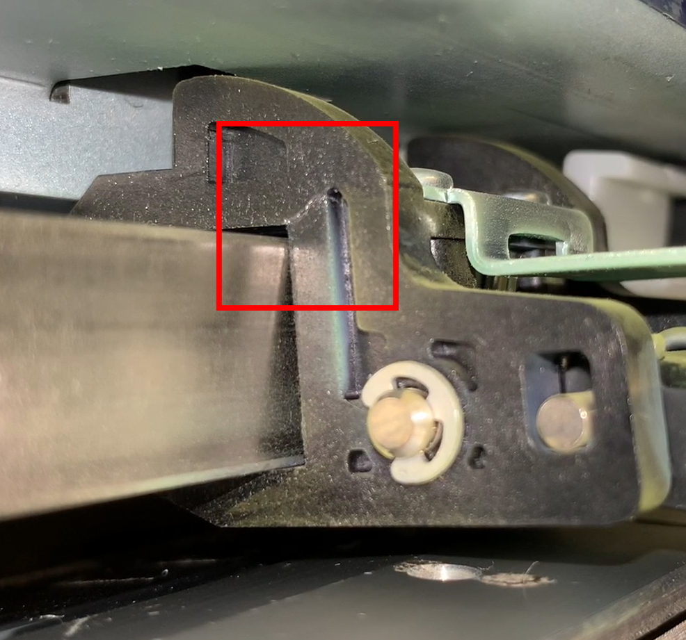

So this looks like an issue I've been running into on my VG-540. I've had two different causes.
One is user error so I'll start with that one. It sounds stupid but check and make sure the thumbscrew on the blade holder is tight. I was having off center cuts for a while and turns out it was slightly loose causing a small amount of play in the holder. I felt like a supreme idiot when I finally figured that out. Just glad I didn't call out our tech on it.
So now for the big one. Our machine is chronically breaking the housing on the pinch roller closest to the capping station. It's a small micro crack that is very hard to see. Our tech just replaced the third one in under two years. It causes drifting during cutting but not during printing. With the cuts looking very similar to yours. We got lucky our eagle eyed tech saw it after she had tried a bunch of other attempts at solutions to no avail. That is the first thing I check when our machine starts to lose accuracy on the cut. I've attached a photo of the crack.
It's not an easy fix as the machine has to be disassembled to replace that roller assembly, but it's just removal of screws so I think as long as you're careful it could be user serviceable. I don't think you have to disconnect any electronics or anything, but I'm not 100% sure on that. I'd expect to spend most of a day on it on your first try though.
When it's not cracked the accuracy is superb.
I'm told there will be no attempt made to address the root cause so I'll just have to deal with the week of downtime every half year or so until I get a new machine eventually. I'm gonna see if we can't get our distributor to stock the roller assembly so that the next time it happens we don't have to wait for the shipment from Roland, but I don't have my hopes up.
