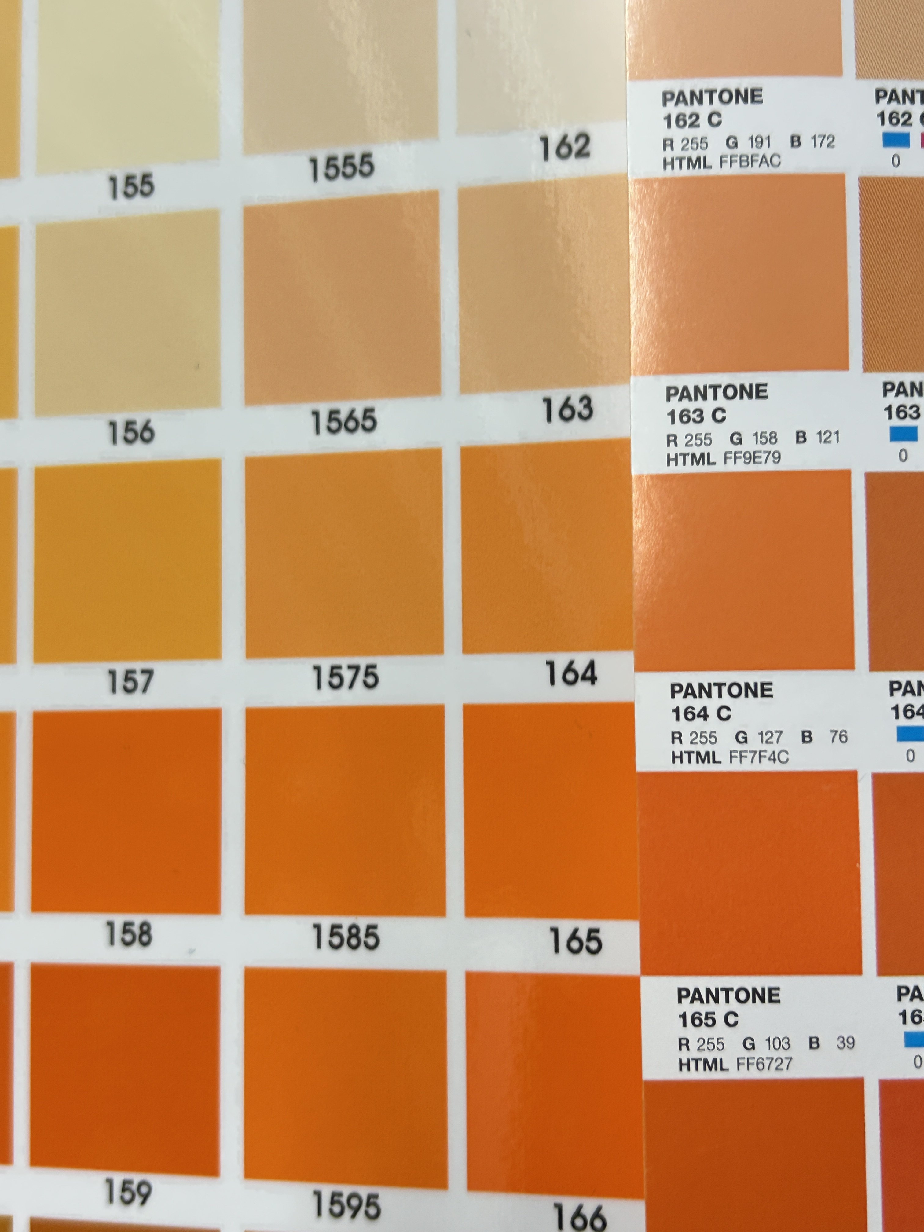

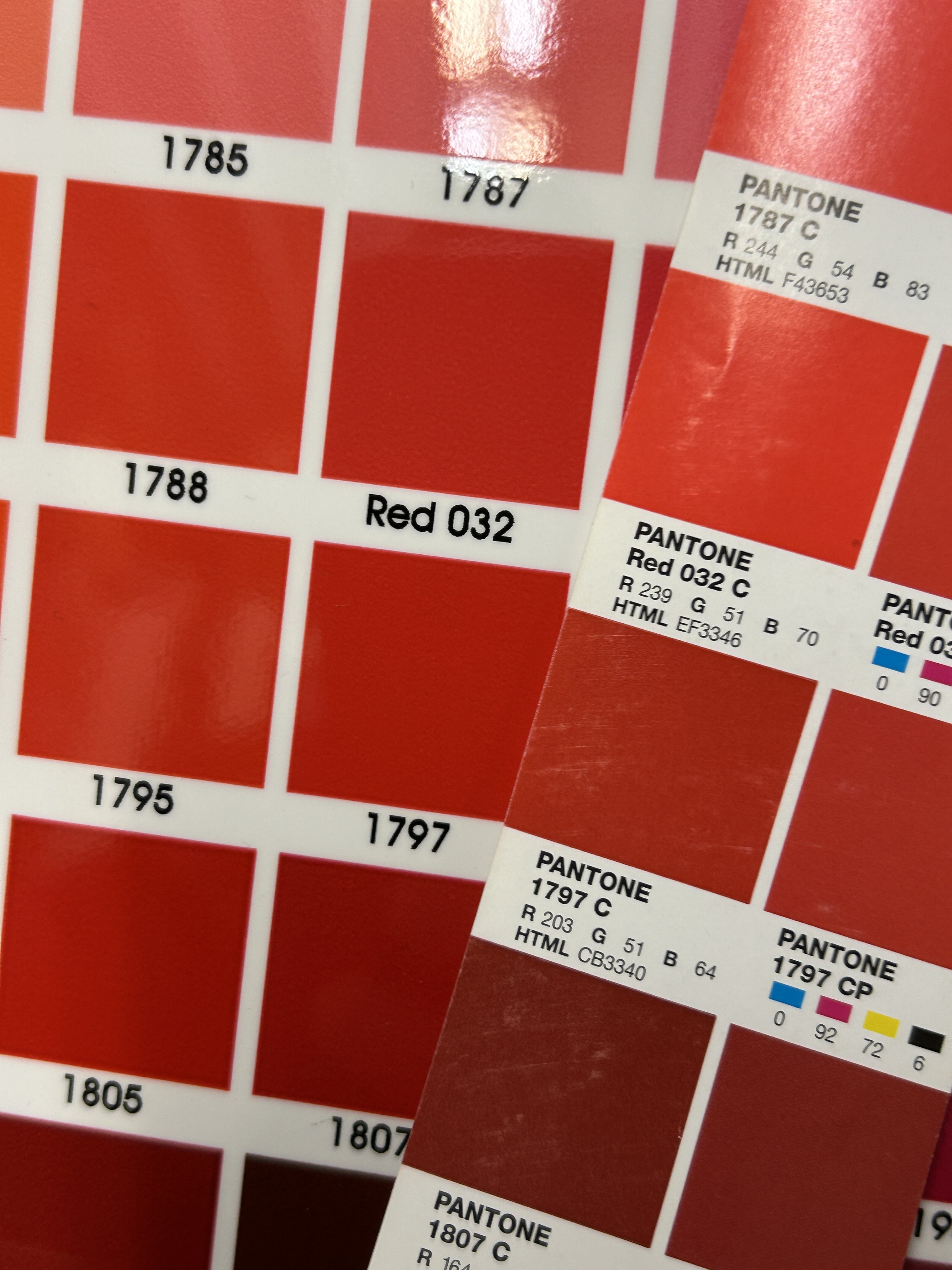

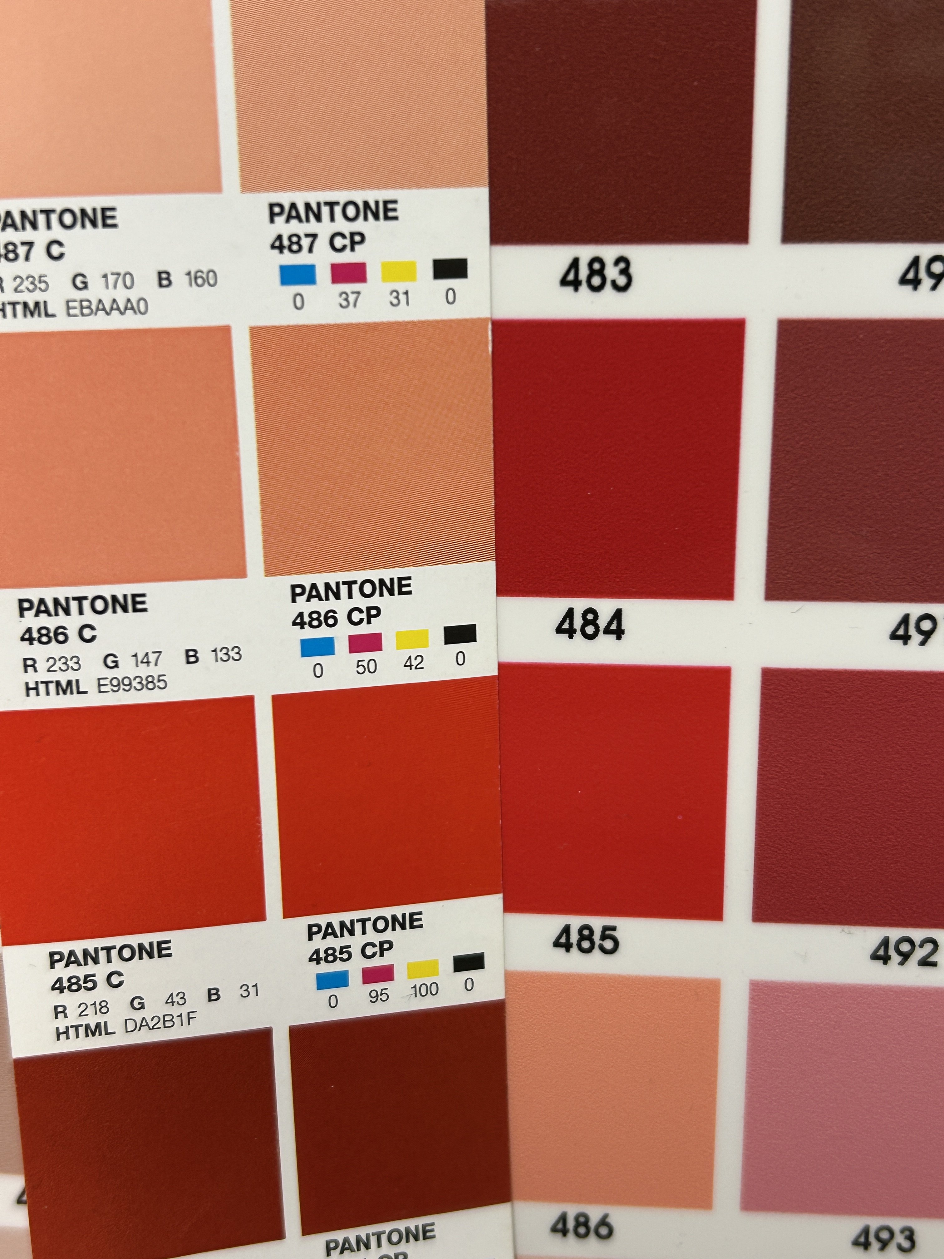

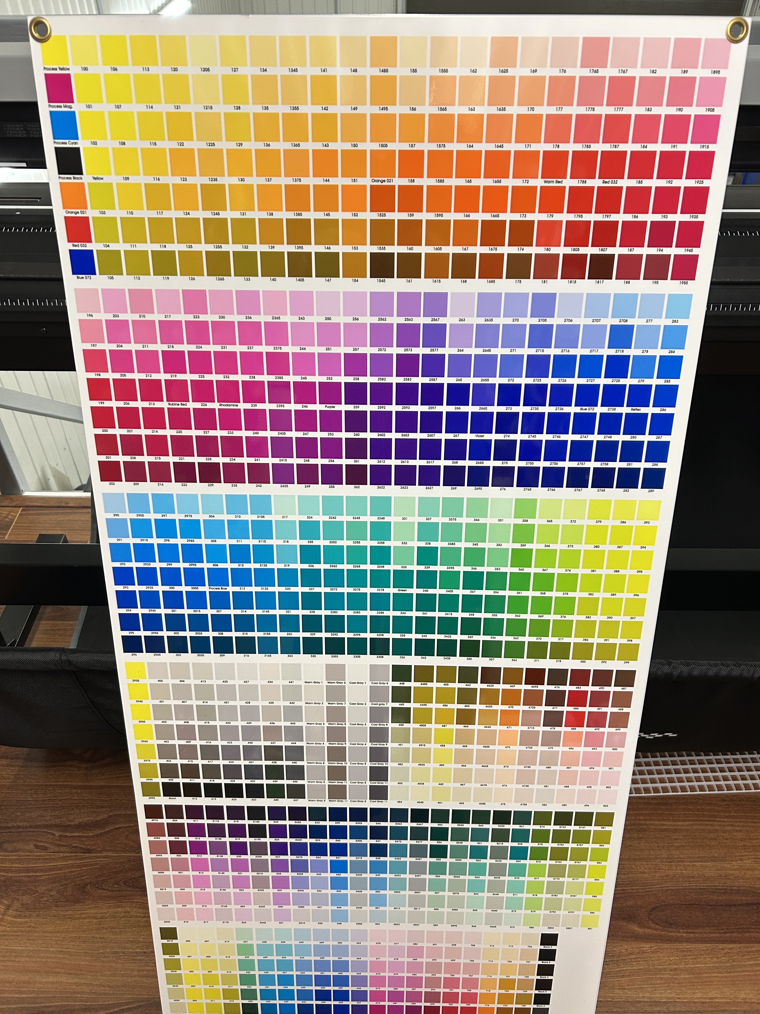

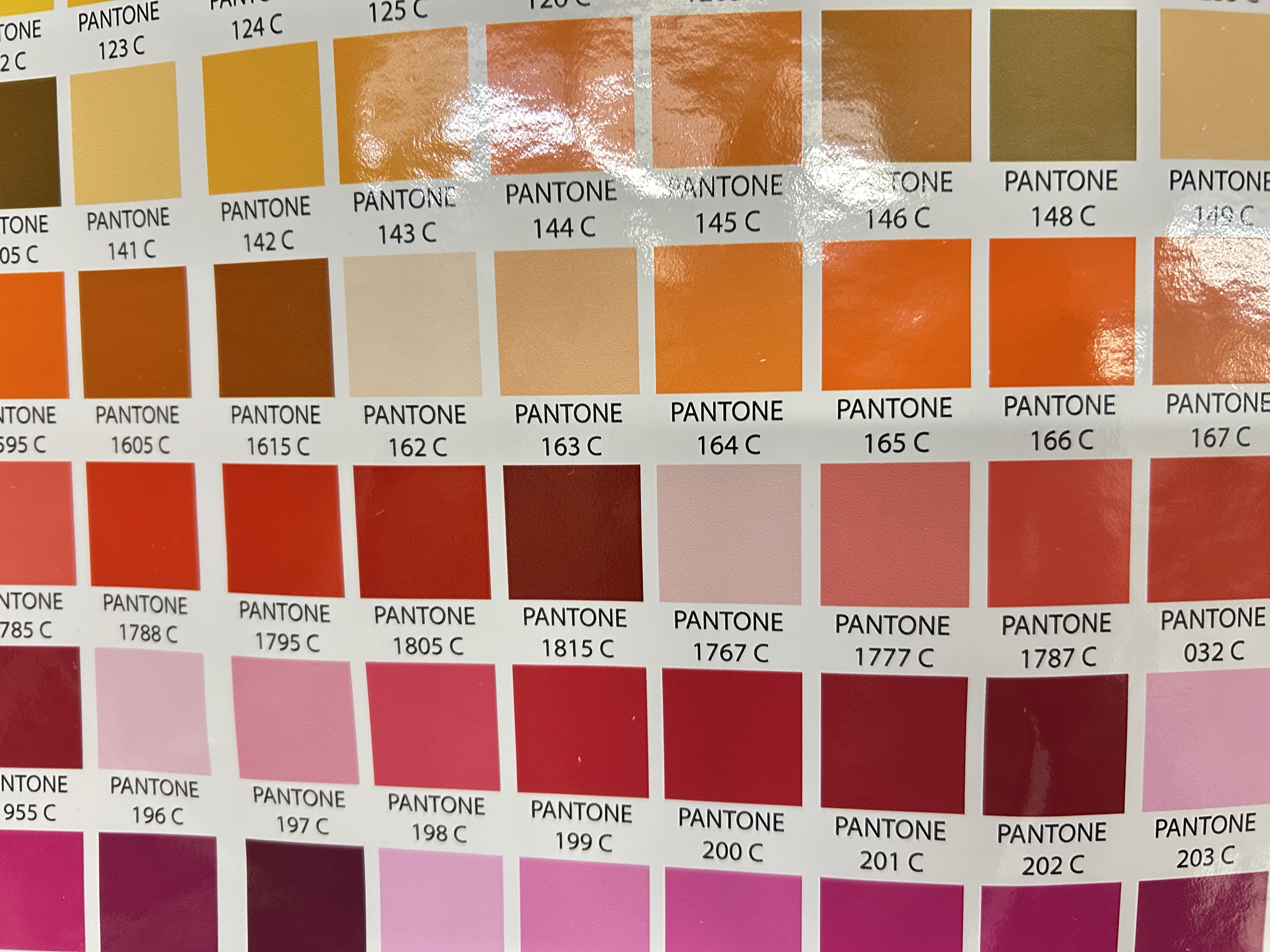

Reason why I love my VG2-540 with OEM inkset, printing with Generic Vinyl1 and True Rich Color2. Using this since the day it has been installed. No banding, nice vivid colors, blacks are BLACK / reds are RED, oranges are ORANGE. Sure there's few tweaking here and there (black 0 0 0 automatically convert to 30 30 30 100 for example), I have the Roland RVW color chart installer in Illustrator and FlexiSign. So far so good.
Patentagosse
Colors are even more "alive" than PMS also due to white point of vinyl vs. stock paper
