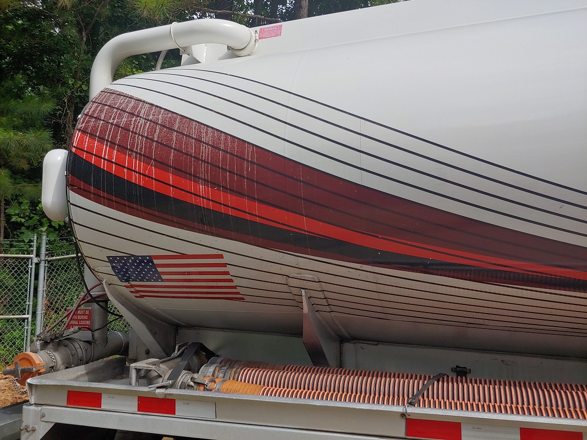

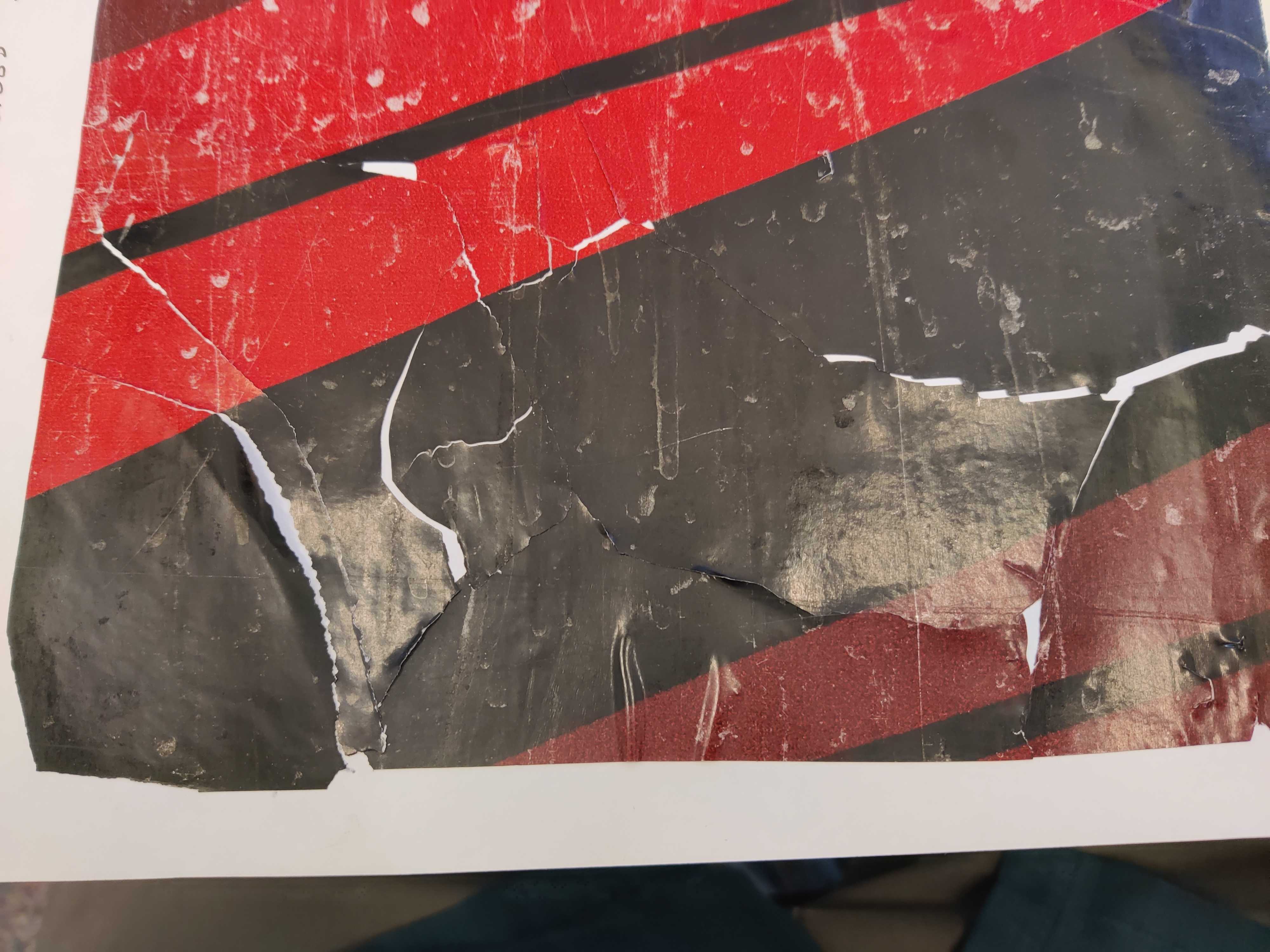

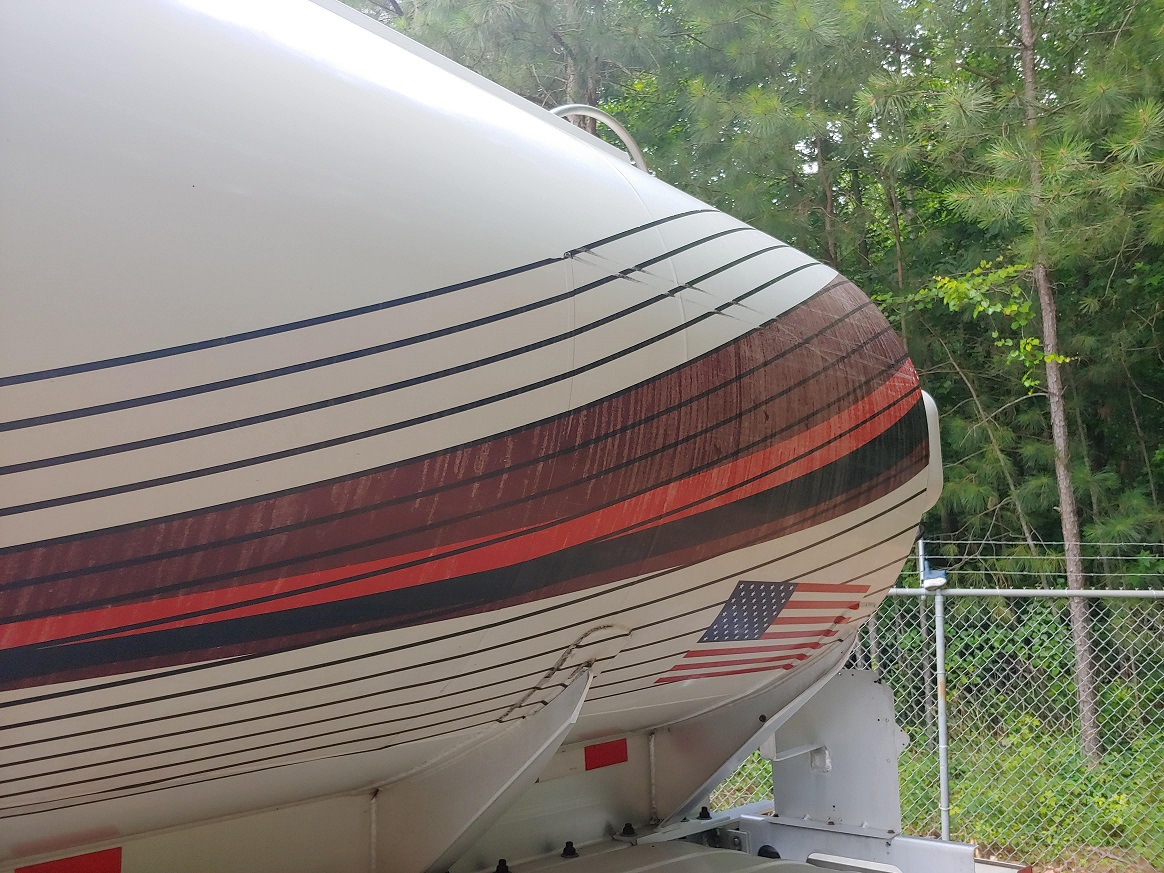

Facts: Vinyl on newer tankers (1-3) years is failing whereas older tankers (3+ years) still look fine.
The installer claims they used the same 3M premium vinyl and laminates they have always used.
The company that cleans and maintains the tankers says they have used the same approved cleaning products and submitted samples to 3M for analysis. They also point out that if the cleaner was the problem then it should be affecting all the tankers and not just the ones most recently wrapped. The cleaning company believes the installer made a mistake and used an inferior vinyl or laminate.
Based on what you see and just read, what do you think?

This looks like it was latex printed and no lamination
the first two images also strengthen the case of lacking lamination with how the "splatter" is running over the graphics

Yeah, looking at the streaks left down the side from it rubbing something, it sure doesn't look laminated. Never seen a print bleed ink before tearing...

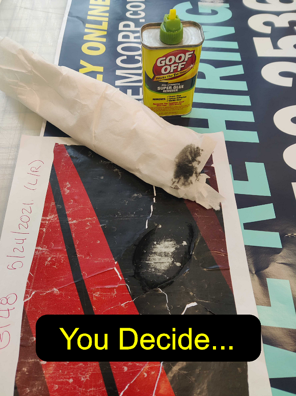

Get some aggressive cleaner, cut a small section off the failed wrap sample that you have, and see if it takes the ink off. If it takes ink, surely there is no laminate.
Edit: Or put a micrometer on it to determine the thickness, look up the material thickness as well as the laminate, see what jives with what.

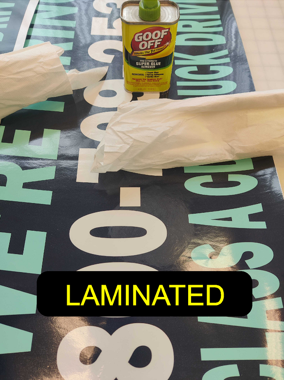

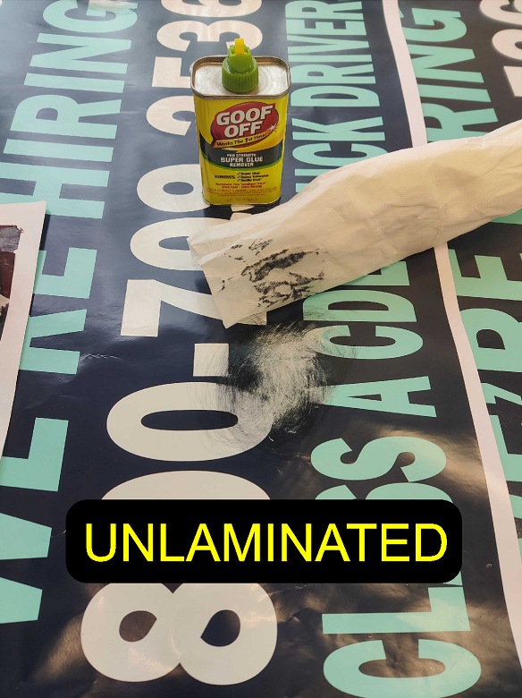

so I did an experiment this morning.
I took two signs and laminated one, the other was only printed using and HP Latex 365 Printer.
Using Goof-off I rubbed the laminated one, you can see it damaged the laminate but did not touch the ink as the rag is clean.
On the one without laminate the Goof-Off lifted the ink right away.
On the sample from the tanker, I again used the Goof-Off and the ink was lifted from the vinyl.
Is there anything I could be missing?

defo looks like it isn't laminated. the runs in the print from chemical cleaning pretty much confirm this. it's on the installer if they ran the prints for this install.
