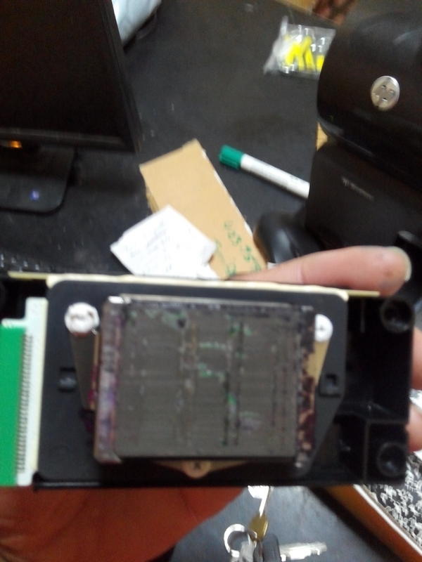

Attached is the printhead for the vj1204. Machine have been sitting down long about 3 years, wondering if i can get it come back? I clean the manifold but cleaning solution is running out of the head but not spraying. Any tips? If need new printhead where is the best place to get it and at a good price?

If it has been sitting for 3 years then there is definitely no way to get the head back. Prices on the DX5 print heads have been going up lately (now close to $3k). I would steer clear of the 3rd party heads. Although I have had great luck with some overall they are a waste of money. Find a local Mutoh distributor and get a price.
