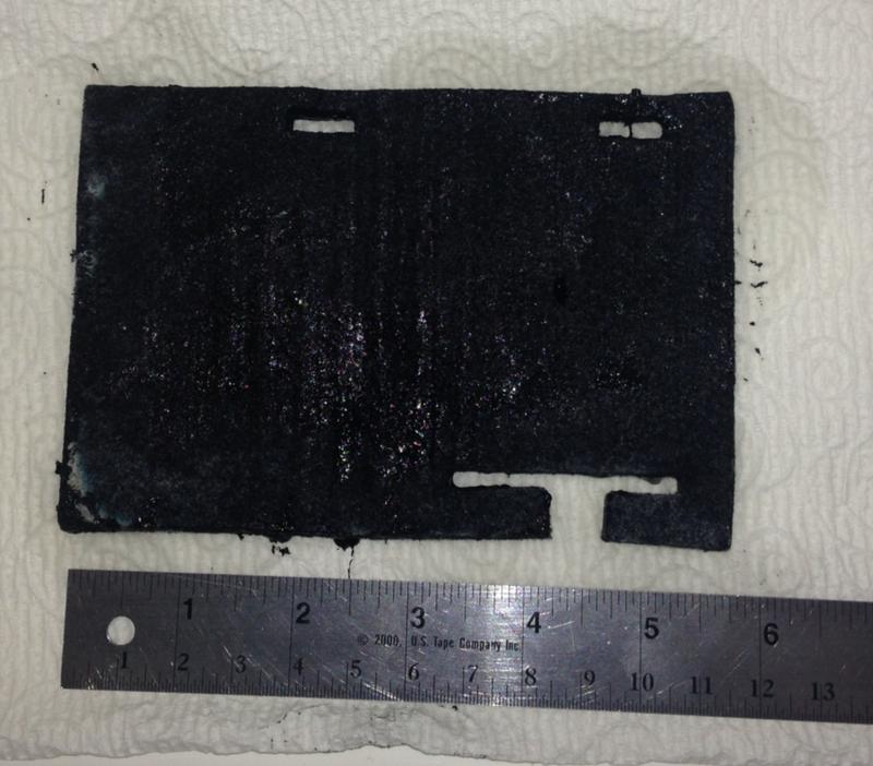

I'm trying to find a source for the absorbent pad in the photo. Fellers has them for the 1204 but I cannot find for the 1614.

Give us a call. I can have one drop shipped to you directly. I'll be honest and say they are way over priced. That sponge is just catching ink that falls from the maintenance station so that it doesn't build up and leak from the printer. You can just as easily use paper towels or any other kind of sponge. The fact that yours is so saturated tells me that you may have a bad maintenance station(leaking badly) or the machine is much older.

I had the maintenance station replaced four months ago. The tech I have here now is from a different company. Just about the entire bottom section was covered in ink. He said that two screws were missing from securing the maintenance assembly. Basically most of the waste ink was not draining. I may be giving you a call. Thank you very much for the information.
