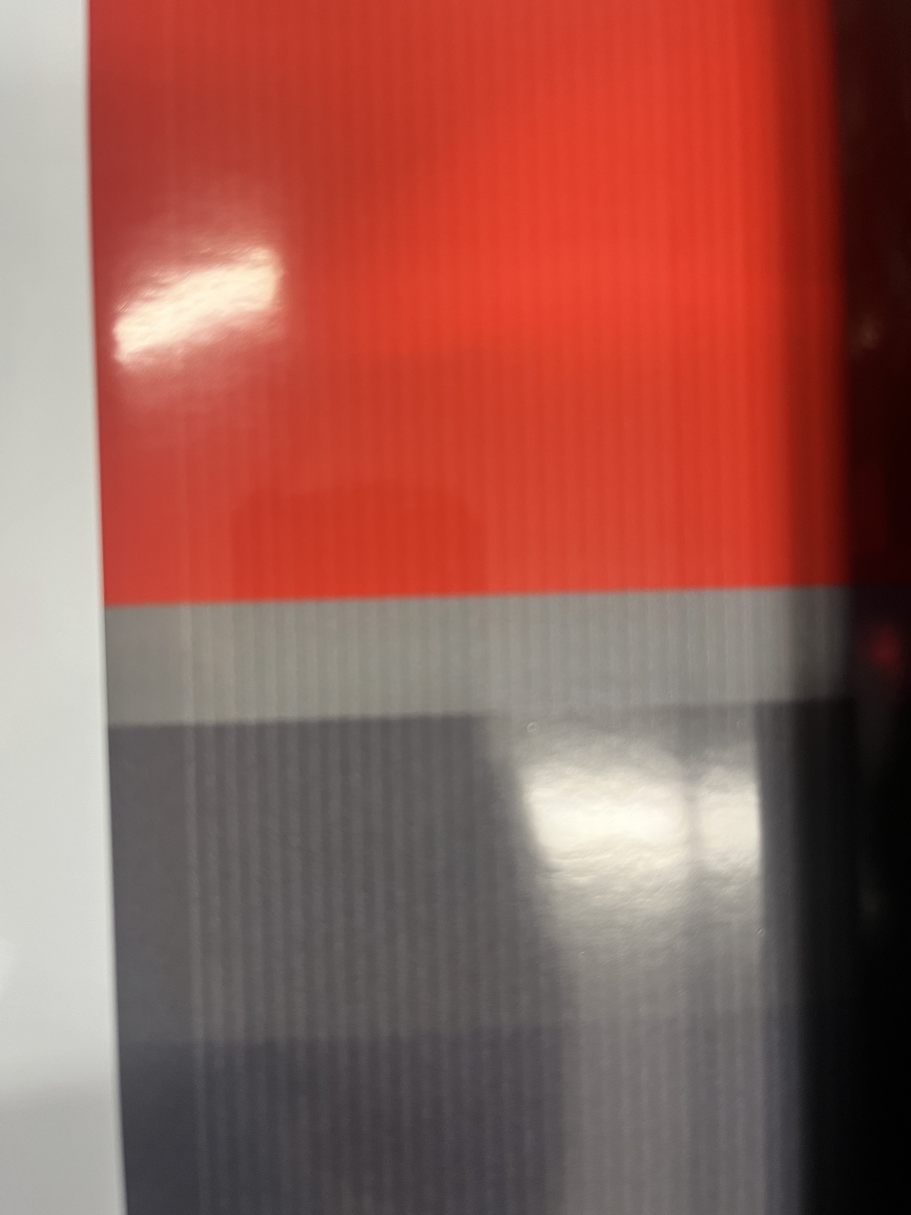

Every print starts out good for the first half inch, then it starts banding. Just started in the middle of a print job. Double checked pf feed and replaced dampeners and still doing it. Anyone ever have this issue or a remedy for it?
102RCR
Update: switched to different User Type checked PF Feed and adjusted it. Now its printing fine again.
