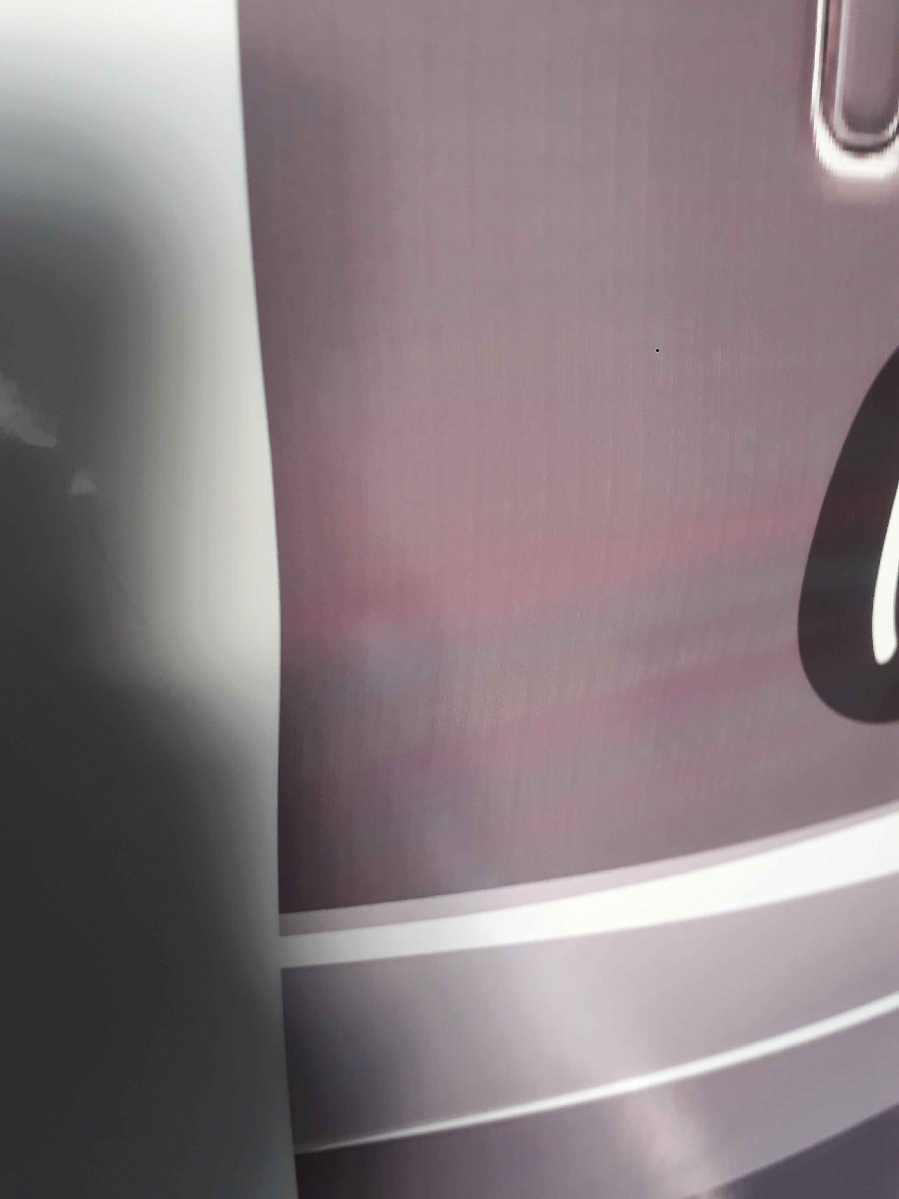

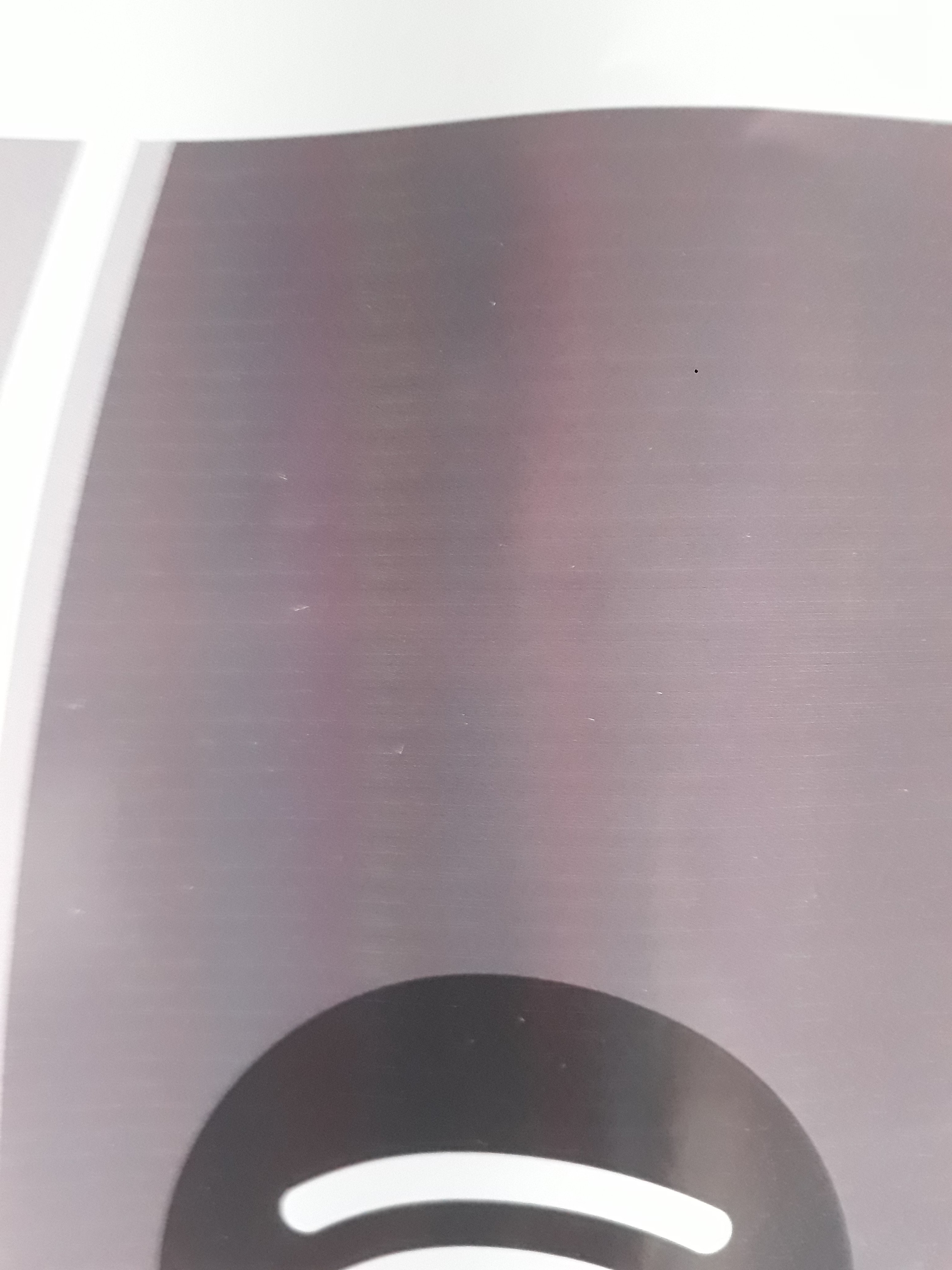

HI Okay i will test it, i was printing a job and this is how it came out with like different colours in lines. Can this be the heaters at a high temperature?
