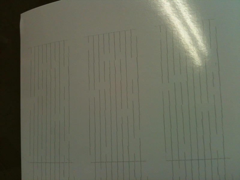

3 years old, used a couple times a week or so.
I'm missing 10-12 nozzles, all on the black side. I have cleaned the whizz out of it with the "strong" cleanings, and also soaked the head on the cloth saturated with solution. No love. Same thing. The missing heads will occasionally "move" one space or so between test prints, but that's it. I have had the maintenance station out and cleaned all the hoses out (the nozzle up on top was clogged), and the cap gasket looks good to me.
Are there any other tricks that I should try before thinking the worst? The closest service folks I have found are about a $500 service call away, so I hope I can resolve the issue somehow...and without replacing the head!

It is a few more than 10-12. It bands pretty badly when we do black, gray, and darker colors...

My best guess is that your maintenance station is due for replacement. If you haven't done it since new then I guarantee it is due.
I've discovered that typically when you get missing nozzles on either the black channels or the magenta channels it is due to the head not sitting squarely on the rubber seal and/or the seal is not good anymore. If you get a flashlight, you may be able to see if the rubber gasket is seating properly. If there is any gap that should be your clue.
Also, without a good tight seal your pump may not be pulling strongly enough to suck out the plugs in those nozzles.
