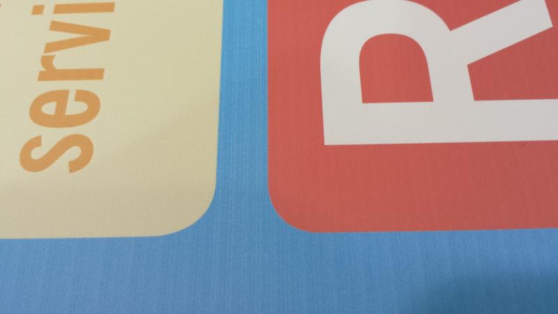

I have an issue with banding. Done the usual cleaning etc. I had a couple of missing nozzles on the cyan which came back but only have a couple of missing ones on the black which have been gone for a while now and in the past have not made any noticeable difference to the print quality. The banding is obviously much more noticeable when using lower heater temperatures but still there on higher temp profiles. I have also done an alignment print which was ok.
I replaced the maintenance station about 12 months ago and the head is at least 2 years old. I have also attached a pic of some printing we just did on a lower temp paper profile.

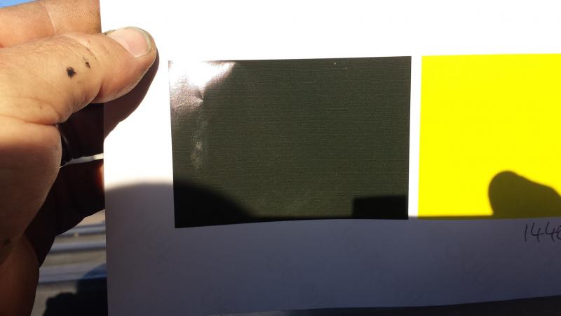

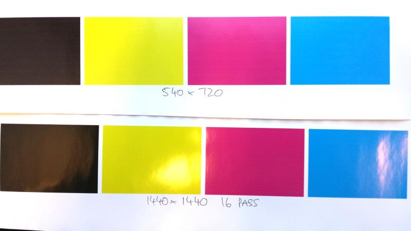

Post a test print please?
Also a print of solid Cyan, Magenta, Yellow and Black in low quality and high quality.
SC
bsm

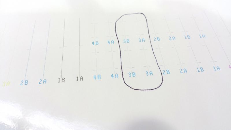

hey SC, attached low and high quality, bit hard to see from the pics though so attached just the black high quality as well. also attached a pic from the head alignment print, 3A & 3B arent printing at all. cheers Brad.

bsm
forget the head alignment print, the 3A & 3B are yellow, I reckon that would be why I cant see them.

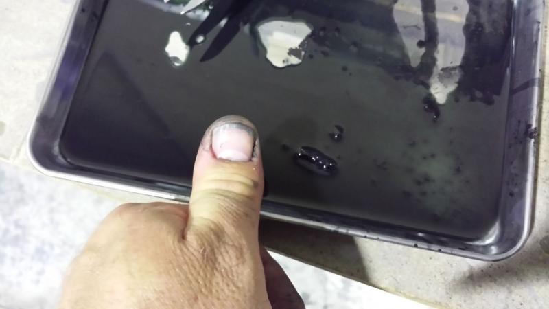

bsm
problem may be solved
one of the drain lines from the pump had a bit of sludge clogging it. syringed some cleaning fluid up and down through the pump until it finally got sucked out. Pic attached. will post after some printing with results.

did all that to start with. I think it might be a pump problem. no ink draining out when doing a clean. If I put fluid in the top of cap it drains through ok. would explain the banding I guess.

Just in case anyone looks at this trying to find an answer to a similar problem.
I turn the machine off at night which has never caused any issues but what I had never done was regularly flush the ink lines through the pump. Sludge had gradually built up in one of the lines and when I managed to clear it it did start to get better. After about 20m of printing and cleaning the line cleared right up and hey presto. Printing great again.
