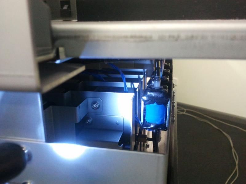

bsm
Sean,
I have attached a pic of the 2 way valve. No. 2 is not clicking when I do a valve exercise. I can jiggle the connection and valve and get it to work but as soon as the machine sleeps or is turned off the valve doesnt work again.
If I need to replace this, anyone know where I can get just the one valve?
